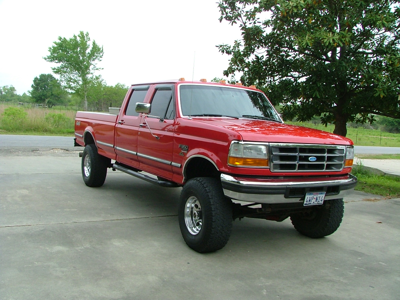

Many posts on TBN and elsewhere on the net about the reliability of diesels and current pricing led me to check out Craig's list. Good that I did. I found the following:
1997 Ford CC F350 XLT Dually 7.3L Powerstroke Diesel w/5speed std. trans, lots of power and COLD A/C. Shows 324xxx on the odo but does not show or run like it. I change the oil every 3500 miles and the previous owner did same. Pwr Windows and Door Locks, Pwr Lumbar, Tinted Windows, Recent New Windshield, New Tires, Cold Air Intake, Large Free-flowing Exhaust, Recent Front Pads, Rotors and Wheelbearings, New Shocks, Pioneer CD MP3 Player w/ Aux In for Ipod etc, Bed Liner, Gooseneck Hitch, New Aluminum Tool Box, New Aluminum Bed Rails and Tailgate Protector, Chrome Drop Bumper, Bug Deflector, Interior is in excellent condition, 90 Gallon Diesel Transfer Tank w/ Electric Pump. This truck is in excellent condition: $5000 cash.
AND, it was about 1 mile away! I drove it and had my mechanic look it over. This truck had been babied and in nearly perfect cosmetic shape. Absolutely no findable mechanical concerns. Huge numbers of you TBN folks claim that the Navistar 7.3 has extreme reliability... never having owned a diesel, I hope so, and you better be right... because:
I bought it:)
The final straw was the 90 gal diesel transfer tank.. which I actually need so I can easily obtain and transport off road diesel for my tractor. You knew that somehow this whole story had a tractor connection, didn't you:D
So, now, I can fuel my tractor, tow whenever I need to, few truck hauls will keep truck fuel costs down and at a buy in price I can live with.
Hope this ramble is useful to someone.... clearly, it is not intended to cause animated discussion of diesel vs gas, or 1/2 ton vs a real truck, but to explain my decision path... your path may differ:eek:

I love my Tundra, but would take that deal in a heartbeat - sounds perfect for you
   / Tundra vs F350: how I made my choice #4
I thought I made a good deal with my 97 F350 Standard Cab 4x4 5Spd Gasser at $2500. It's rough around the edges but otherwise solid. Your find looks awesome!
Yup the big truck market is pretty good these days.

That price ALONE is a deal maker. But your reasoning is very sound. The goodies on your "new" truck are very, very nice.
Impressed.
Unfortunate that your post kind of implies a bad time out there for sellers of big trucks.
No way that would go for that price if the economy was better........

Not a bad find. Lots of miles though.
Check out the Ford truck forums to get the latest scoop on keeping that 7.3 running smoothly. If I recall correctly, some of the annoying little things like the cam position sensor (very easy fix) shuts them down, they are prone to coolant cavitation, so change the coolant out and use the Ford specific coolant additve, the power is greater than the U joints can handle so they frequently scream, and the fuel tank switch for dual tanks can get hung up between tanks.
They are very sensitive to poor quality fuel, so treating it and changing the fuel filter often is recommended. My father had a 95 PS dump that was really a great truck.
   / Tundra vs F350: how I made my choice #8
Got a 96 PSD 4x4 long bed crew cab I'll probably keep forever...around 171k and it's been a great truck. Have had cam sensor glitches, never killed the truck but made it skip, easily fixed and now cam sensors are like $20 when they originally were $100:eek: Get one and keep it in your truck, takes 5 minutes to change and could save your bacon someday. Ahead of time- make sure you can get the 10mm head bolt loose that holds it in, they are usually very tight, odds are someone has already been there with your mileage though.
Coolant maintenance is critical, but you don't have to or need to use the Ford specific stuff, I use the FleetCharge pre-charged coolant in mine, buy it at TSC. I've never had U-joint problems and you probably won't either unless the truck is chipped up for lots more power. So far no fuel selector valve troubles. Make sure to drain your water seperator every few months even if you have no signs of water, some high mileage guys have found the very expensive aluminum fuel canister corroded out from water sitting in it too long.
171K and I've put an alternator, water pump, vacuum pump and fuel pump on it. Motor uses zero oil. I did have my trans rebuilt at 109k, was having no trouble but was gonna be in Arkansas so I had the famous trans builder Brian's Truck Shop do me one up- $3500 but I expect to NEVER have trans problems the way he builds them.:D
