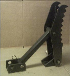

I'm working on a design similar to this one:

I like the base mount it looks easier to build than the ones ive seen.Are you gonna weld yours on?
ALAN

RADAIR,
With the one in your pic ,you would have to remove the support bar to fold it up correct?
