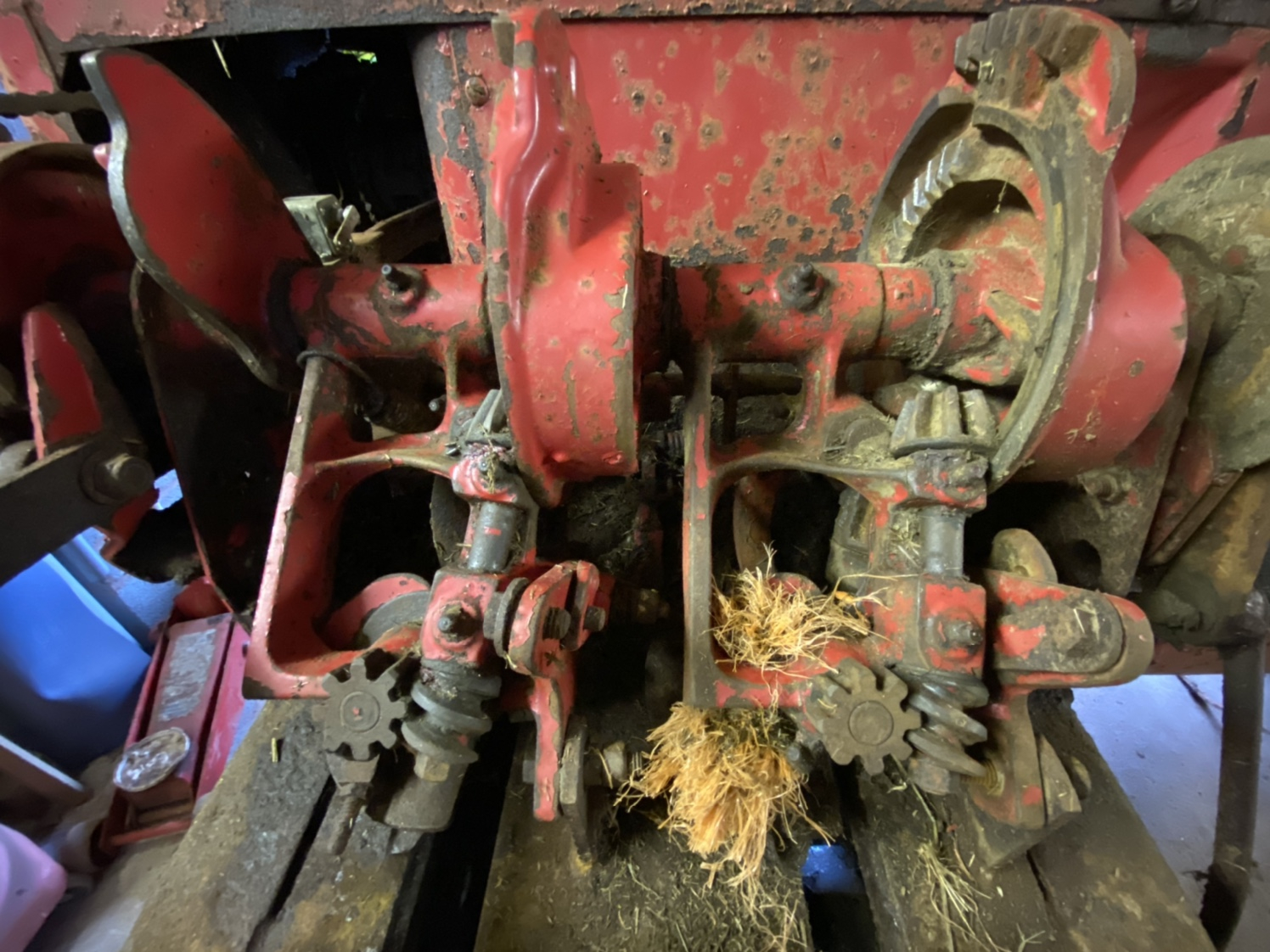

Hi all. Am running an old New Holland 68 Super Hayliner. Last year when I got it, it was only tying on one side so I sharpened the knives and seems to have solved the problem and it’s tying fine now. Before starting this year I re sharpened the knives. Only thing I’ve noticed is this year I’ve done a few hundred bales so far and it’s still tying ok but the short lengths of twine seem to be bunching up around the knotter on one side, which hopefully can be seen on picture. Wondered if anyone had any advice how to stop this happening. Any advice much appreciated!

Had and used a NH66 (older than yours) and it did bunch up a few at times, but ran fairly clean for the most part. If everything is right, the short cutoff's should be laying on top of the bale around the finished knott area.
Have someone walk along the baler and watch when it ties and get an idea what is happening.
Kinda looks like the twine knife may not be quite adjusted right.
Also check your twine holders for action, are they loose/worn/have the right shape to them? The holders can get grooves worn in them too.
check under the holder casting to see if there is a burr on it, that will also cause problems. Completely clean the area and the shaft to start with and watch the first few bales! I think you can narrow down the cause. These were picky balers but in their time were top of the line.

might try a dab of leather boot wax on the eye, sounds like it just needs a good buffing.

Make sure the billhook is smooth. A bit of rust can make it erratic by wearing on the twine.

Is everything greased and moving freely as it should?

Twine knives need to be razor sharp. An option is to buy knife kits which come with new hardware and replace the knives to bring a factory edge to the party. You grind the old rivets off the knife arms and bolt the new knives on. Make sure the knife arms sweep the billhooks with the proper tension and the distance between the billhook and arm is closer to 3/8" than 1/2" at the end of the knife arm travel. Info is in the op manual.

Well ... For one issue, both the knotters are bolted tight. They're supposed to be pinned with a loose pin (Rivet) and R clip to allow them to float. Might be the reason the left worm drive is worn by the knotter cam gear.
As for the twine build up. Check the twine disk timing. You will need a manual since all of the knotter timing is inter-related.
When were the knotters last greased ? Some of the points look dry to me.
