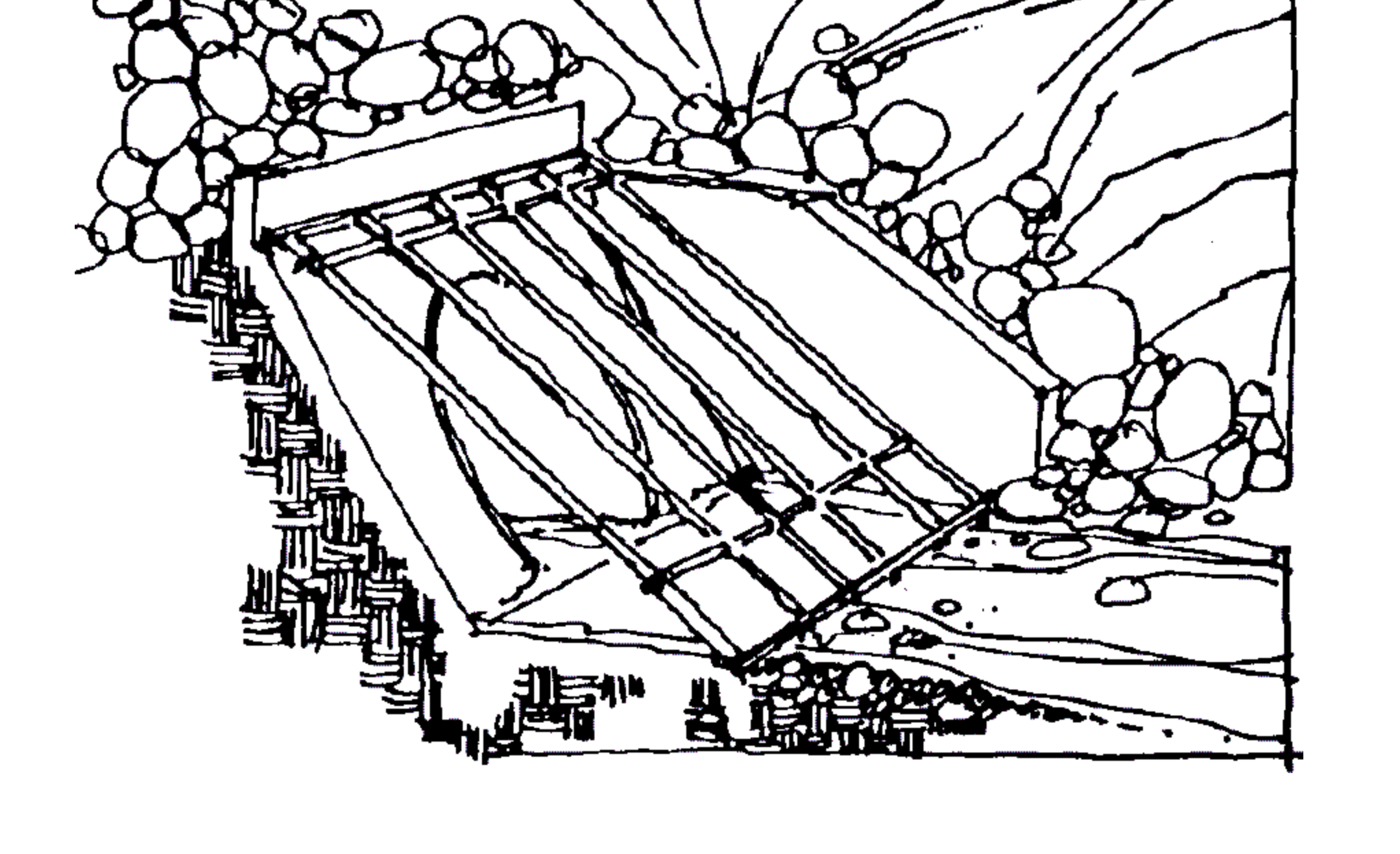

We designed several low water crossings of roughly the same size you are doing. The smallest one started with two 4' culverts and ended up using three 5 foot diameter culverts each 20 feet long. The idea behind a low water crossing is that water and debris will be deflected over the top during floods. So it's typical to use tapered aprons and heavy steel trash deflectors on the upsteam side ...on the inlets to the culverts. I'll add a picture.
When they work as they are supposed to, it doesn't really matter how much flow goes through the pipes, because it will not be sufficient to carry all the water. You are not going to be able to cross it when the water is up anyway. What you want to do is flow enough through the culverts to reduce the size of the lake which is forming upstream, while allowing the bulk of the flow to run unimpeded over the top of the low water crossing. When the water goes down, with luck your crossing has survived and will reappear.
The culverts themselves can be set in concrete or more commonly in stone with heavy riprap around the entrances. Concrete covering several layers of chain link fencing is one way to smooth the approach. Alternately, we use as many 3'x3' boulders on the upstream side as we can find - and larger ones for the outer banks. Anything much smaller is a waste of time. It's handy to have an excavator with a thumb for placing the rip rap. Also think about connecting the culverts to each other with heavy chain wrapped around them.
Yes, sometimes they do wash away. So do the best highway bridges, underpasses, and even that old standby: the multiple box culvert.

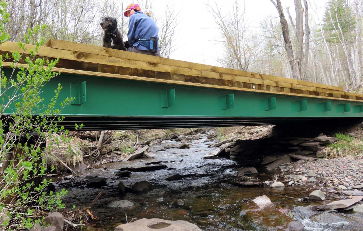

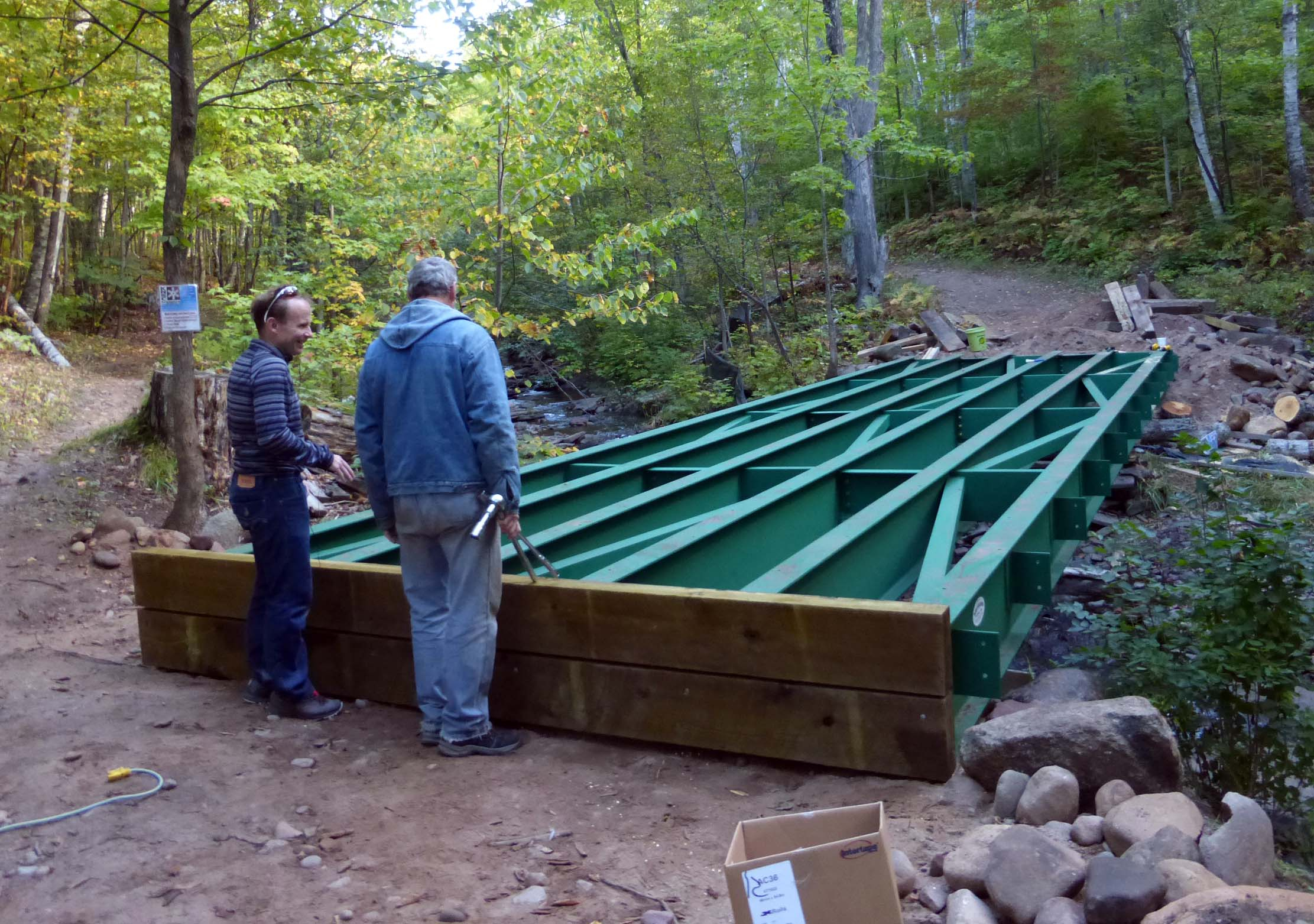

Large diameter culverts are expensive. Moving and setting 3ft boulders isn’t cheap either. It seems to me like setting a railroad car bridge would be cheaper.
   / UPDATE on DIY bridge (long post) #9
Flatcar Bridges | Rick Franklin Corporation This guy has been working with the railroads since the seventies, rebuilding track when they have derailments. He salvages all kinds of material including flat cars and box cars. These decks make real good bridges. Put one down and be done with it.
