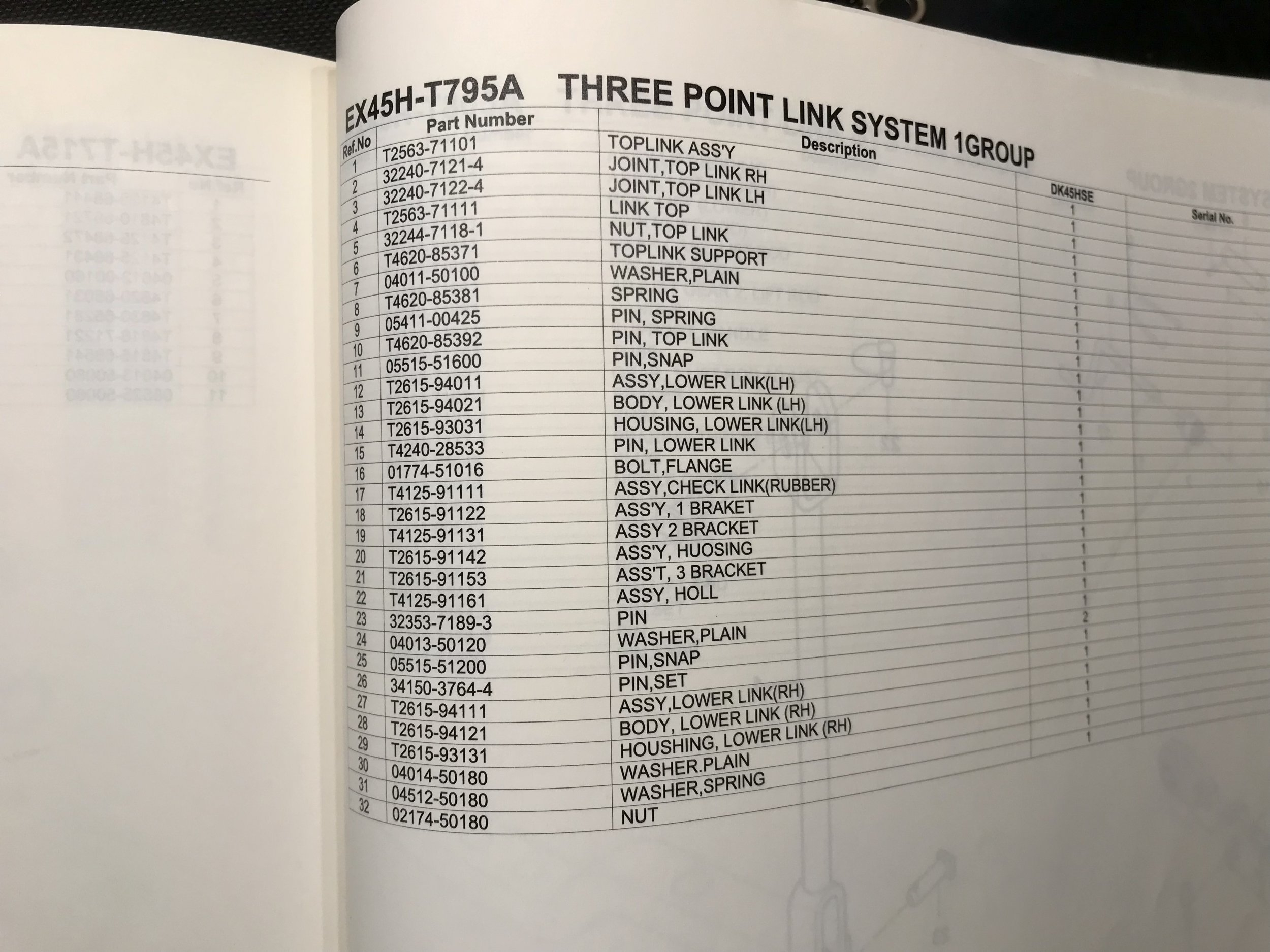

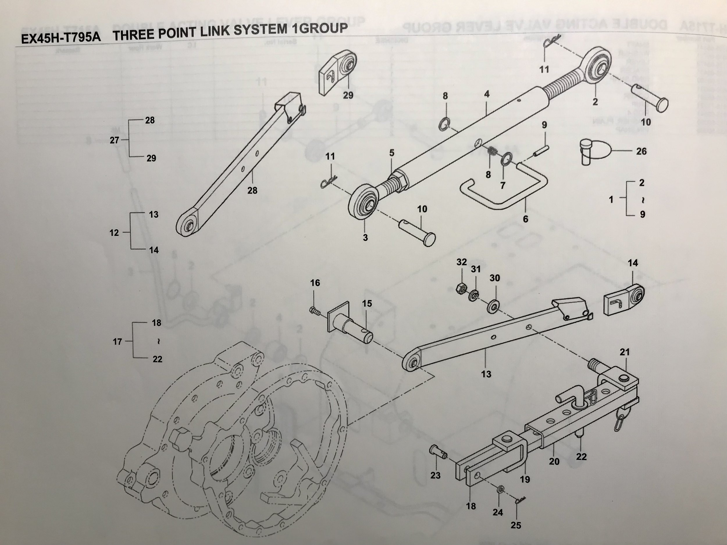

Weird…i cant find anything on michiganiron site for the 6010.
here are part numbers for my DK45. Maybe you can see if they will work on your model.

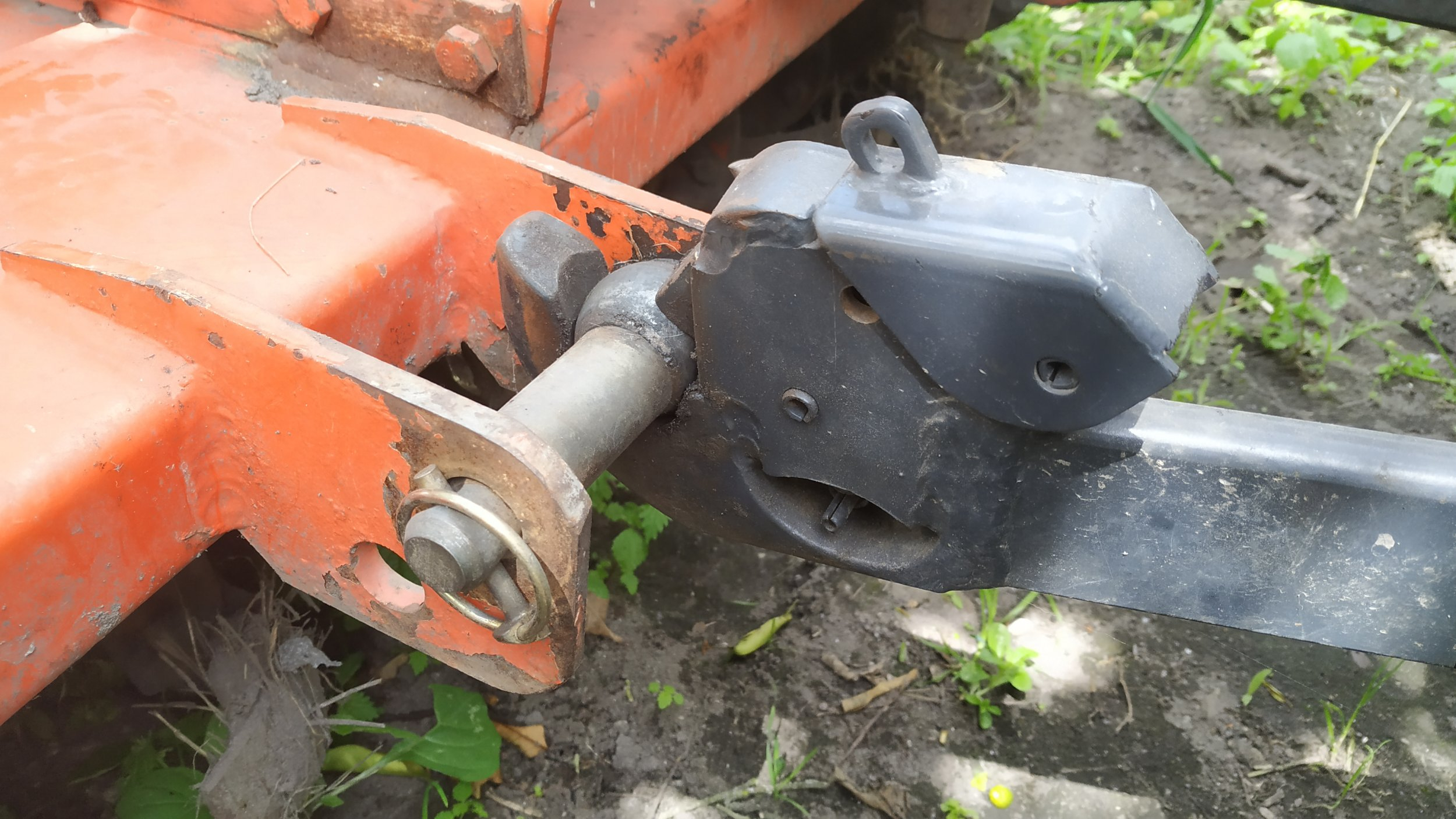

Maybe go with Euro draft link hook ends. Probably less $$$ than the extendable end parts. You would have a built in quick hitch. :cool:
Hmm. Interesting. I need to look into this. Are they universal?
   / Upgrade Kioti DK6010SE 3-point Hitch #9
My tractor came standard with it but you'll need to weld the hook ends to the draft arms but it's totally worth it.
