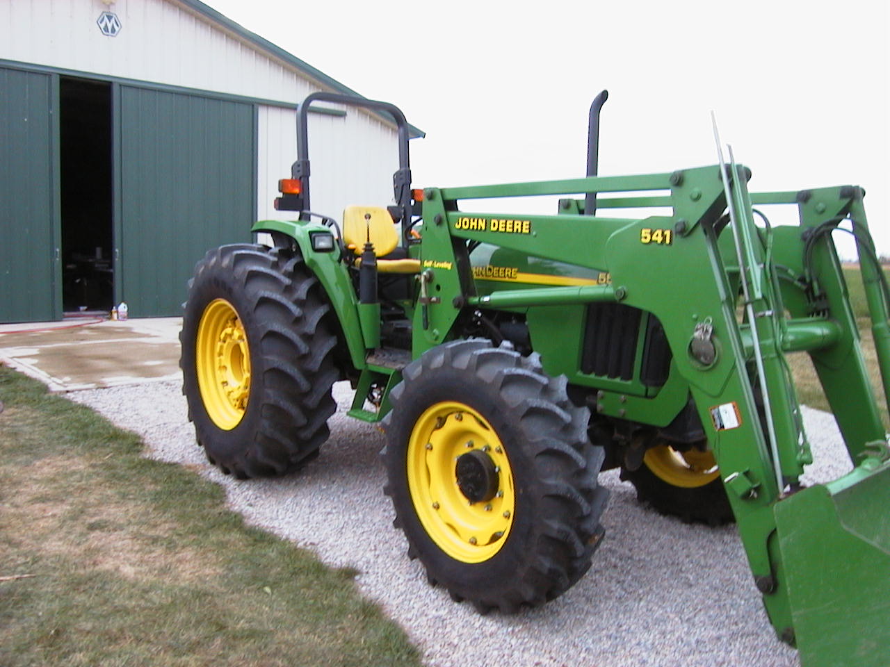

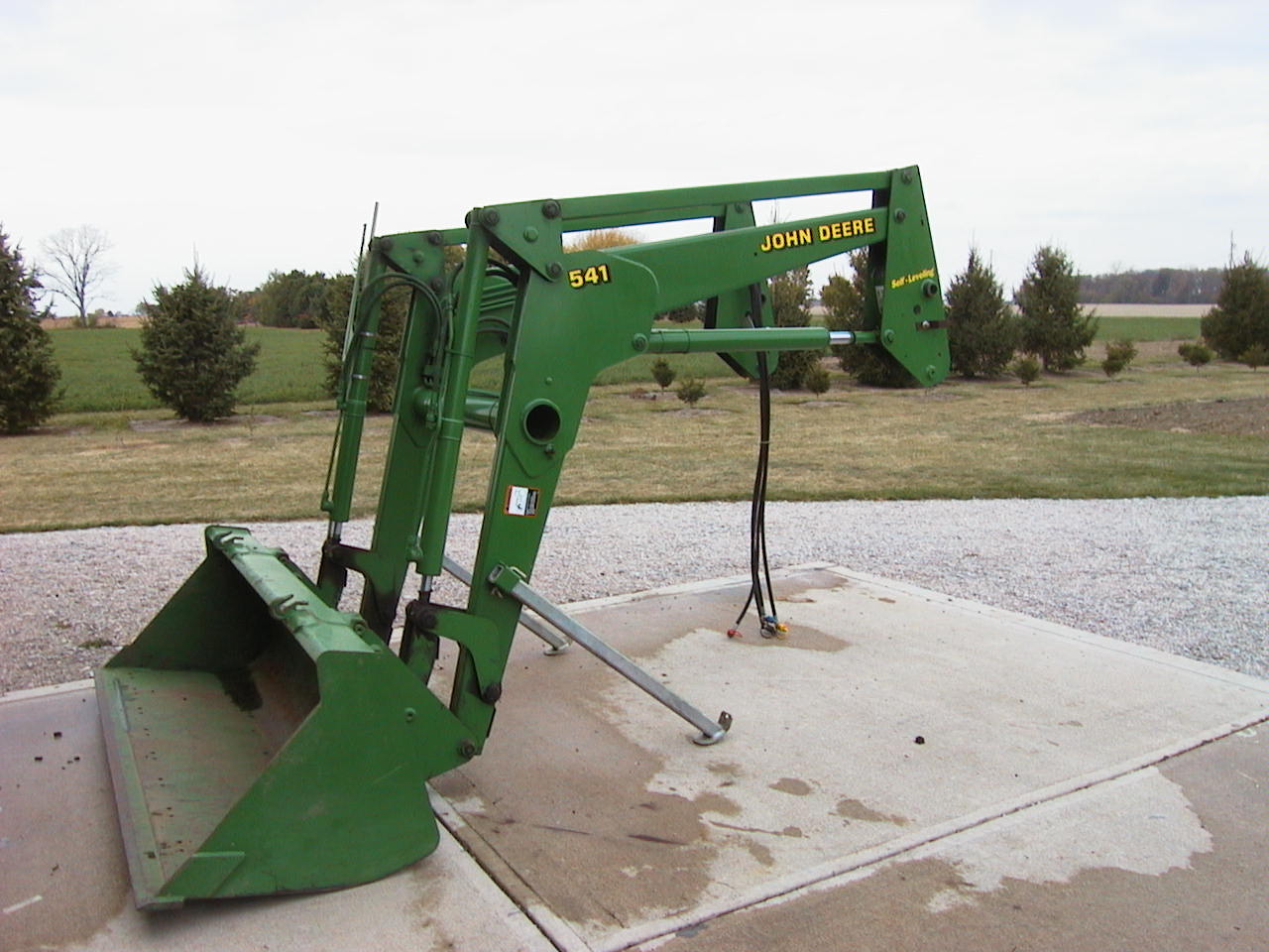

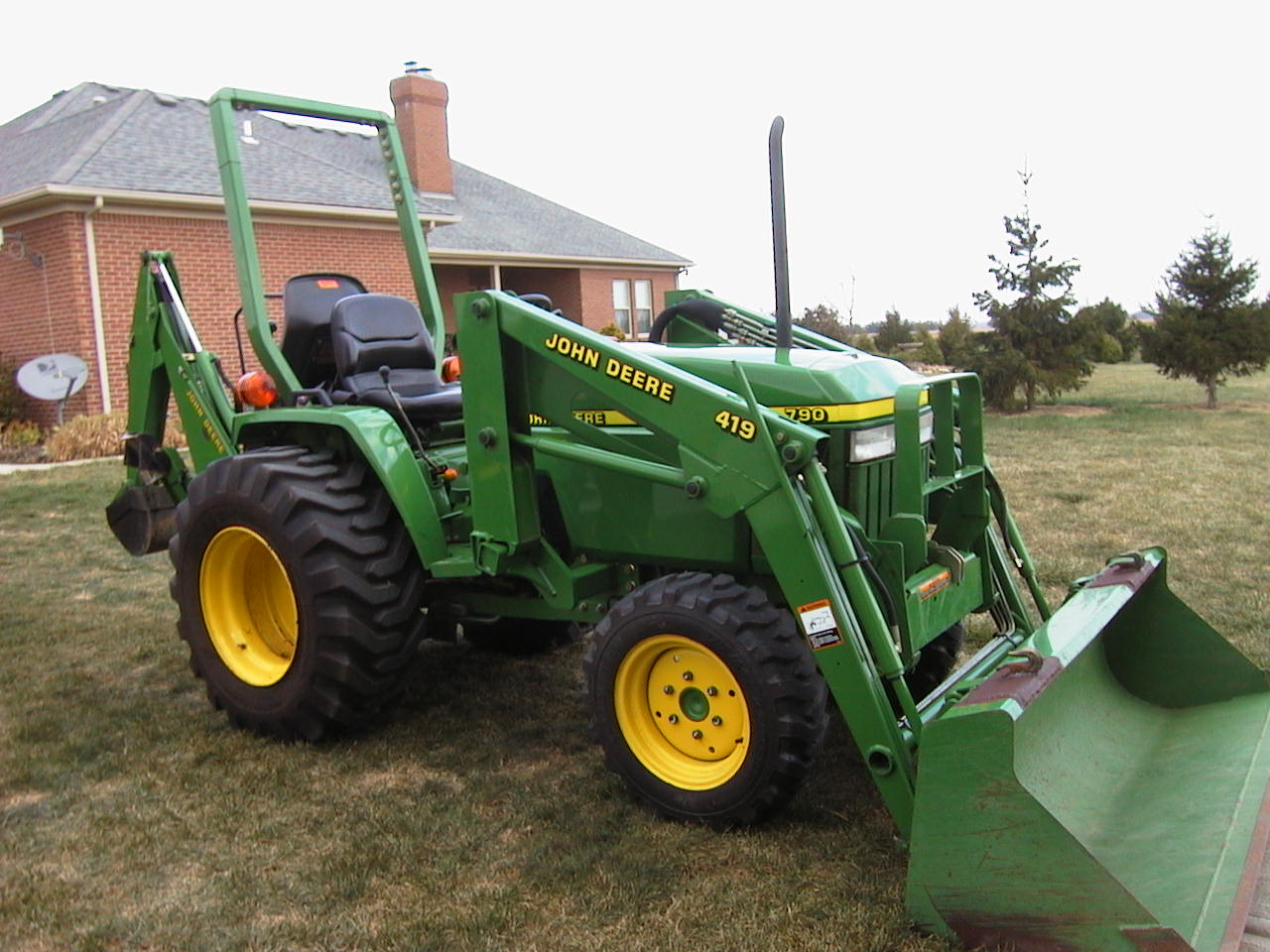

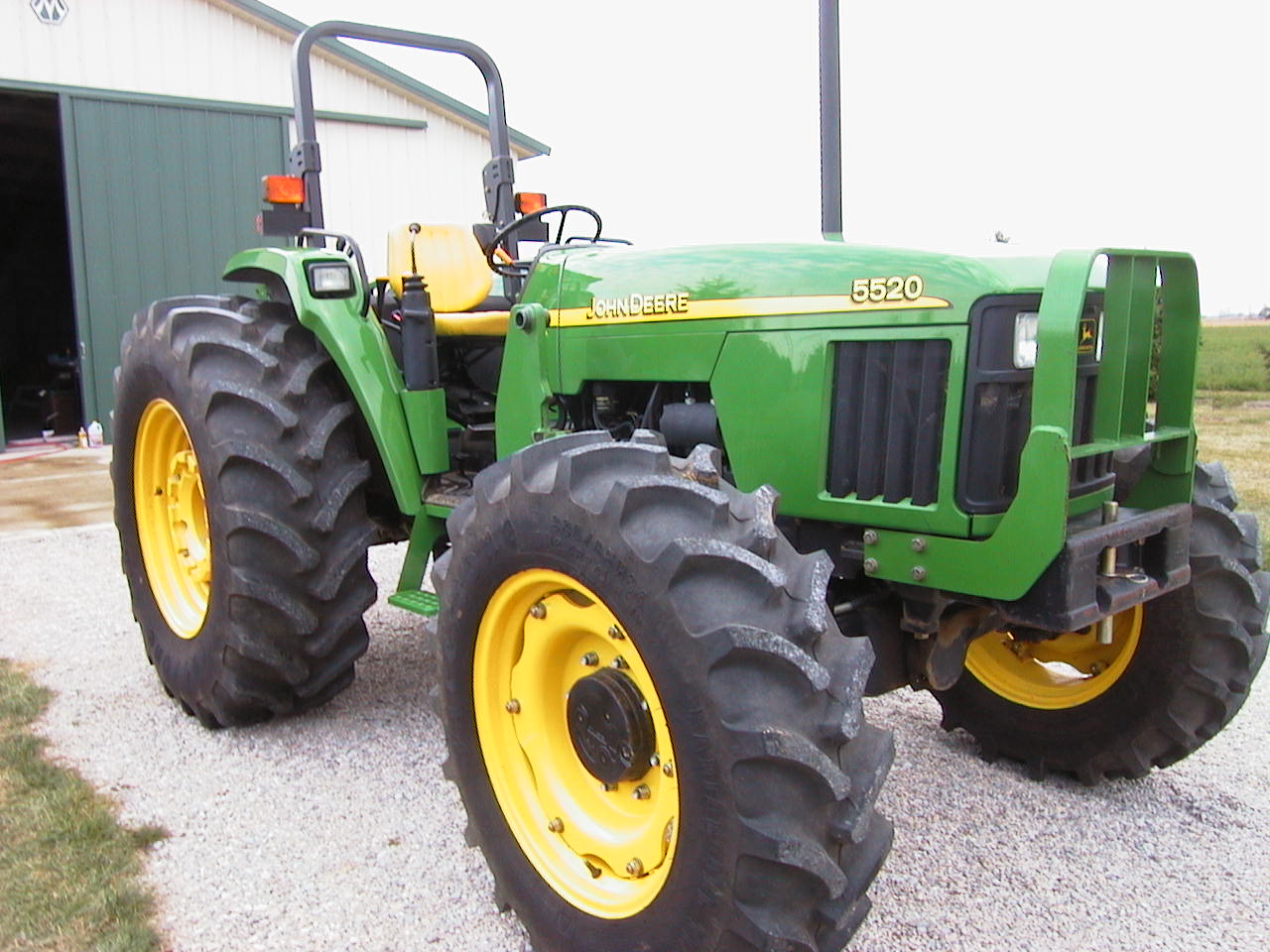

So, I finished everything with my Karcher el-cheapo electric pressure washer and got surprisingly good results. Photos attached. That thing cut grease it shouldn't have.
If you look inside the bucket in the loader photo and at the grease you can see what I started with. I did not clean things for two years--I had a good excuse----and they came out great.
After pressure washing I took the bucket and rag to things and did the hand wash. Interesting point here...normally I use dishwashing detergent and I did today but things weren't getting clean. So I poured some Sam's Club "no-rinse" floor cleaner in and the results were amazing. All the greased and crud and spots of whatever wahed off with the floor cleaner. I'm not saying to use it until you make sure it woun't hurt your paint but mine came out great.
The Deere 5520 looks better than it ever did, with the exception of new and the Deere 790 is as clean as is possible for something that you use.
Tractors are good and clean tractors are even better.
