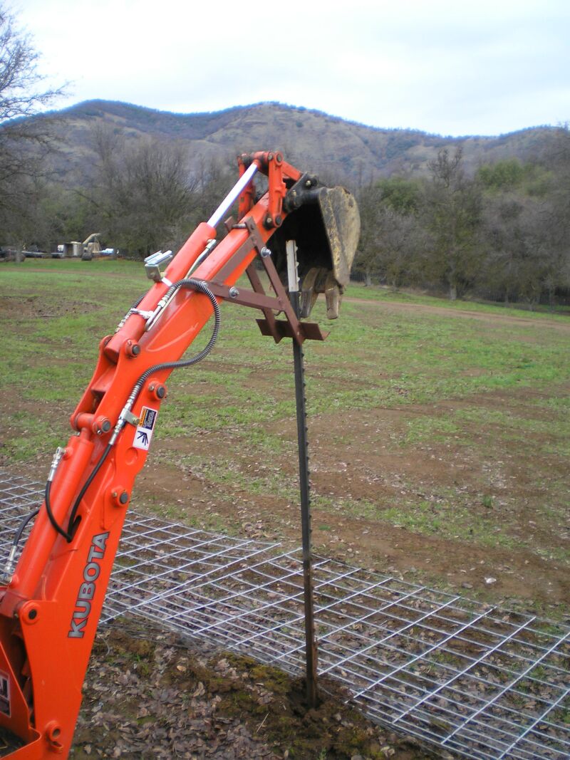

I have the older version of your BH. I've used it as many ways as I can think of and have never had a problem. I think the "no craning" rule is more of a disclaimer to protect the manufacturer. One of the best things I ever did is weld hooks to my BH bucket as I have much better control than with my FEL depending on the job.
