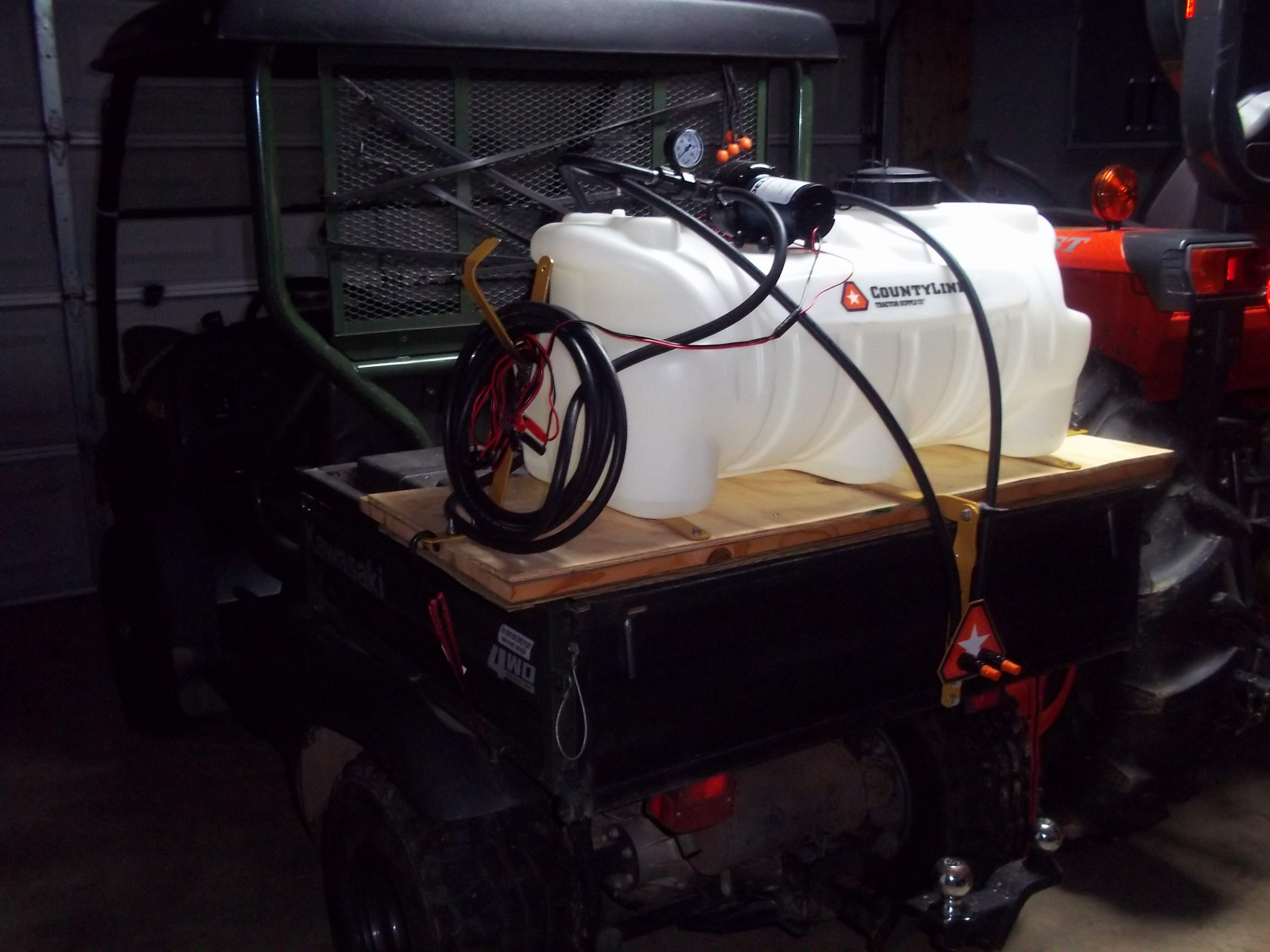

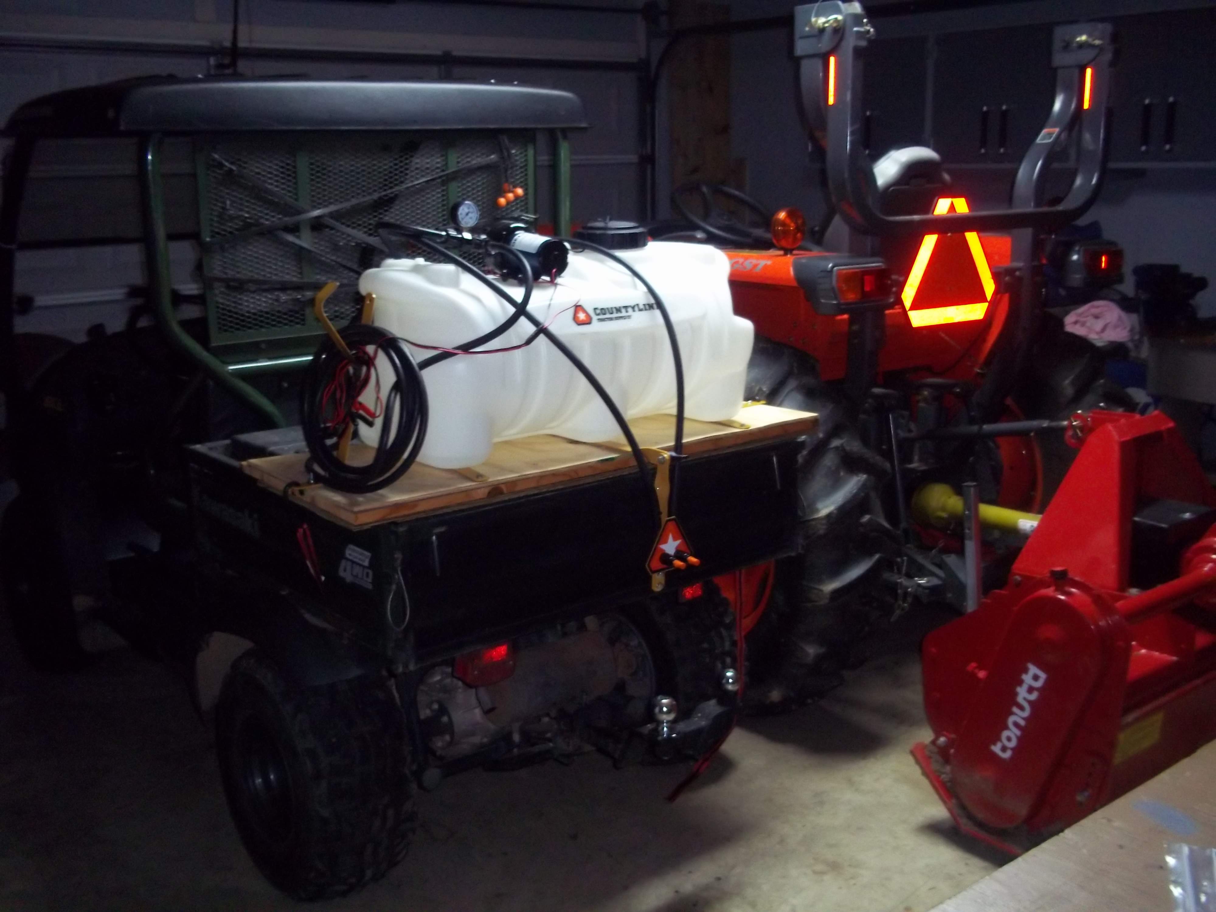

I had the say problem with the hand hose.. I mounted my sprayer on top of a sheet of ply wood that fits on top of the bed of my little 610 mule. It works better mounted there with the boom less sprayer I have. The sprayer I bought came with brackets to mount to the 4-wheeler rack. I simply used those brackets and made a place to hold the hose. I finished this evening and will paint it tomorrow. It was easy and the metal came with the sprayer.. keeps everything from falling off and easy to store when I am done...

Andy I like the mounting board idea. If I would cut a board to fit the rear step on the cart I would not even have to strap it down.

I like the board mounting idea too; especially mounting it on the bed rail of the UTV. Thanks for the ideas!
