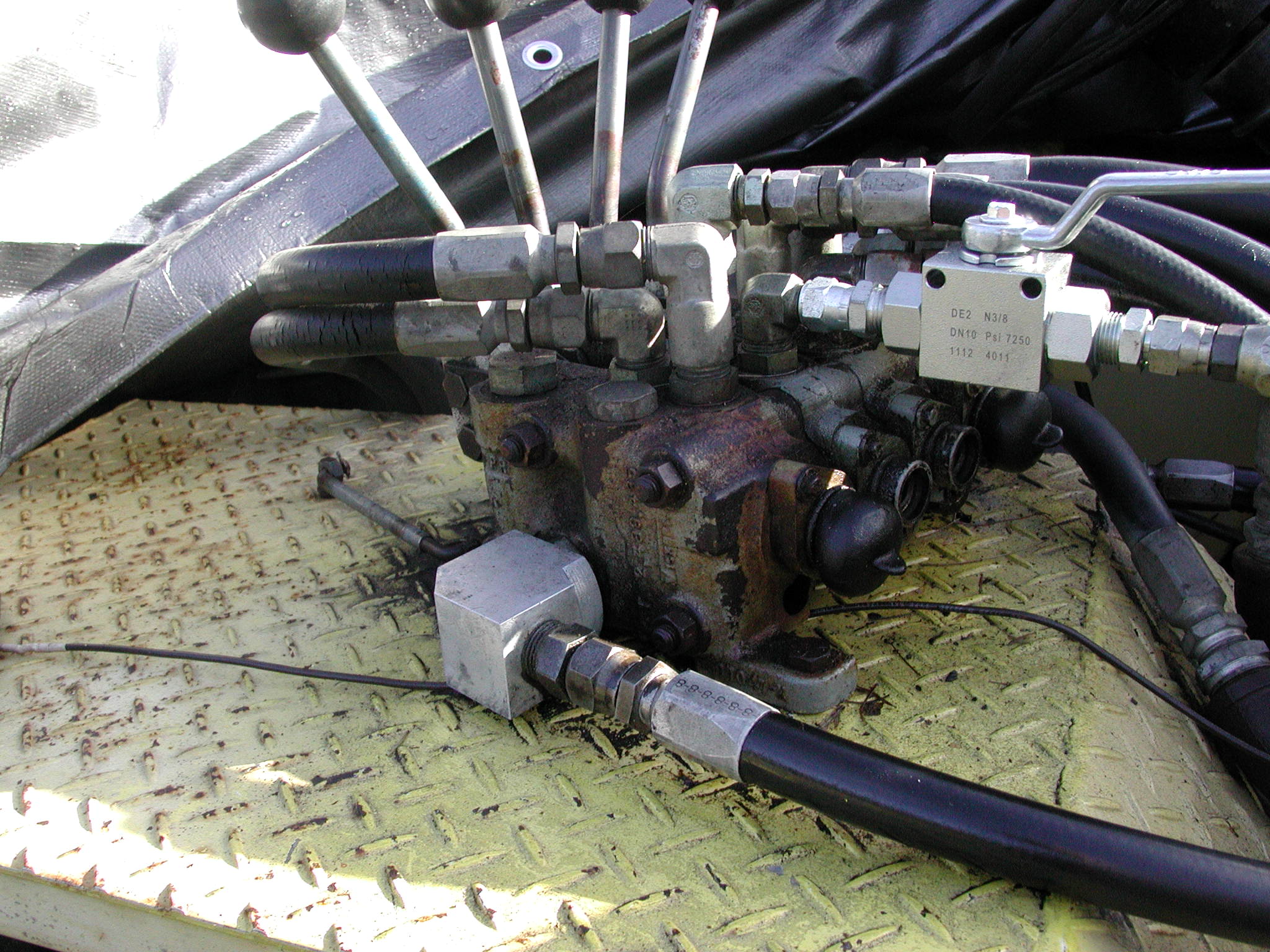

I have the same valve on my tractor. On mine that bottom port is hooked to the tank. The power beyond port is on the other end. Yours may not have one, I've seen them without.
I think you've found the problem, the power steering is doing something to deadhead the flow and the high pressure is leaking into one end of the tilt cylinder because of the worn spool. Pics of mine are attached.

Hmm, ok, so the port on yours that goes to the tank, goes to the power steering on mine. I don't have that side port like you have.
Yeah, the power steering whines constantly, but ofc gets much louder when I turn the wheels.
thx for the pics. What is all that for, wing mowers or something?
