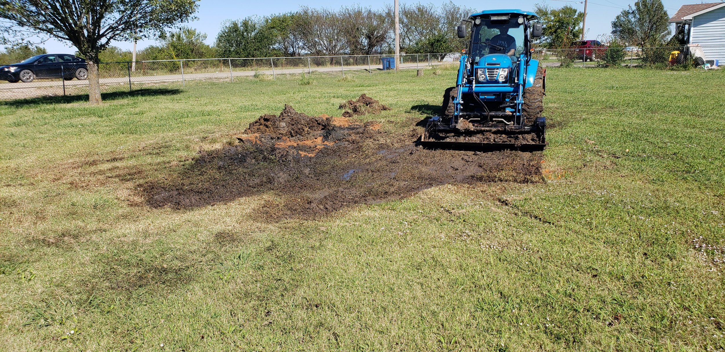

The WR Long 4 in 1 bucket is awesome, I used it yesterday to clean up a bunch of saplings and undergrowth. You can pick up the brush/debris and leave the dirt behind, this thing is a major time saver and it's built like a tank. WR Long builds quality implements.

I don't have a 3-point rough cut mower. I use my grapple. Open it up - slide the lower edge into the brush - close the grapple and lift. Rips my brush right out of the ground. Shake it a bit - all the dirt falls off.
