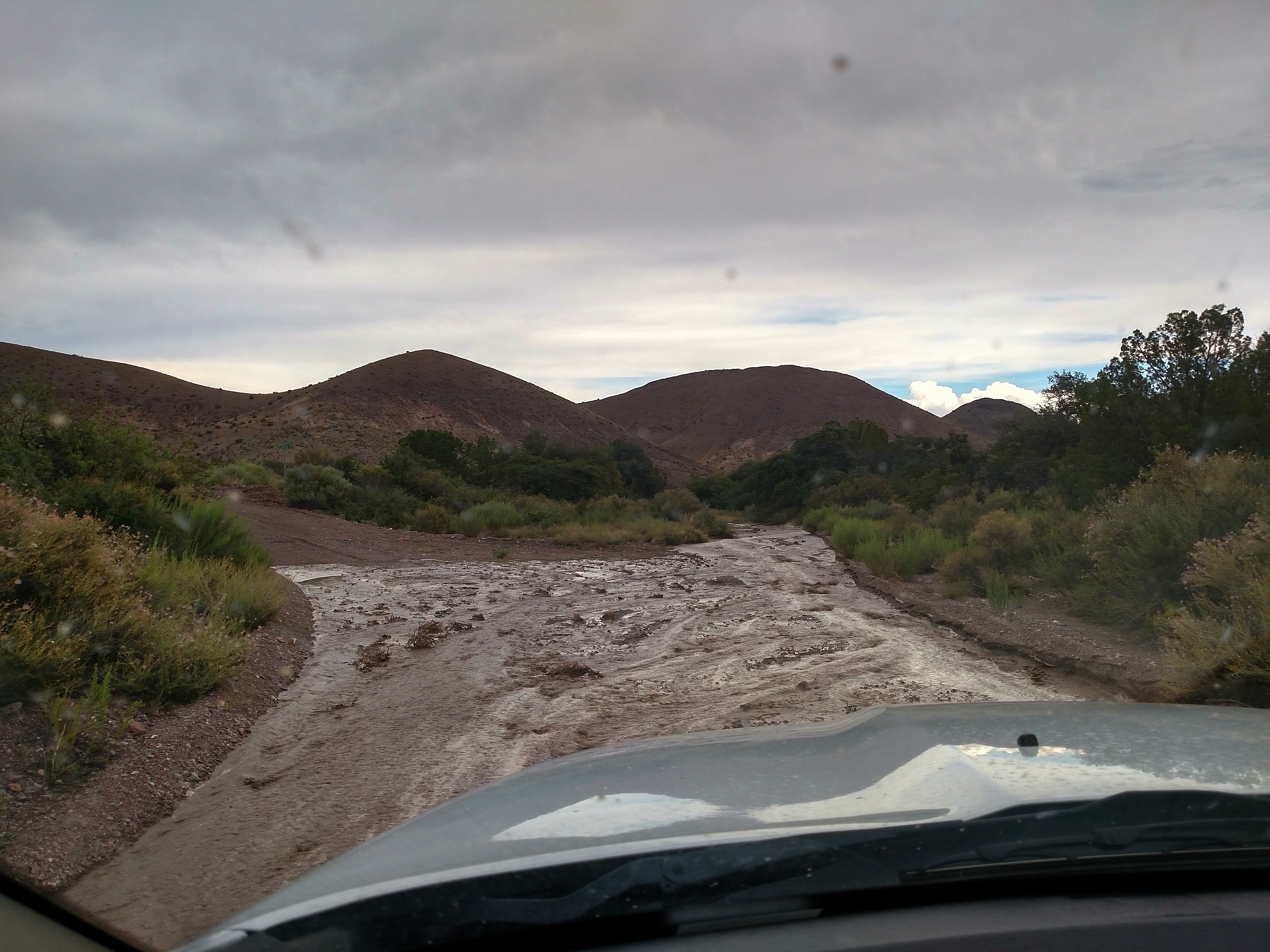

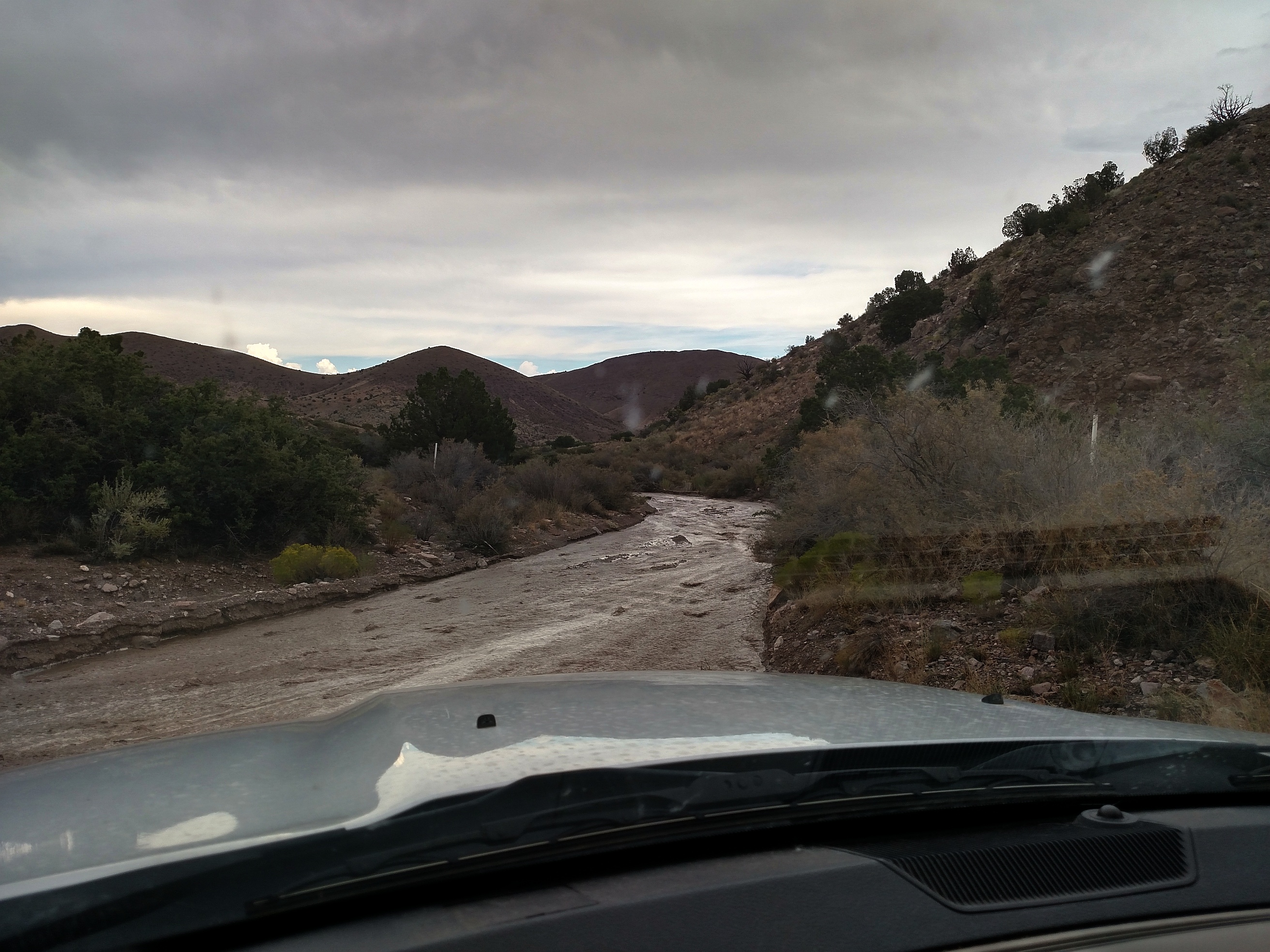

I use it for two things. Raking up the loose rock that magically appears in the driveway (~0.45 miles) as well as other areas of the property and then tidying up a portion of the road leading up to our area. This "road" is really a wash (or arroyo) and when we get heavy rains it often runs with water cutting little channels and spreading rock in it.
The roads (and my driveway) here are all native material. Which is to say no base course and no gravel other than what occurs naturally. A grader comes through twice a year to blade the roads and whenever a road gets so tore up by runoff that it can't be used. Some pics for clarity.
Entering the wash.
At our turnoff.

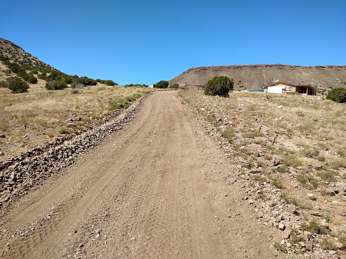

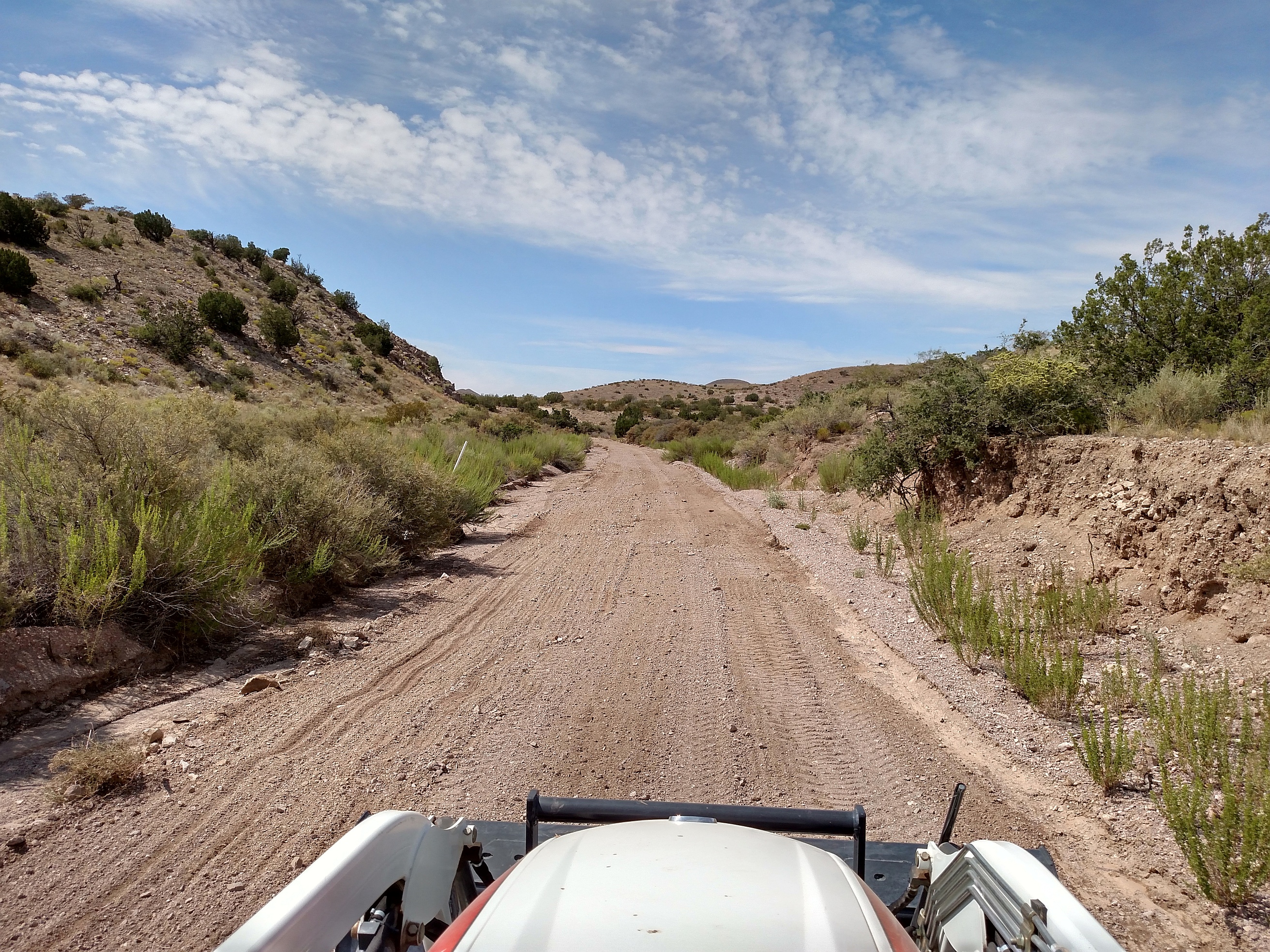

A week later cleaned up with the rake.
The problem is that while a 72" rake angled 30 deg still covers the width of the tires (60") at a 45 deg angle it is now ~10" shy of covering the tires. With the sheer amount of rock to be moved off I need to run at a 45 which means I can't get as close to the road/driveway edge as I would like. At a 30 deg it is just barely outside the edge of the tires. This leads to my driveway getting narrower.

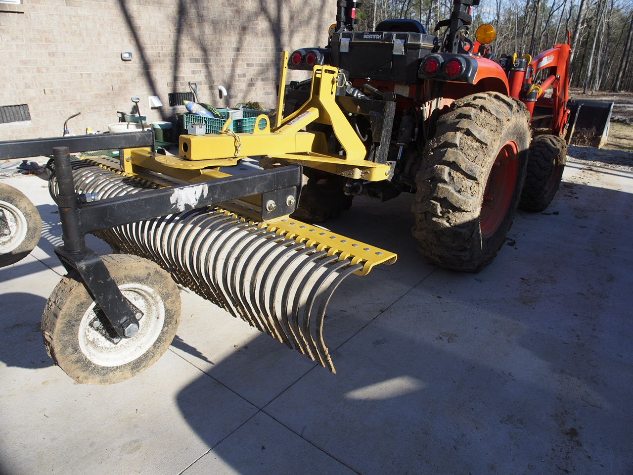

I have the ETA rake you mentioned at 84". I purchased the 84" version due to all of the trees on my property and limited maneuverability. I also have the gauge wheels and would not own this rake without them. They make final finish grading or any other use easier other than use as a blade, maybe_EM50931.JPG. I have T-N-T and it also makes using any implement easier. My tire width is a bit wider than yours and I would prefer a wider rake if I had the room to use it.
The rake also has a float position on it for the top link but I have never used it. See the ETA videos for this rake. One of them mentions the float position.
