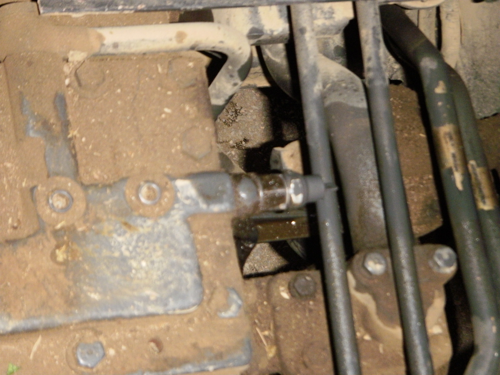

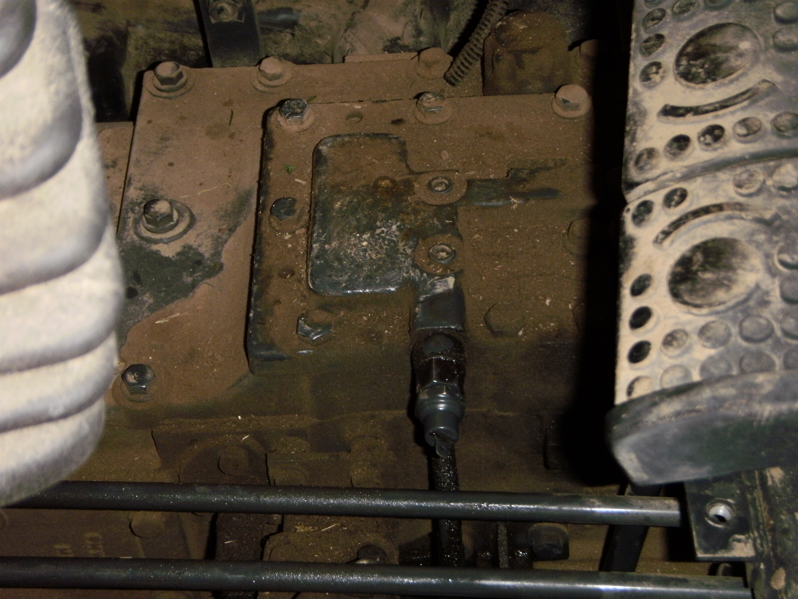

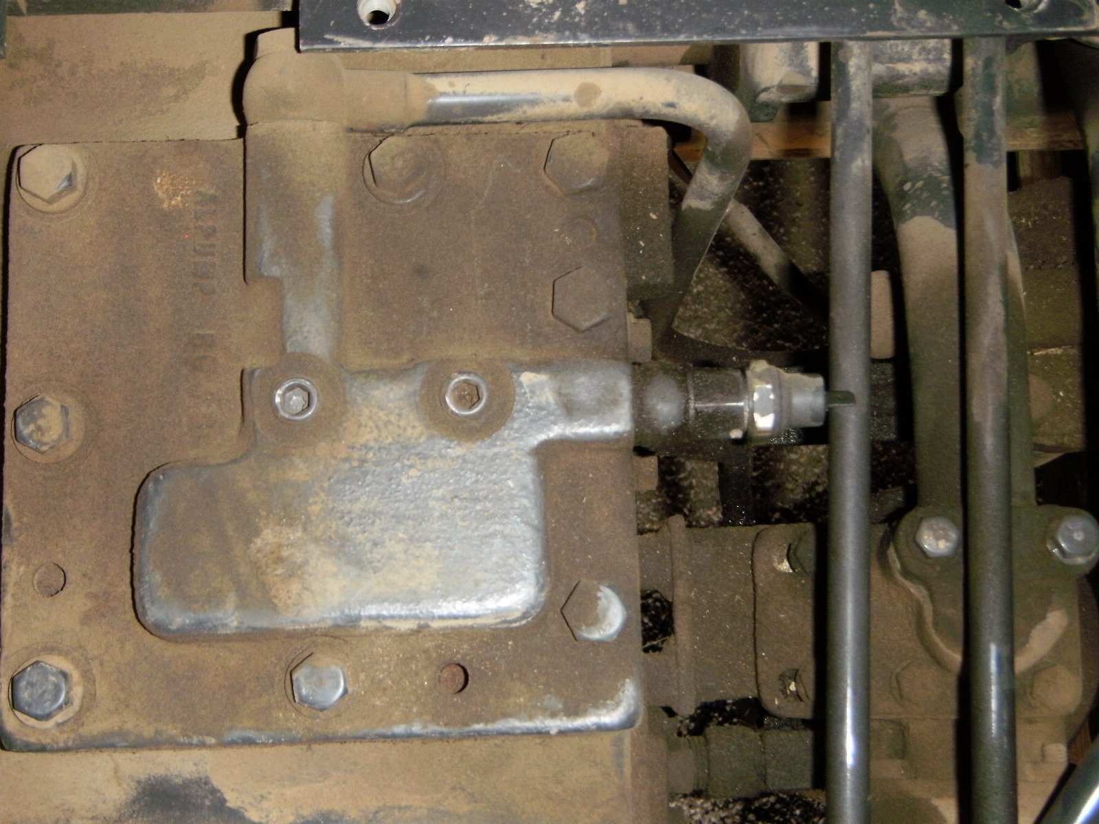

here are a few pics of the switch I'm talking about

Rustyjeep,
I did a little investigation this morning and I don't know if this helps you at all but the part# for your switch is 006003172B1 and the wiring harness for it is 007700492D91 and the harness lists for $ 73.54. I don't know if this helps, but hopefully it may. Good luck with it.
Wow. I cant find anything that even looks like that area in the 1st pic. Isnt that up at the very top of the trans housing near the brake linkage rods. Mine has an obvious filter cobbed on beside the housing near there, but NO plumbing entering at the top of the housing. The two lines to the filter go from near the bottom of trans housing then up to the filter head that is bracketed to the side of the housing. No switch in evidence at any point in the lines or connections. :confused2: ... Would it be possible for you to post that 1st pic with a broader perspective?

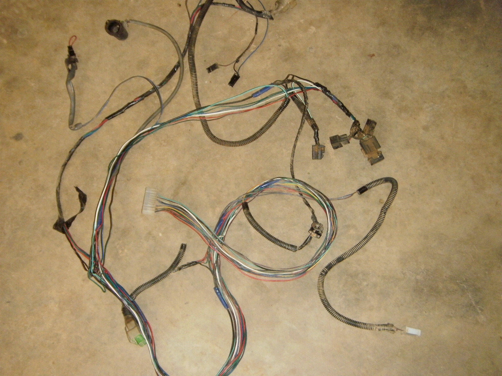

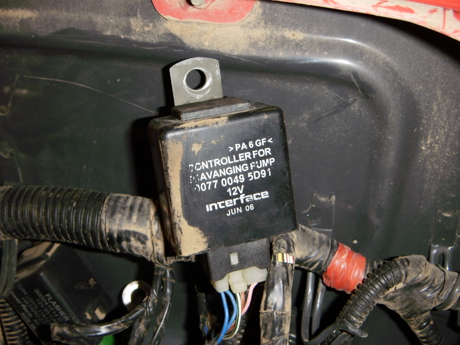

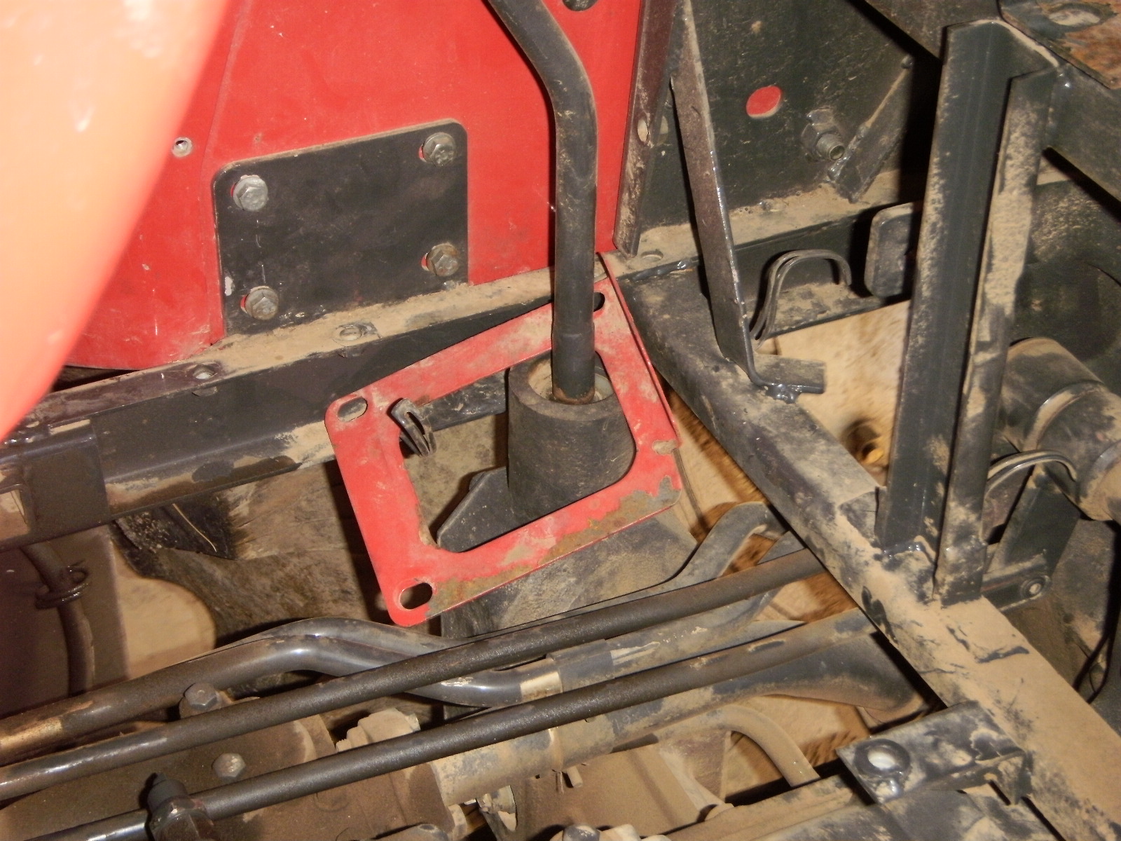

Here are a few more from a different perspective.
Galen, thanks for your time in looking for that. The reason I pulled the wiring harness out was because I could not find the wire that goes to the scavenging pump pressure switch. I hoped that it was still wrapped up inside of the harness, but it simply isn't there. So I wonder if I buy a new platform harness would that wire be there? I also wonder where the wires of the pump controller are going to now,and what is it controlling?
I still haven't figured out why the beeper is still sounding. I tested the engine oil pressure switch and the oil pressure with a manual gauge,it read 52 psi at an idle. Also with the engine running I pulled the wire off of the engine oil pressure switch and did not see any lights come on?? Shouldn't there be something warning me if my oil pressure goes to zero? The only light I get is the healthy light.
Total loss on the pictures. I think something was changed drastically between our models. .... Do you know about the beeper silence/reset terminals up at the fuse box. You take the spare fuse and plug it in to an "empty" position and the beeper resets. My beeper comes on at major hr maintenance milestones. [Could be whats happening with yours.] Iv reset mine twice. The third time I ignored it and it either reset by itself or burned up the beeper after a few hrs. :confused3:
