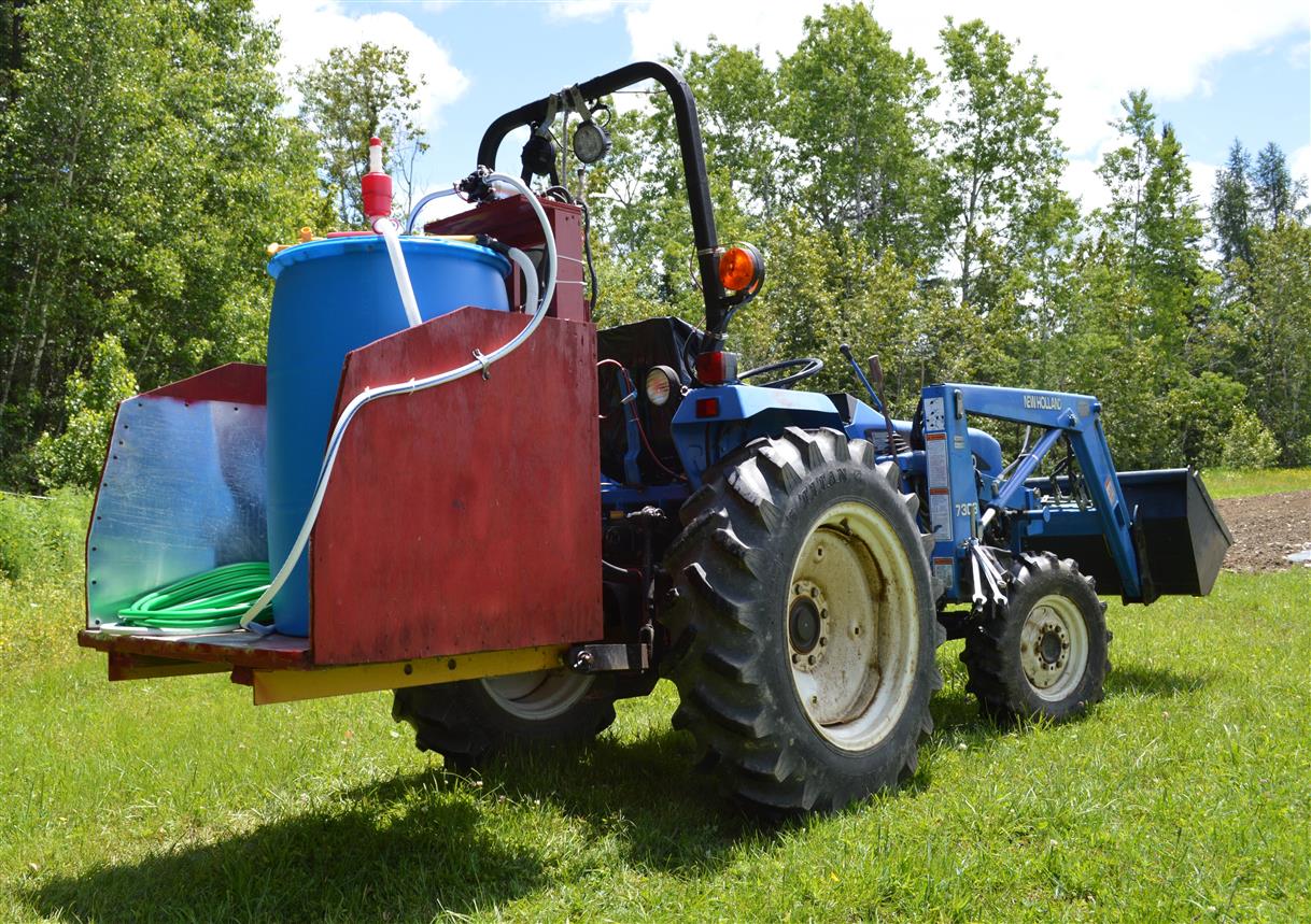

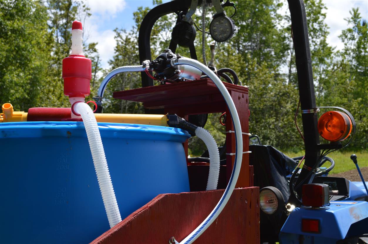

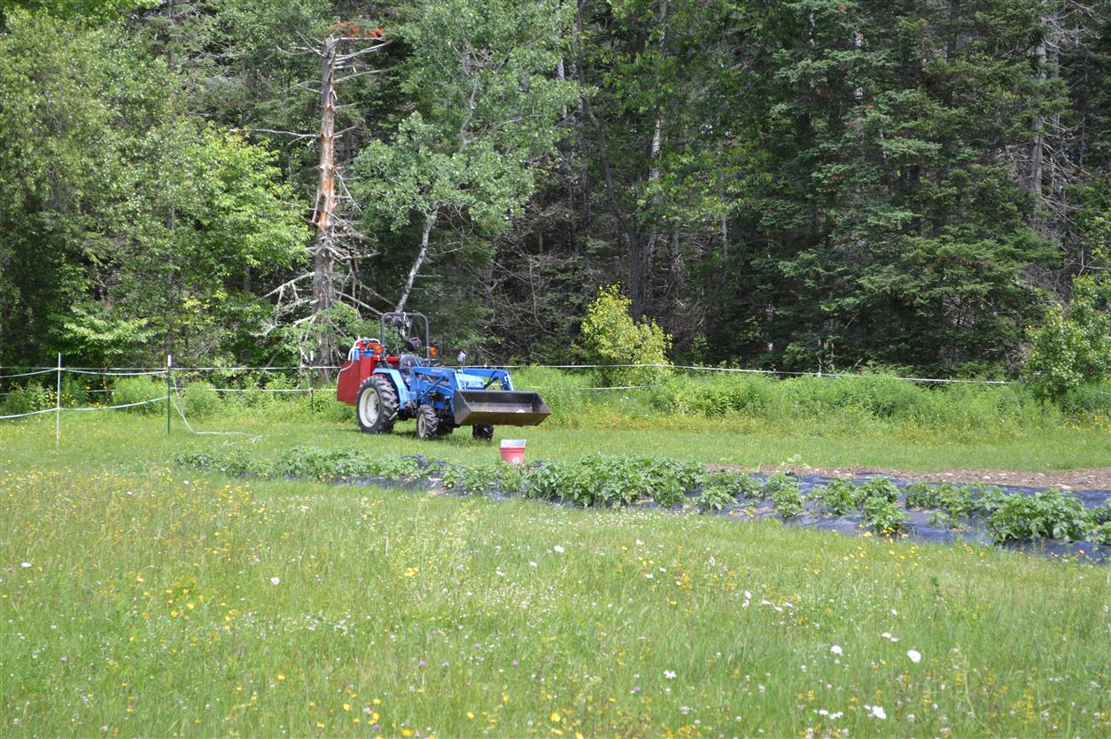

I planted a new garden in the back field, along with some young trees. It is too far to run a hose, so I got a 55 gal rain barrel from Walmarts and stuck it on my carryall. The siphon action was ok until the barrel was 1/2 empty. then it stopped. So I bought a small pump- 1 gal/mn and set it up to run off the tractor. I kept the gpm low so the draw would be low.
I've got a garden hose hooked up and it works great I have a 60' hose on it. For watering new trees- I can drive up along side and water them from the seat.
I always leave the tractor running and have a quick snap in electrical connector from the pump to the tractor. The pump is a diaphragm pump with a built in pressure switch. Works well.

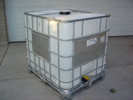

I have two 55 gallon barrels that I lay on the side with a spigot for a garden hose out the bottom of each. I have them strapped to a pallet and use that to haul water with my FEL to my young trees. I find that 110 gallons isn't enough so I am picking up a 275 gallon tote with a 2" discharge. I don't have electricity or a pumped well on the site where I use the water tanks, and I fill up with a 5 psi artesian well supply (takes forever). So I will be getting a submersible 12V bilge pump and dropping that in the creek to refill.

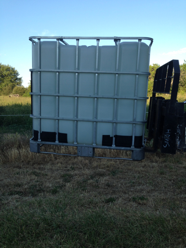

I picked my used 275 gallon tote Friday and got it all washed out. It was used for a non toxic oil so it cleaned up easily. I filled it up to the brim in the attached picure but I think in the future I will only fill it to 250 gallons. At the full 275 gallons the top of the oil cans a fair amount. Also, that is a lot of weight to have up high for the required gravity discharge.

I hooked up a 1-1/2" ID and 10' long hose to my 275 gallon tote and man, can I water my trees fast now. I put about 20 gallons down per tree in a very short amount of time. The tote is marked on the side so it is easy to tell when I need to move to the next tree. The tote does not need to be raised as high as my 55 gal barrels with garden hoses. Next I have to get a high capacity bilge pump to use in the creek rather than wait overnight for my 5 psi artesian well to fill the 275 gallons.
