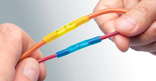

These connectors are on sale right now at Amazon. https://www.amazon.com/dp/B07T1HYJ9G/ref=twister_B08HLLPW6V?_encoding=UTF8&th=1
   / Waterproof Solderless Heat Shrink Butt Terminal on sale #2
Coworker ordered a couple kits of butt splices from Amazon for our work trucks.
To tell you the truth, I was disappointed. The kit seemed really nice. But the metal they use is way too soft so the crimp is extremely weak.
Most of these are not crimp but solder and shrink with a heat gun. Works well but really hard if you get lazy and try a lighter....
Soft metal inside is just a tin solder not crimp sleeve.

Is there any flux included in these? The completed solder joint looked like a bad solder joint, like no flux was used in the connection. There were strands of wire that didn't have any solder on them.
   / Waterproof Solderless Heat Shrink Butt Terminal on sale #8
these come up a bit, they work fine if your patient, i actually made a video, because everyone said how much they suck and aren't strong.
link to what i used is in the video
   / Waterproof Solderless Heat Shrink Butt Terminal on sale #9
I bought a set of these butt splice waterproof connectors. The metal alloy used of course melts at a very low temperature. As near as I can tell there is no flux. Anyway, before trusting the connectors I tested them. If CLEAN copper wire is used then the alloy wets the wire just fine and the joint is mechanically sound. Oxidized copper wire WILL NOT be wetted and the joint will fail. For making up butt splices with clean wire when all you have is a heat gun or similar these connectors seem to be fine. I will be using them for some joints.
Your just assuming. The kits we have are crimp with heat shrink on the ends. Not a solder connection.
