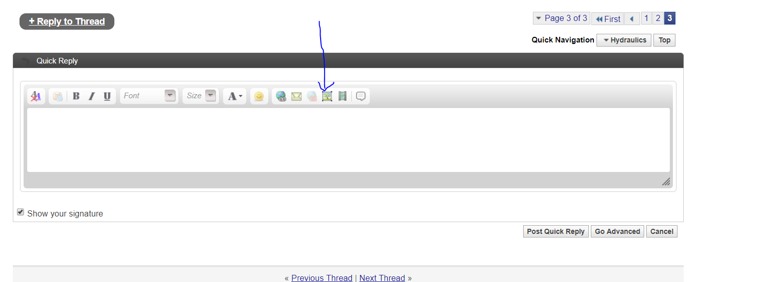

How do I attach a picture from an iPhone?
My phone won’t let me post a screenshot otherwise I’d offer a coloured on screenshot. The icon is at the bottom of the page not top.
