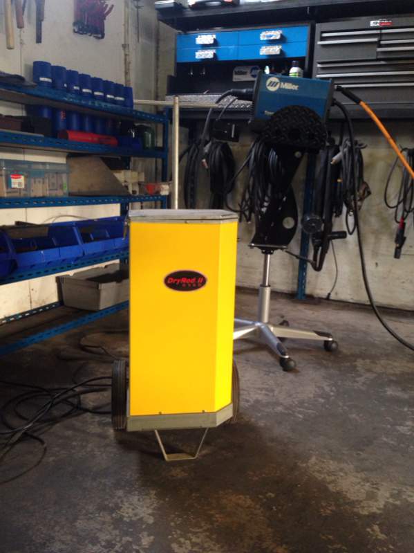

I have a 50# rod oven and on initial warming of 7018 it gives off a sulphur(?) odor.
Whatever it is, wouldn't be worth the risk doing it in the house.
image-3493477436.jpg Terry

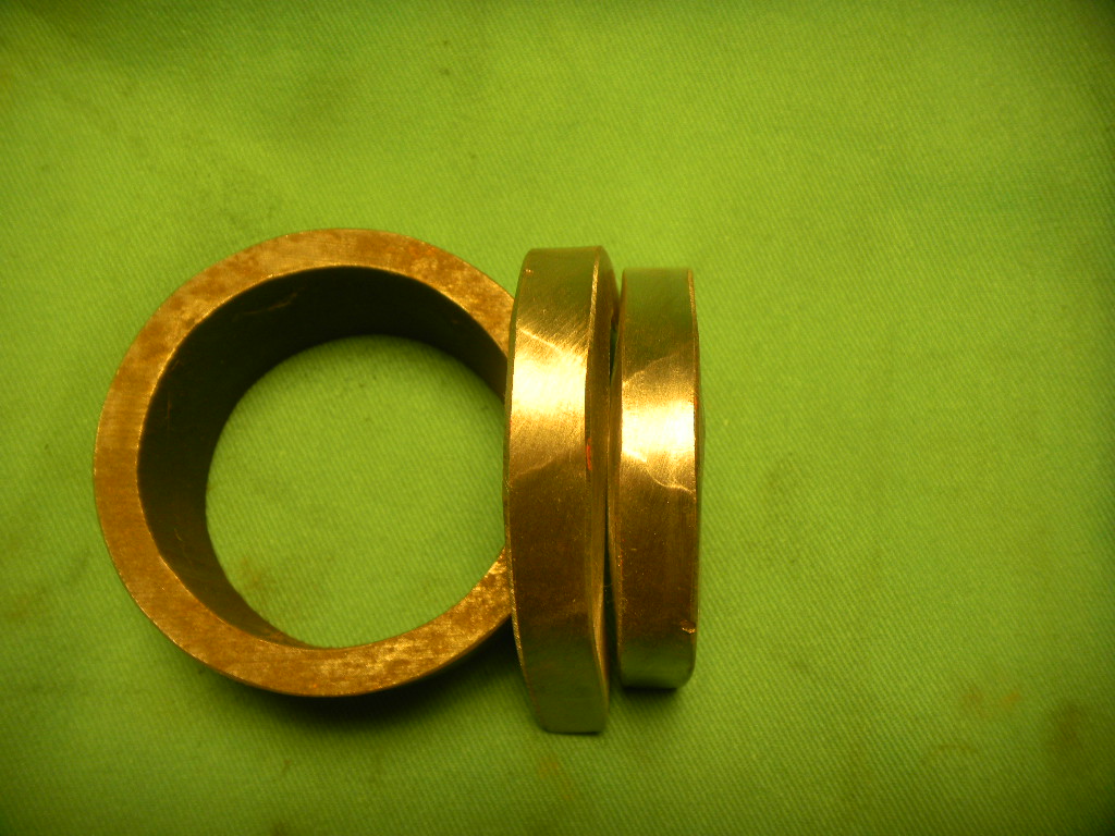

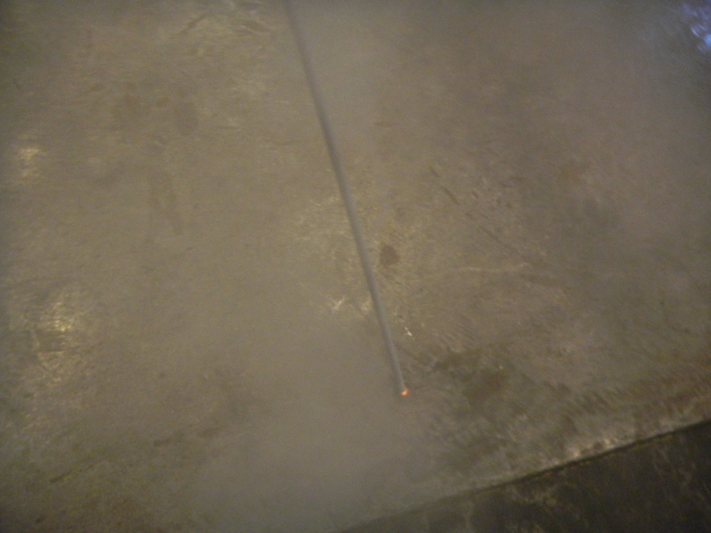

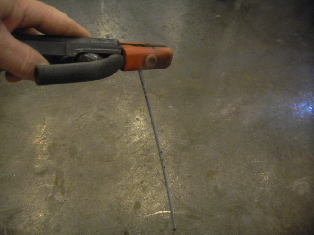

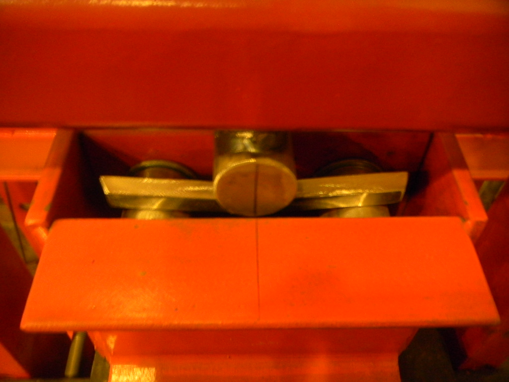

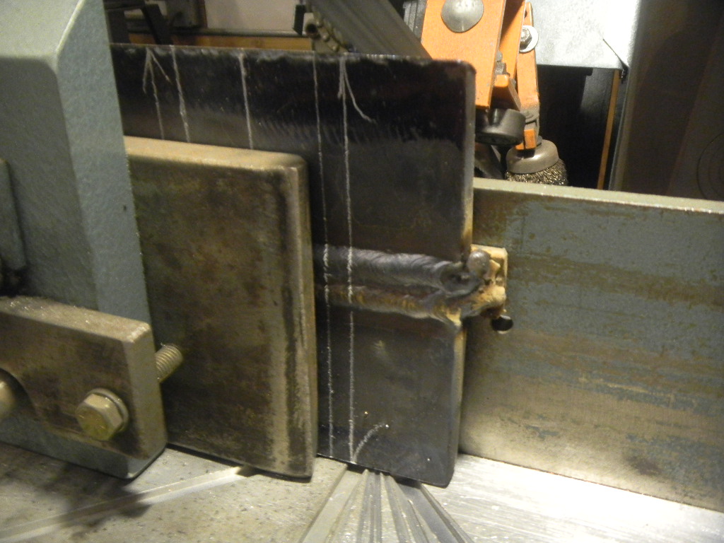

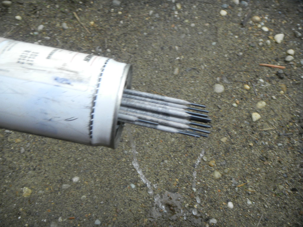

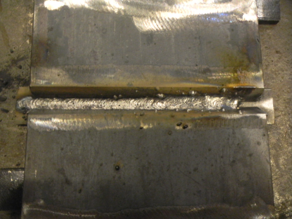

If you're not doing code work, I wouldn't worry to much about cold 7018. Now 7018 always runs best when hot.
I use to build bridges for a living. When building the false work for concrete bridges, you wouldn't believe how many times a carpenter type would leave the lid to the gang box open, and get the 7018 wet. But we couldn't let that stop us.
