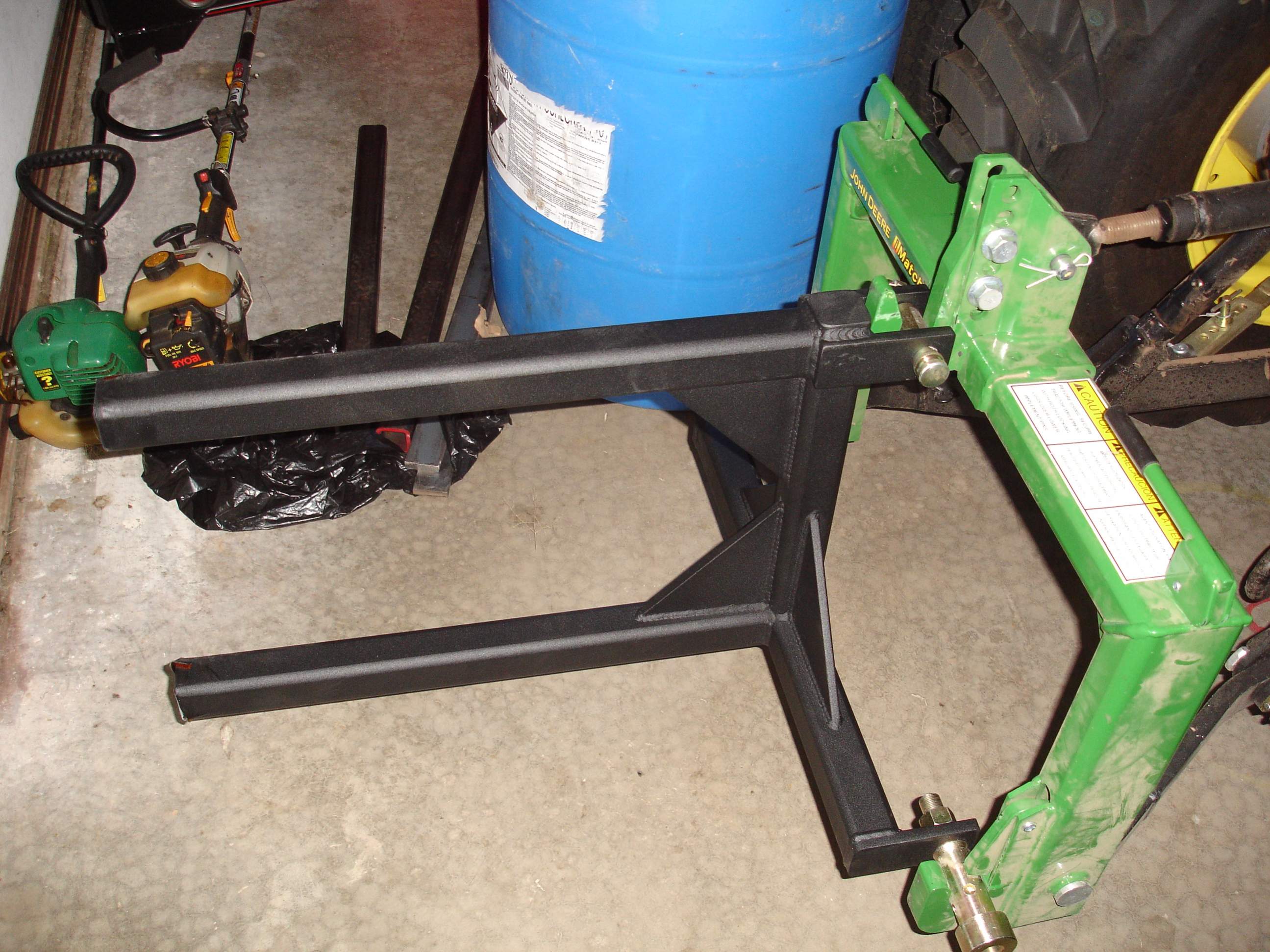

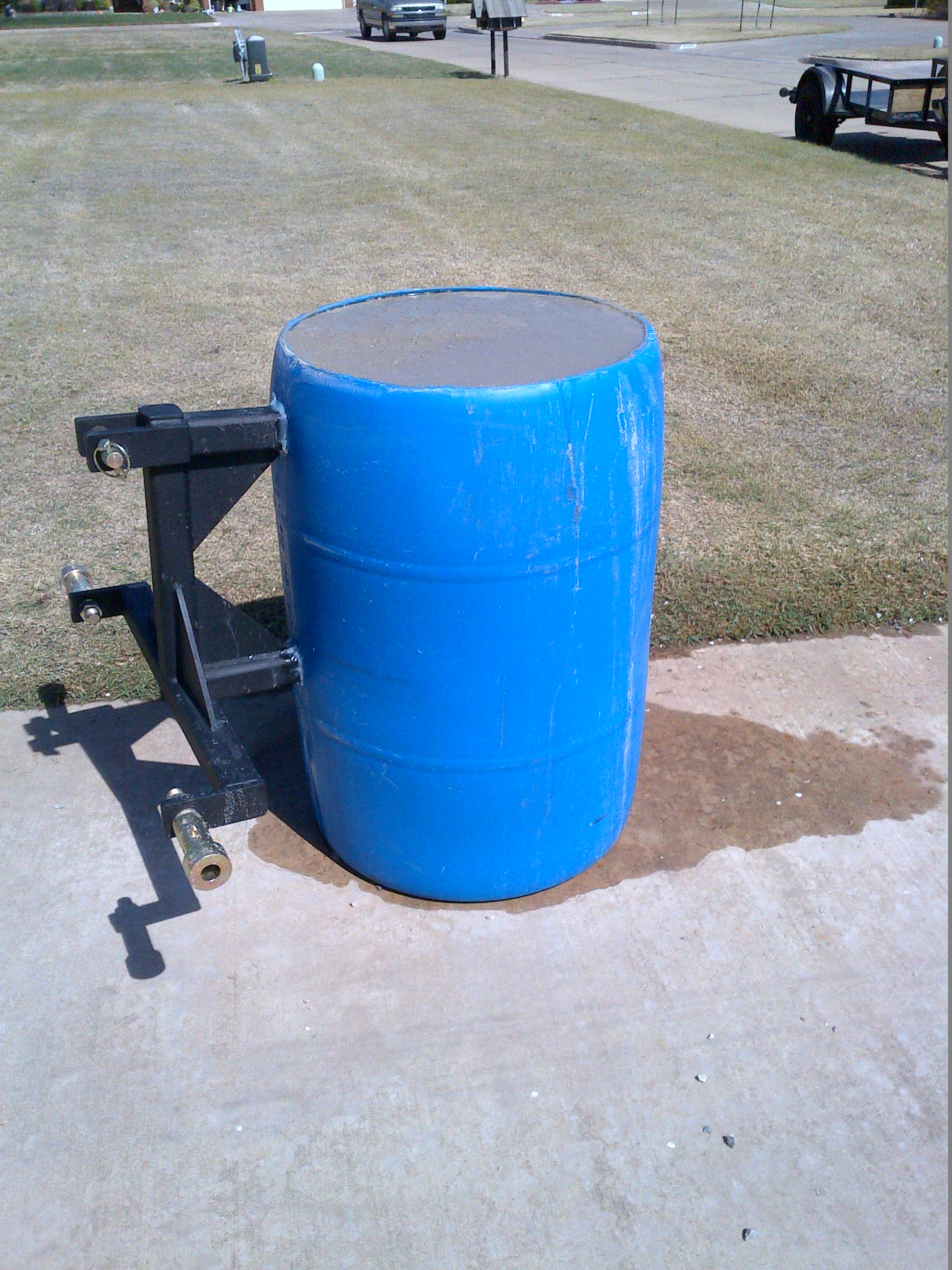

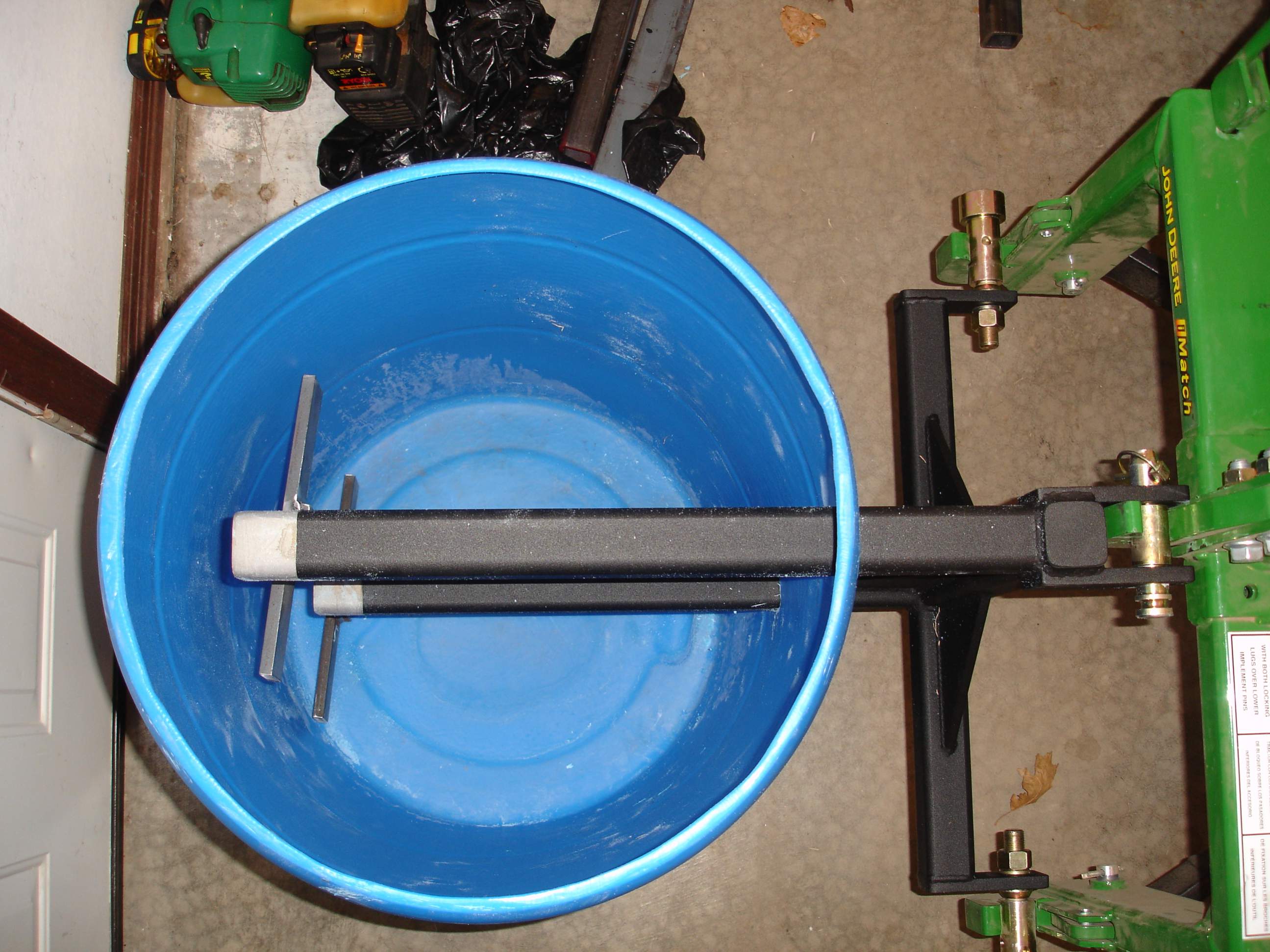

Barrel Ballast Finished! It'll sit in the driveway for a week and then go out to the ranch. I put a bunch of rebar in it. To fill it, I put the mixer in the bed of the truck and was able to dump directly into it...twelve 80 pound bags.

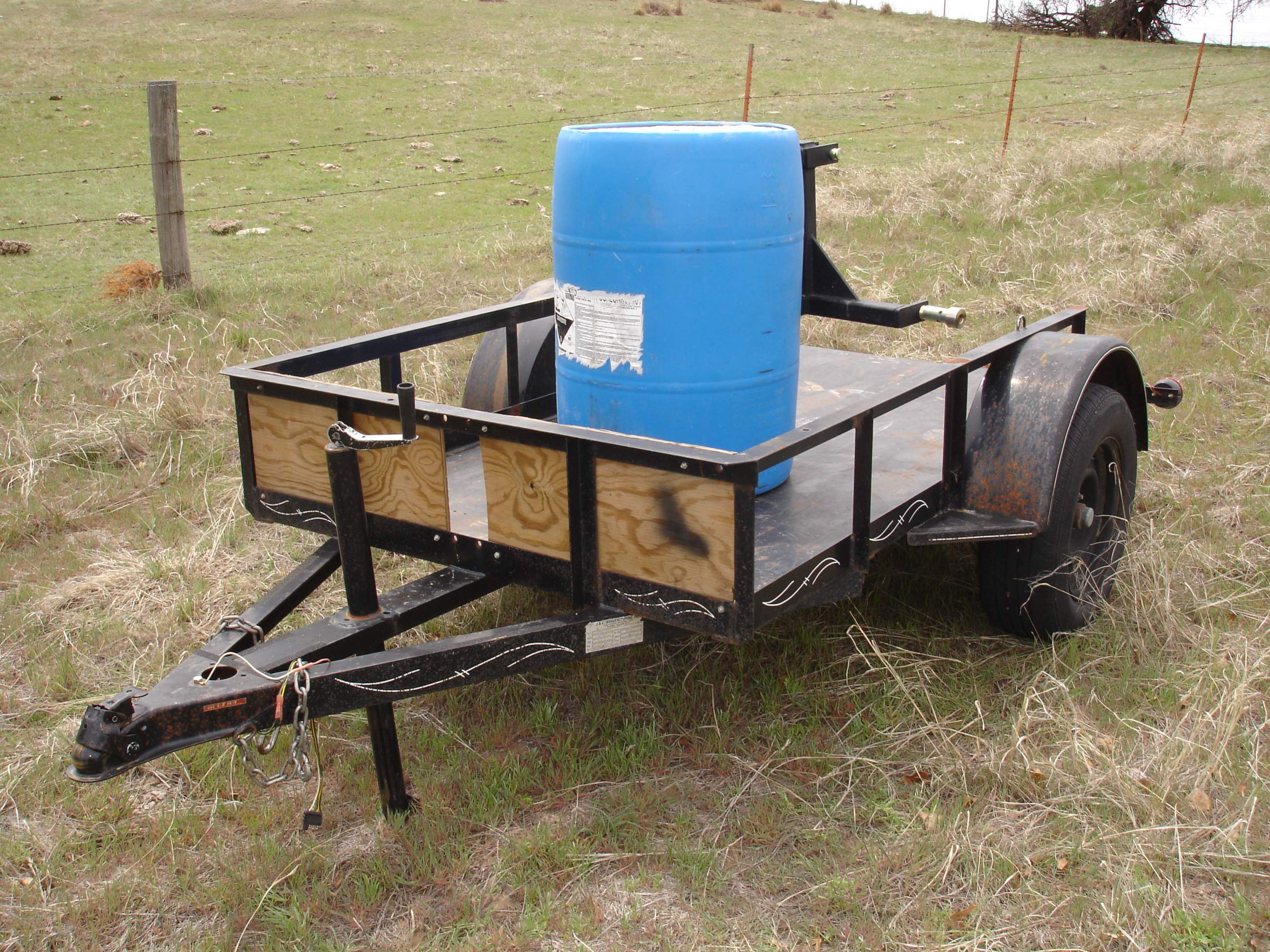

Well, it made it to the ranch. The photo doesn't show the 8 straps I put over and around it. Picking it up with the tractor was interesting. It clearly is heavy - 960 pounds of concrete alone. Finally, I can get out and start decimating the red cedar with the tree sheer.

Very nice! I'm thinking of making one of these myself. What size square tubing was used? What are the dimensions on the triangles?
