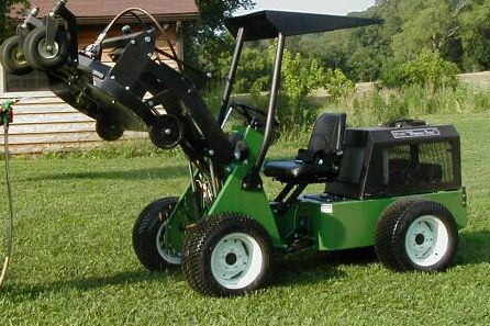

Re: What A Week Pt. II -- PT-425 First Impressions
They say that the only thing that will survive a nuclear war is the cockroach. 'They' are wrong. There will be Power Tracs too.
H*ll-for-stout is the best description I can think of. Thick steel plate seems to be the favorite material of the PT-425's designer. Even the engine hood is a heavy steel weldment.
PTs are clearly hand built. This is no automated production line product, and as such, individual machines can have their own problems, as opposed to mass produced items which tend to share problems.
While I assume jigs are used when the assemblies are welded, the first problem we encountered is probably unique to our machine. One of the tubes that houses the PTO hoses was welded slightly out of position. This causes the attachment's hydraulic hose fitting to interfere with a cross bar on the lift arm. Due to this, it is difficult to connect and disconnect the hose. Scott even had a problem when he was showing us how to do it at the factory.
It will probably be easy to take care of. The hose fittings are locked into the tubes with top mounted set screws. These tend to point the fittings downwards. The tubes are much larger than the hoses, so it should be no problem to insert a shim under the problem fitting in order to raise its 'point of aim.' That should eliminate the interference.
The steering via hydraulic articulation is different than anything either of us is used to. The steering is very slow. It requires a lot of cranking on the steering wheel to make a turn. It is also very easy to overshoot your turn and then in turn overcorrect. A lot of weaving is the result, and practice is definitely required. It quickly became apparent why people put spinner knobs on these machines.
I take it on faith that the Power Trac designers have tried other steering ratios and found the present setup to be the best compromise.
The steering wheel itself is another matter. It is small in diameter and small in section. It is made of hard unforgiving plastic. The best overall term I can use to describe it is 'unacceptable.' A more accurate term would require language not suitable for TBN.
Both of us drive the PT the same way. We put both feet on the treadle. This means the only way we can brace ourselves for the dips and bumps is to hang onto the wheel. Neither one of us has big hands, but both of us were quickly complaining about the wheel. It is actually painful to hang onto after awhile.
The steering wheel is also unusual in my experience in the way it mounts. It is held onto the steering shaft by a roll pin instead of a nut in the center of the hub. This may make it difficult to replace, which is my early intention.
One last point about the steering. The steering shaft is slightly loose in the nylon bushing that protrudes through the top of the console. There is noticeable play. In fact, while it may only be my imagination, it seems like the play increased slightly in the 3.6 hours we ran the machine. This area requires more investigation.
The engine is a Kohler Command Pro 25. It starts up easily, but seems to run lean. It tends to backfire when it is shut down. I suspect this is due to meeting emission requirements, especially those of the California Air Resources Board (CARB) which the engine meets, whether you live in California or not.
The operator's console is neatly laid out and nicely marked. The steering wheel is slightly to the left, presumably to accommodate the joystick.
The parking brake works by locking two of the wheels. It is more like the park position of an automatic transmission than a brake. The wheels can either turn or not. There is no in between. It works fine, but the handle is stiff to operate. It may just be too tight on our example.
The hydraulics work fine. The joystick is good sized and is very crisp. Float locks nicely. PTO engagement is by a weather protected toggle switch. It also provides the only starter interlock. Surprisingly, there is no treadle interlock.
Two work lights are mounted on the outside corners of the console. They are controlled by another weather protected toggle switch. They will not work with the ignition off, thereby protecting the owners from themselves. Personally, I would rather have the ability to flatten my own battery, thank you. There may be some day when I need those lights and the ignition off.
We cut the entire lawn area in about three hours, which is somewhat faster than we could do it with our old lawn tractor. We expect to be much faster with practice. The mower gives a nice cut, and we are quite pleased with it. The hydraulic motor is tiny compared to our expectations. There is one belt which the little motor uses to drive the three blades.
The mower is fairly quite except for an occasional clanking. This is either coming from the Quick Attach plate or the mower articulation setup. It does not detract from the mower's performance, but does take some getting used to. We will experiment with the lift arm's tilt setting to see if we can find a quiet position.
Cleaning the mower deck after use is a joy. See the attachment.
The Quick Attach system works like a charm. When I first started looking at Power Tracs, I thought the hydraulic attachment locking system was an extravagance and unneeded froufrou on a work machine. After all, it would only take a few seconds to dismount and throw a manual locking lever. Plus, you have to dismount for PTO powered attachments anyway.
But later I learned that the Quick Attach hydraulics also provide an auxiliary hydraulic function for those implements that need them--sort of a set of front remotes. It's a good idea.
The seat is comfortable and seems to have a good adjustment range. The seat belt, however, is absurdly long. It might work out though. The seat belt on our Branson is absurdly short. I sense a switch coming up.
All in all, we are pleased with our purchase. We think it will do exactly what we want it to do. There are some rough edges that need attention, but they are not totally unexpected.
And most important of all, the Mistress of the Mower really likes it. /forums/images/graemlins/smile.gif
Please keep in mind these are first impressions and may well change. We'll keep everyone posted. After all, Moss Road will want to know how well he spent our money.
