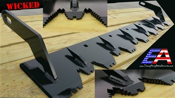

So unfortunately I don稚 have the money for all the attachments I want so I need to sort the most useful, figured I would buy one a year till I have a good line up of attachments.
Tractor: Mahindra 5555 (55hp 8,000lb 4x4)
Attachments: Bush Hog BH17 (7ft rotary cutter), EA 78 extreme duty box blade, 6ft 3pt Ford rear blade (scrape blade), pallet forks (don稚 like design or fork length), and bucket.
Property is 3 acres of cleared land I raise cattle on and feed round bales. I do custom bush hogging, driveway maintenance and chores on family & friends lands. 32 acre hunting property etc.

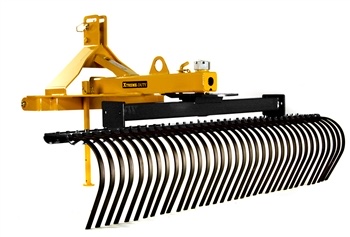

This year im leaning towards buying a wicked toothbar for the bucket, bucket tamers for snow removal (instead of rear blade) and severe duty 7ft landscape rake (tired of picking up sticks in the pasture and fence line), also picturing rake to replace what I use the scrape blade for.
View attachment 671715View attachment 671716
I don稚 like the design of the pallet forks that came with current tractor I have, I also want longer tines/forks 48? I came really close to selling these and buying a design I like better but instead will prob buy an attachment I could use more.
I will need a post hole digger next spring but will only be digging less than 10 holes so I値l prob rent one.
What痴 your go to attachment? What attachment not on my list you couldn稚 live without? Maybe I値l have more use for it than a rake. Pasture maintenance attachments?
Buy the 7 foot rake and I will trade you for my 84" tooth bar
