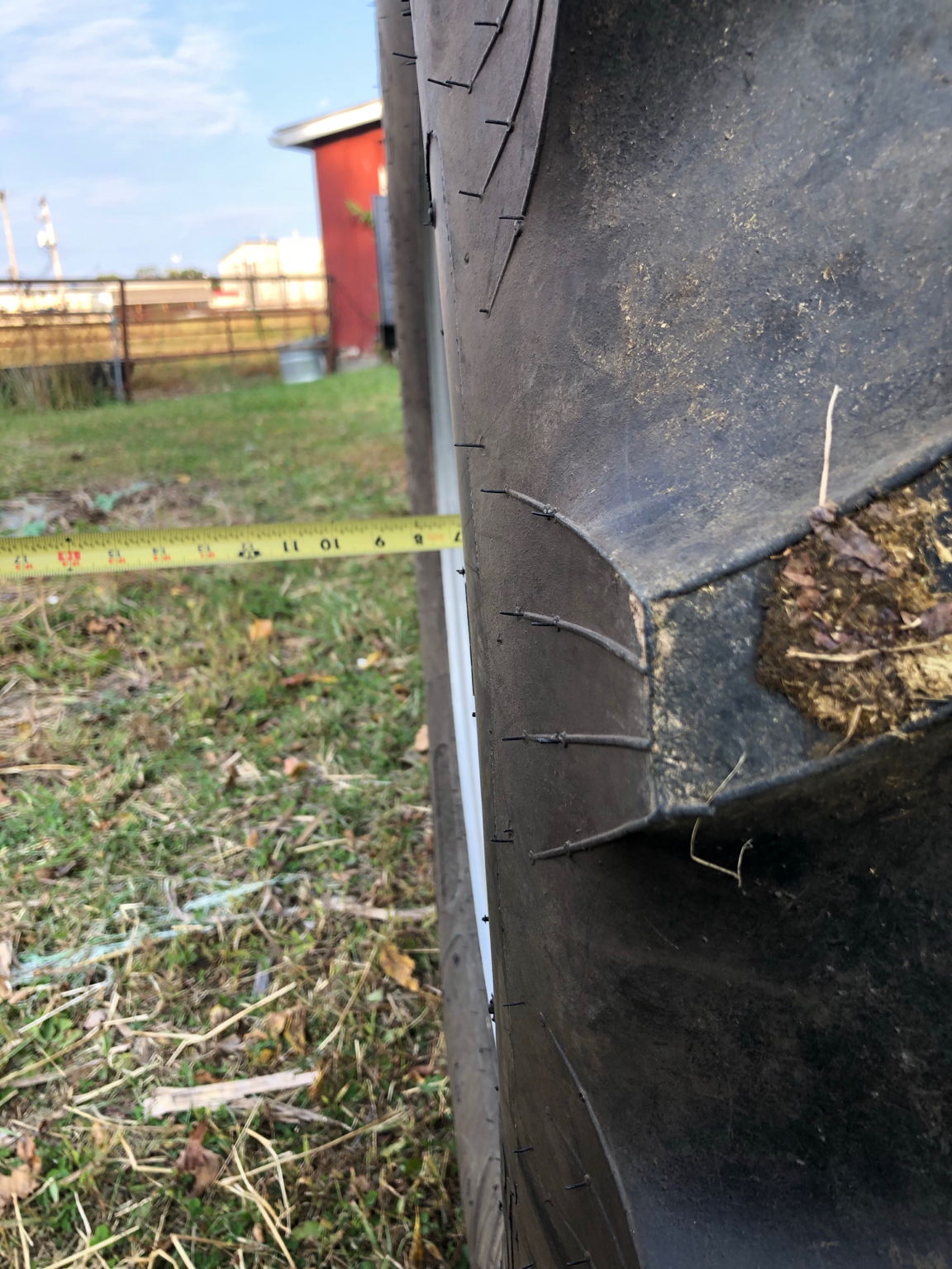

Yes, that is exactly what I am talking about. I was bush hogging a property years ago with beet juice filled tires. Ran over a metal t post while crossing onto customers driveway and opened up a tire like I open up a deer I just bow hunted. The smelly mess ran out all over on the lawn and driveway. Before I was out of the tractor, I had a 34” rim/tire on the ground and probably a drum of beet juice everywhere. It killed the grass. Customers dogs running around in it, too. :confused2: I know they say it doesnt, but this beet juice was hot from summer temps and killed the grass. It also stained the driveway. Customer was furious.

This was a 10” gash. A football wouldnt have plugged it. :laughing:

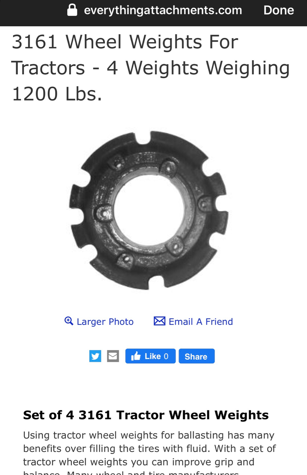

I made my mind up on a cutter bar and 300lb wheel weights for the rear. One weight per wheel. It’s not a bunch but will help ballast loader work and traction. Don’t want to go much more weight because I won’t be able to haul the thing lol. Adding 600lbs of weights will put me at 8600lb just the tractor.
Still waiting to hear back if local dealer can beat EA prices, he said he buys them out of Carolinas and has them shipped to him so I’m figuring price will be about the same. EA is middleman or local dealer the middleman lol.

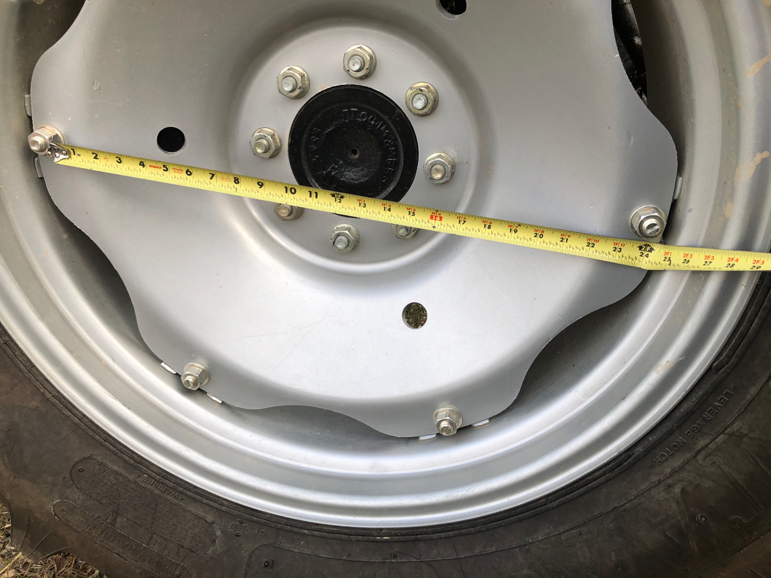

At around 80in wide tractor is loads more stable than my last one. I think the extra 600lbs on the rear will be perfect for what I’m doing with it. I think two weights on each wheel would stick out too wide from the rear wheel, each weight is 5 1/2in wide. From stud to even with rubber is about 7 1/2in. IMG_6751.JPGIMG_6754.JPG
8600lb 55hp Tractor is pretty heavy. Mahindra really builds a heavy tractor.
I don’t see where Mahindra suggests more ballast, I’ll have to poke around my books when I get a min.
That JD compact I had, JD suggested over 2000lbs of rear ballast on a 4300lb tractor/loader without cab. I had around 600lbs of 3pt ballast which lifted the rear end of that tractor often, way too light.
