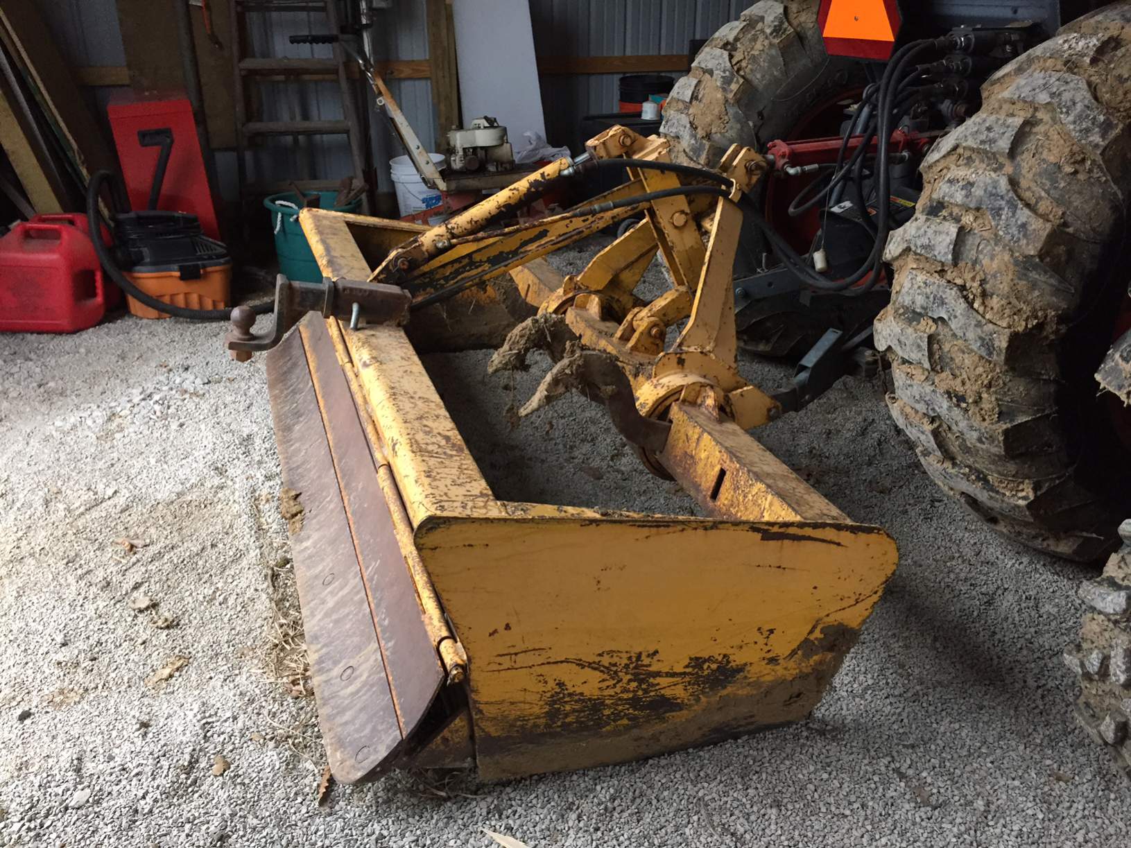

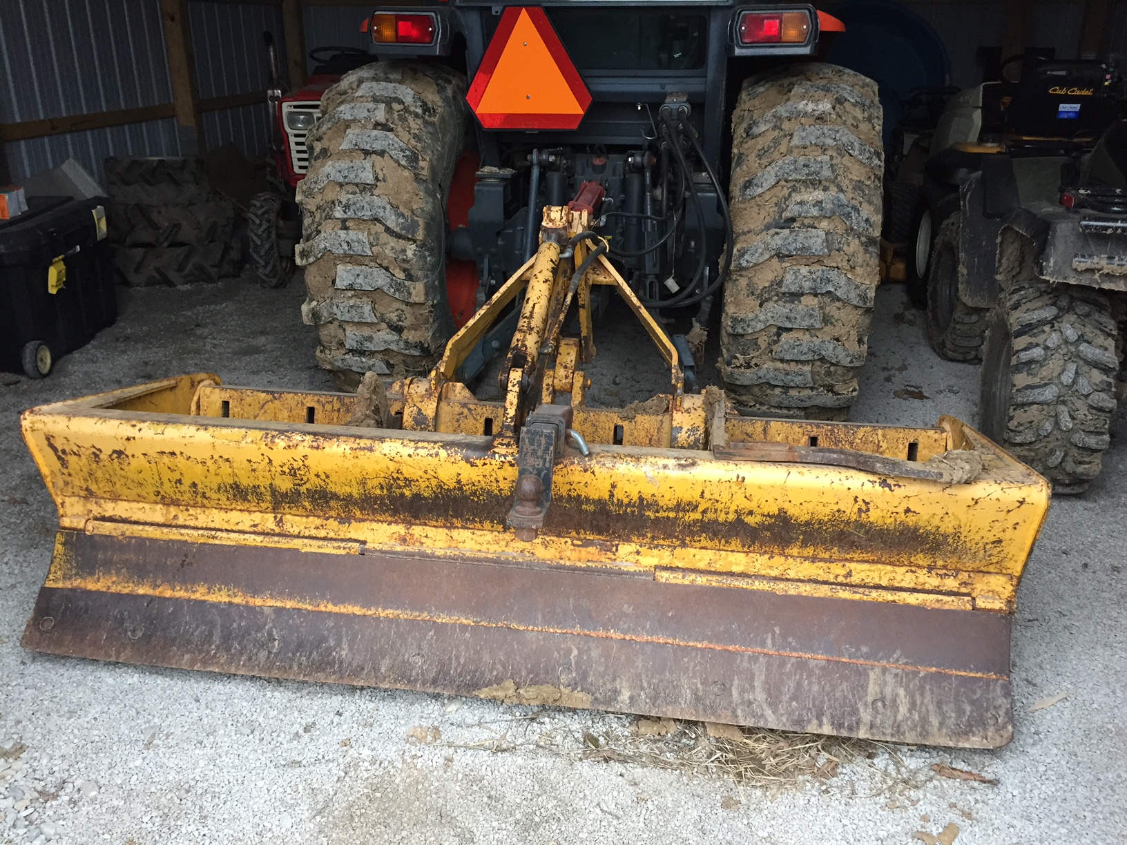

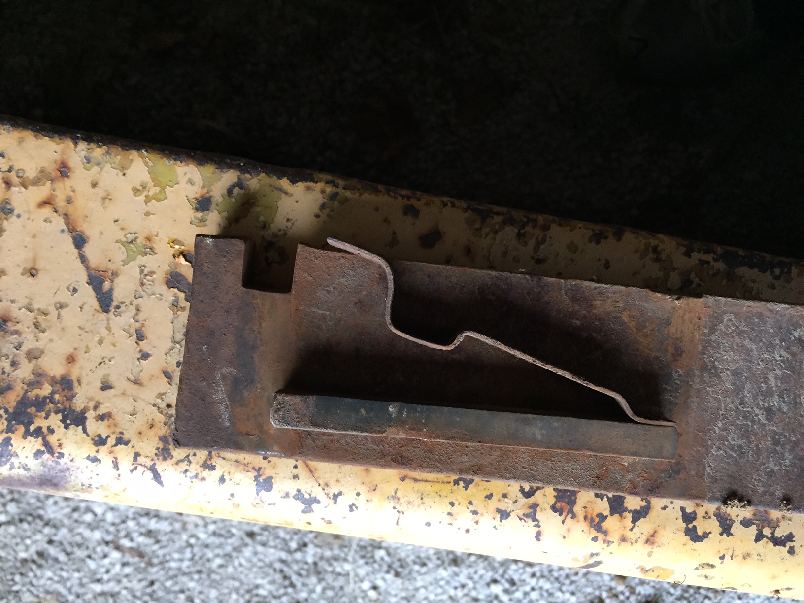

This box blade came with a tractor I bought and I don't know the make or model of it? Can't find any markings on it. It only has 3 ripper shanks in it now but came with more and I can't put the others in because it needs these little clips... So I'm really needing to know where I can find these clips at.

I have no idea what make and model that is, but you should be able to get clips that will work for you from a Woods dealer. Gannon box blades have a similar clip.
   / What Box Blade is This??? #3
Or if you are a novice fabricator you could make some that would work. There's no load on the clip. All it's gotta do is hold the shank into it's slot. Since your shanks roll, the clip would have to fasten in somehow so it would fall out. With a little thought it would be simple to rig up something.
Where are you going to get shanks that are slotted like that?? All of them I've saw at my local stores have pin holes thru them.

Shanks with the slots are no problem, but curved like what he has, he may have to get some made???
I've got the extra shanks... I just need the clips. I wonder if these would work. CLIP FOR RIPPER SHANK
