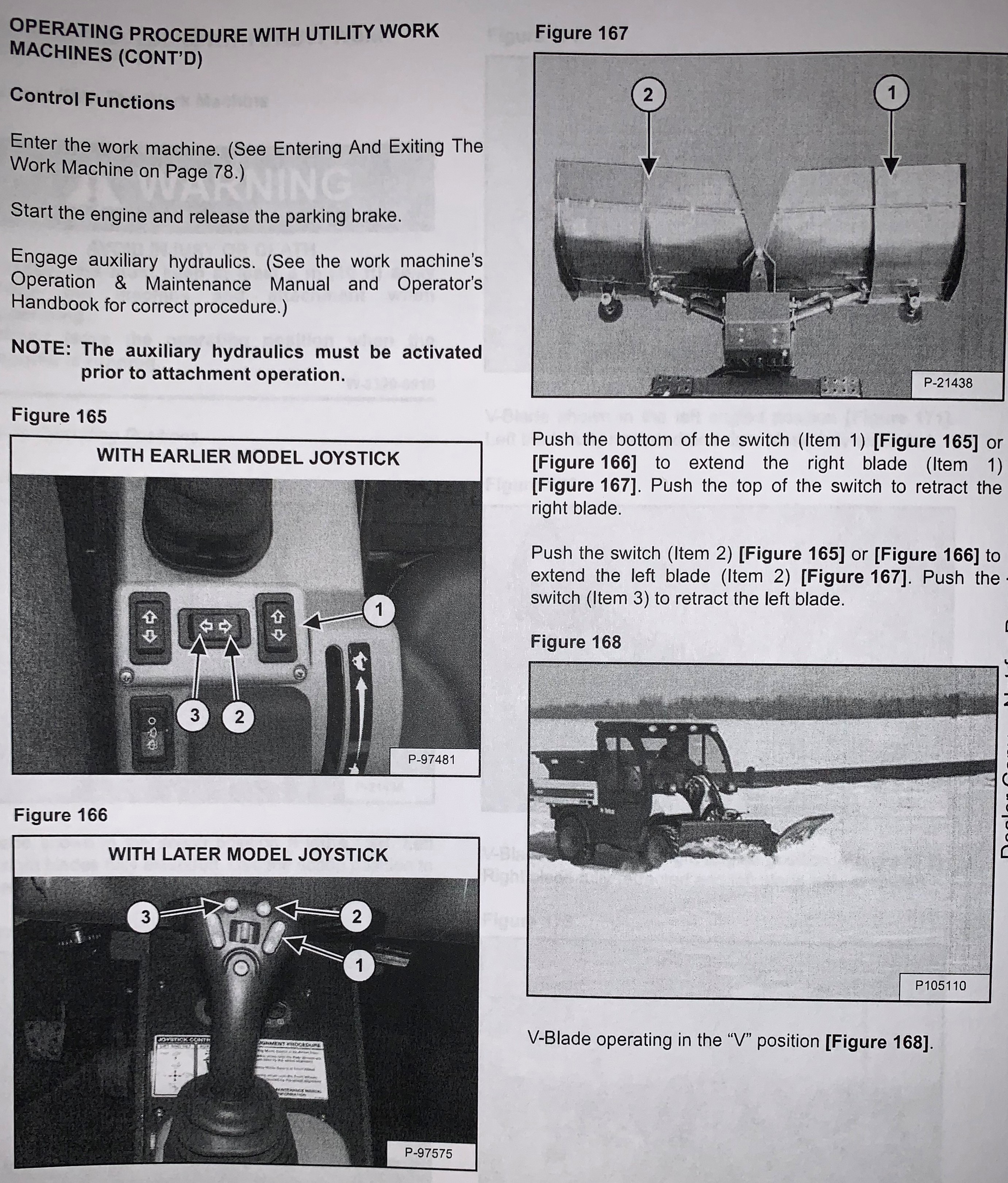

Recently bought a new 2019 Toolcat 5600 and received my Bobcat branded V-Plow a month later. My question is What controls on the joystick are supposed to run the angling? On mine the right wing can be controlled by the right cylinder icon or thumb toggle. The left wing is controlled by the top left and right arrows. To me the left wing should be controlled by the left cylinder icon. Are there different circuit boards for the Toolcat than the skid steers or track loaders? Could I have received the wrong plow if that痴 the case? Also my remote hydraulics fuse was missing from my Toolcat when I received it from the dealer, which seems odd to say the least.
   / What controls are supposed to run the V-plow? #2
I have a new 2019 ToolCat 5610 with the Bobcat 96" V-Plow, and the joystick controls are just like yours, which is just like the manual states (see attached photo). Agreed, it's not intuitive and I fumble around looking for the controls. The manual also explains the joystick controls for skid-steers, but they have two joysticks (left and right) with a thumb toggle on each - the left controls the left wing, the right controls the right wing.
Side note - do you find the controls (wing movement) to be extremely slow? I'm always waiting on it to reposition before continuing to plow.
Awesome, so my controls are correct. Just so you know I didn’t receive any manual with my attachment. My wing movement is really slow as well but from a couple videos I watched that seems to be the norm.

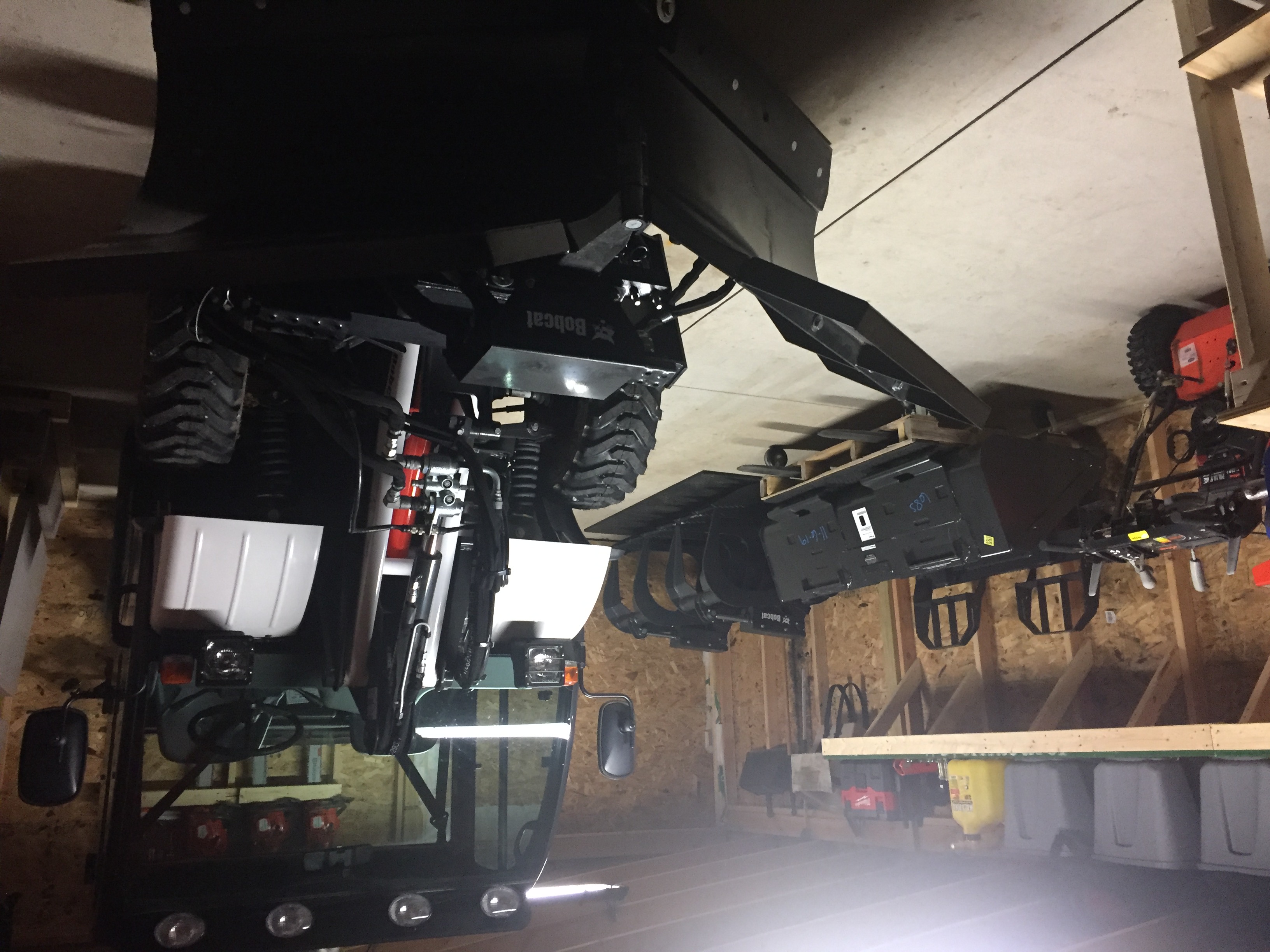

I finally received all of my attachments and even got the manuals for the plow and grapple. 4E62156A-749C-48F6-BDDD-9DA37EFE2B56.jpeg
