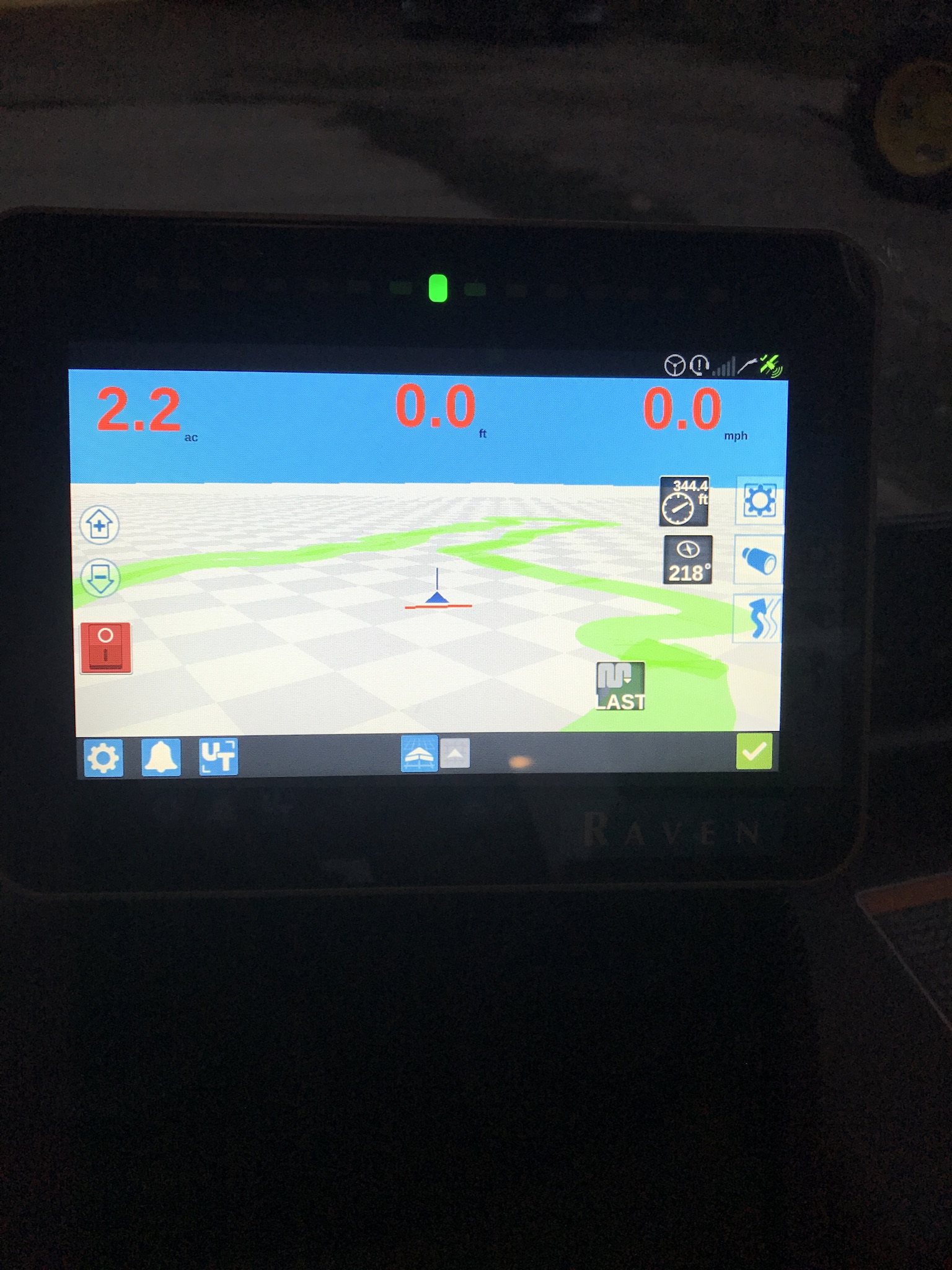

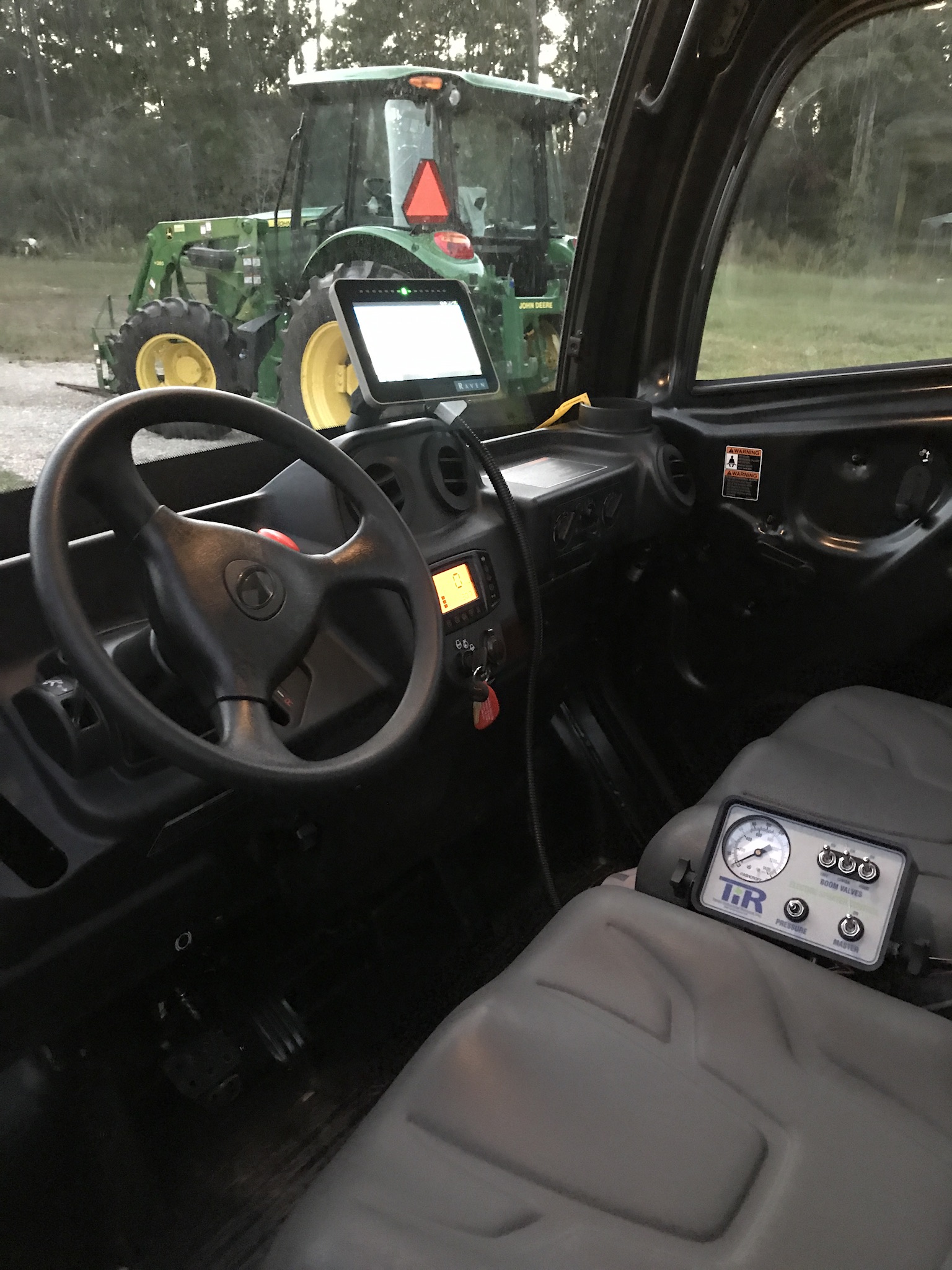

Brett, I'm interested in what and how you are using gps. Thanks
   / What do I need to make a tank sprayer into a pasture sprayer #9
I bought a raven cr7. I have it set to my boom width and wired into my boom control box. When I turn it on, it will begin painting what I致e done and figure the next path along the A/B line. Works great and helps me accurately determine how large the fields I spray are.

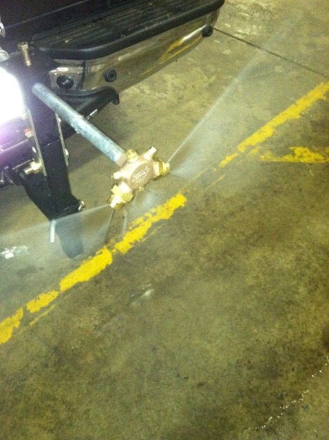

Here’s my sprayer running off of a 12 V battery. It uses a T jet head from Tractor Supply. I’ll try to find the part number. I do remember it was about $100. Works great. It covers about 30 feet. I can spray 275 gallons in a few hours. IMG_0906.JPGIMG_0905.JPG
