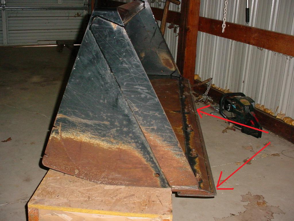

Is it necessary to remove your old cutting edge to install the tooth bar or does the the tooth bar fit over the cutting edge?

Soil is an assortment of materials-clay, hard pan, rocks of all sizes, etc..
Would like to get a bar that does the job without spending a whole lot of cash.
