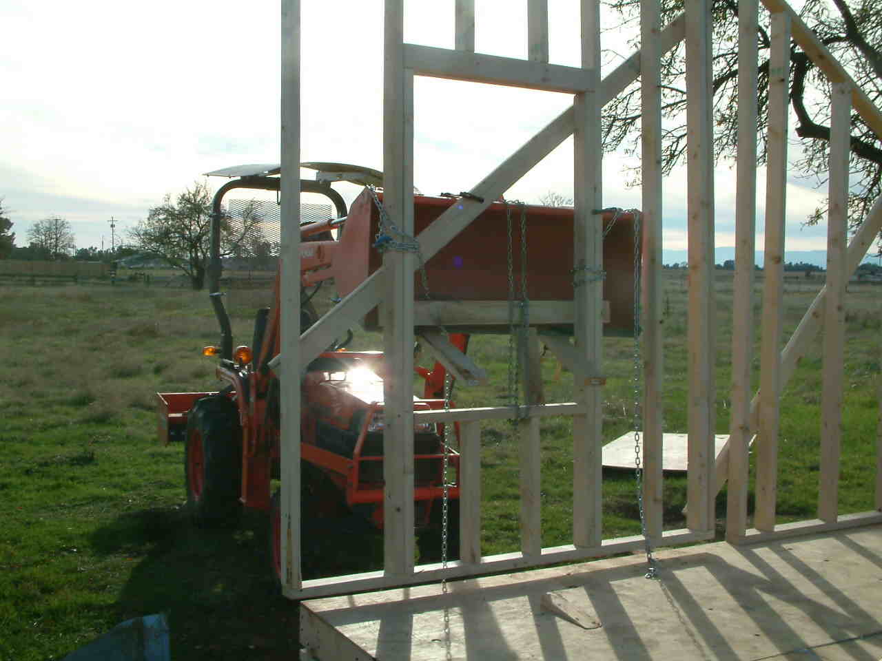

I have 10 acres, flat, grass, 3/4 lawn, 30 almond trees, 260 feet of gravel driveway. Last May I bought a 21 HP Kubota B7510HST with LA302 FEL and ag tires for $12,600 plus tax ($10,000 for the tractor, $2600 for the FEL). Deal was 10% down, 0% APR for 36 months. Don't know what kind of financing incentives Kubota is offering now, but that's easy to find out.
I added a King Kutter (KK) 48" brush hog rotary mower ($675 at Tractor Supply Co. (TSC)), a 48" KK box blade $375 at TSC, a KK middle buster (potato plow)/subsoiler from TSC for $135, a used Yanmar RS1200 rototiller ($300 from my local grey market tractor guy) and a Markham toothbar for the FEL ($173 + $50 UPS from North Carolina to No. CA).
If you're serious about your tractorin', you'll probably go a similar route buying a top of the line new tractor (under warranty, no major and unforseen maintenance headaches, lotsa resale value) and then adding a bunch of implements. My setup appears to be within your $$ pain threshold.
I'm building a couple of salt box sheds on my parcel. Here's one of the things you can do with an FEL with chain hooks (installed gratis by my Bota dealer), see attachment.
