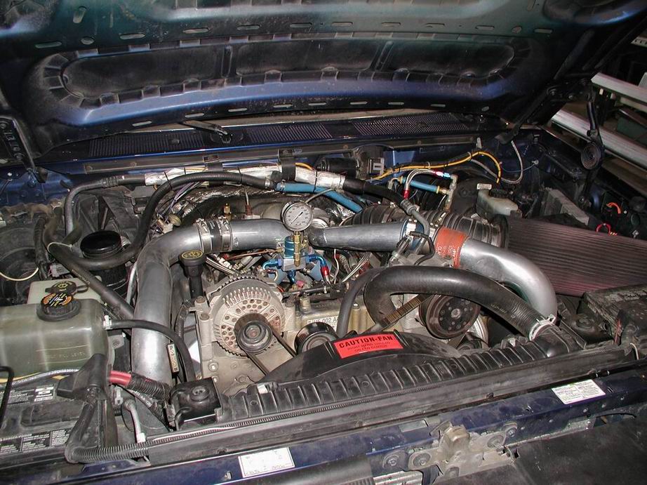

As far as I know, Navistar will be supplying the new 6.0 liter PSD to Ford for quite a while. It is mated to the new 5 speed auto (5R110).
The Cummins engine is easier and cheaper to get HP and torque out of. I have only been able to get 450 RWHP w/ help from LPG injection out of my PSD where some of my buddies are getting 500+ Hp on just #2 diesel.
