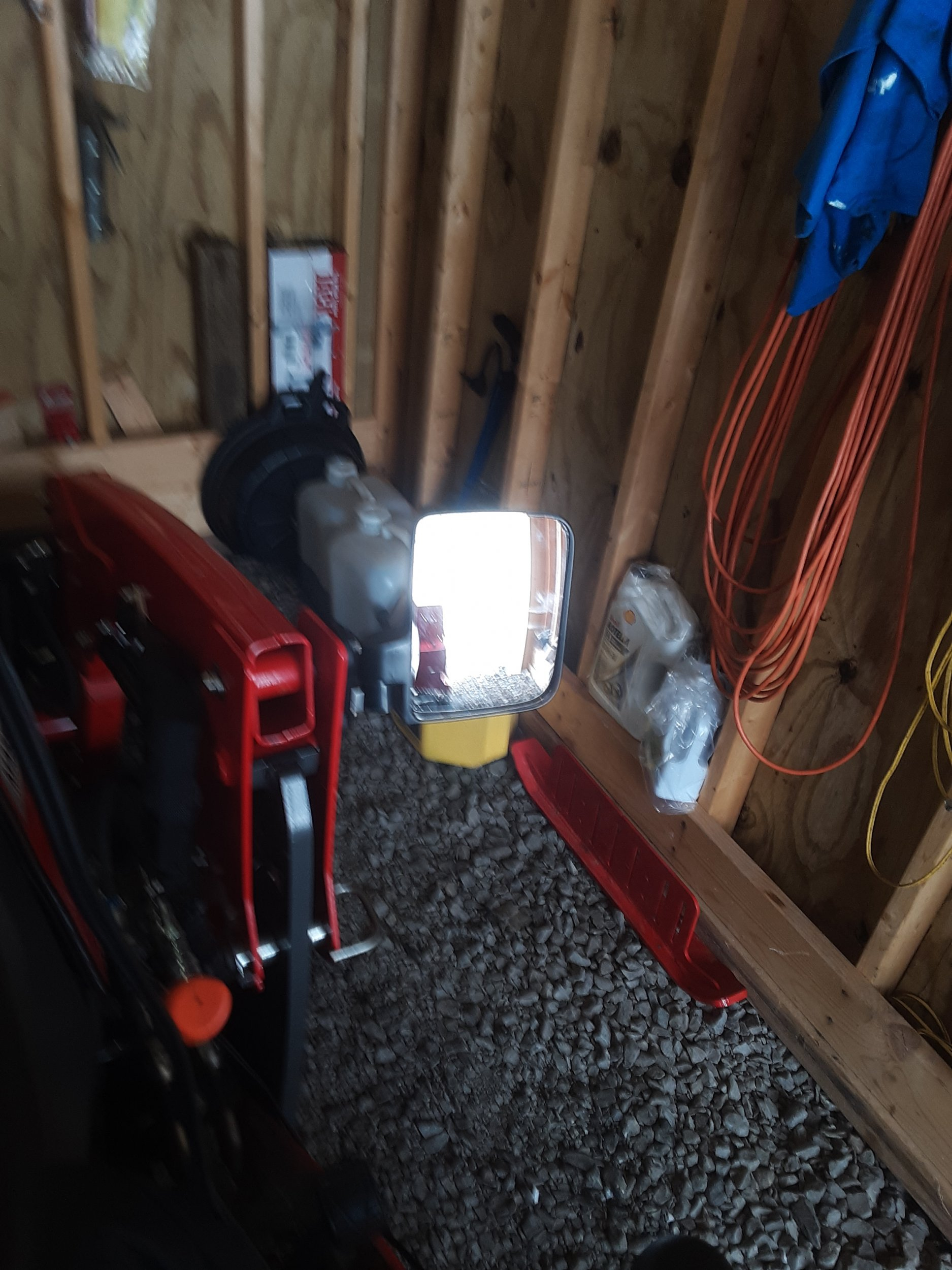

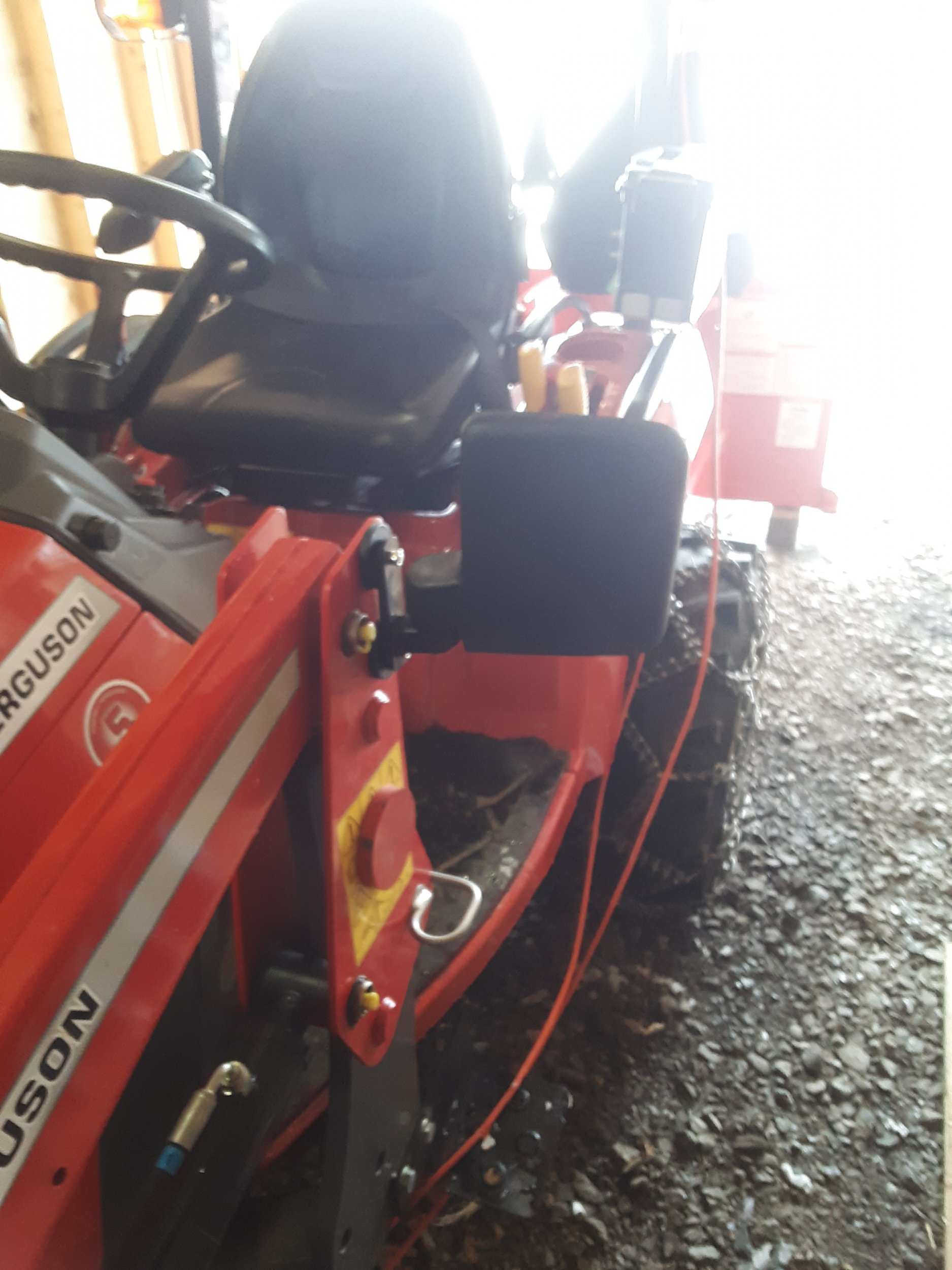

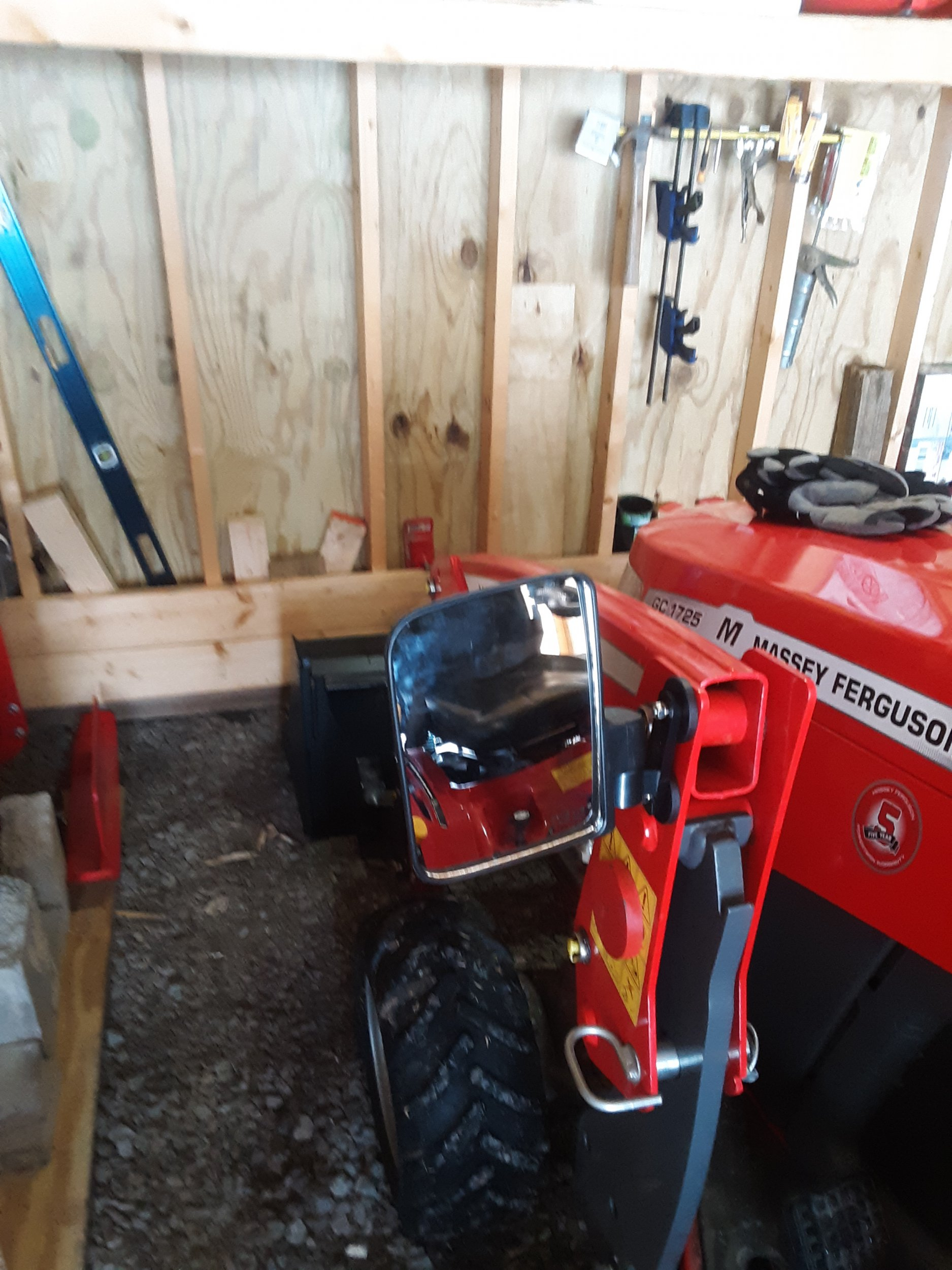

I got a few neighbors (GC1723 loader only, GC1723TLB, and GC1725M TLB) that would be interested in your findings.
the MF1532 with the L100 loader getting same items I just did on my GC2400 DL100 bucket.
The main reason I did not look at magnet mounted mirrors it that there did not appear to be enough flat real-estate near the top of the FEL to put the magnets.
Someone else saying that mounted some with magnets made me do some more looking.
Anyway I started with a search for magnetic mounted mirrors and that led me to find forklift mirrors. Looking more into forklift mirrors soehow got me results for golf cart mirrors and I found these.
These things are only about $10, I figured I didn't have much to loose and wasn't expecting much. I like these because of the flat mount and the mounting holes are easy to get to.
I then found the mounts
$17, more expensive than the mirrors, but figured that I could use them for something else if the mirrors did not work out.
Got them and put the on today. They give good visibility from what I could see sitting on the tractor in the shed. They seem to hold well. Next step will be to see how they stand up to the vibrating tractor. It's only 15F here today, I wasn't going to start it up just to test out the mirrors.

Considering how cheap the mirrors are they seem pretty sturdy. They are made from polypropylene which is a fairly strong plastic, same stuff they may batteries cases of. As far as the magnets go, I got the stronger of the two options I found. I really had to put my weight into it to position them, I doubt they're gonna rattle off.

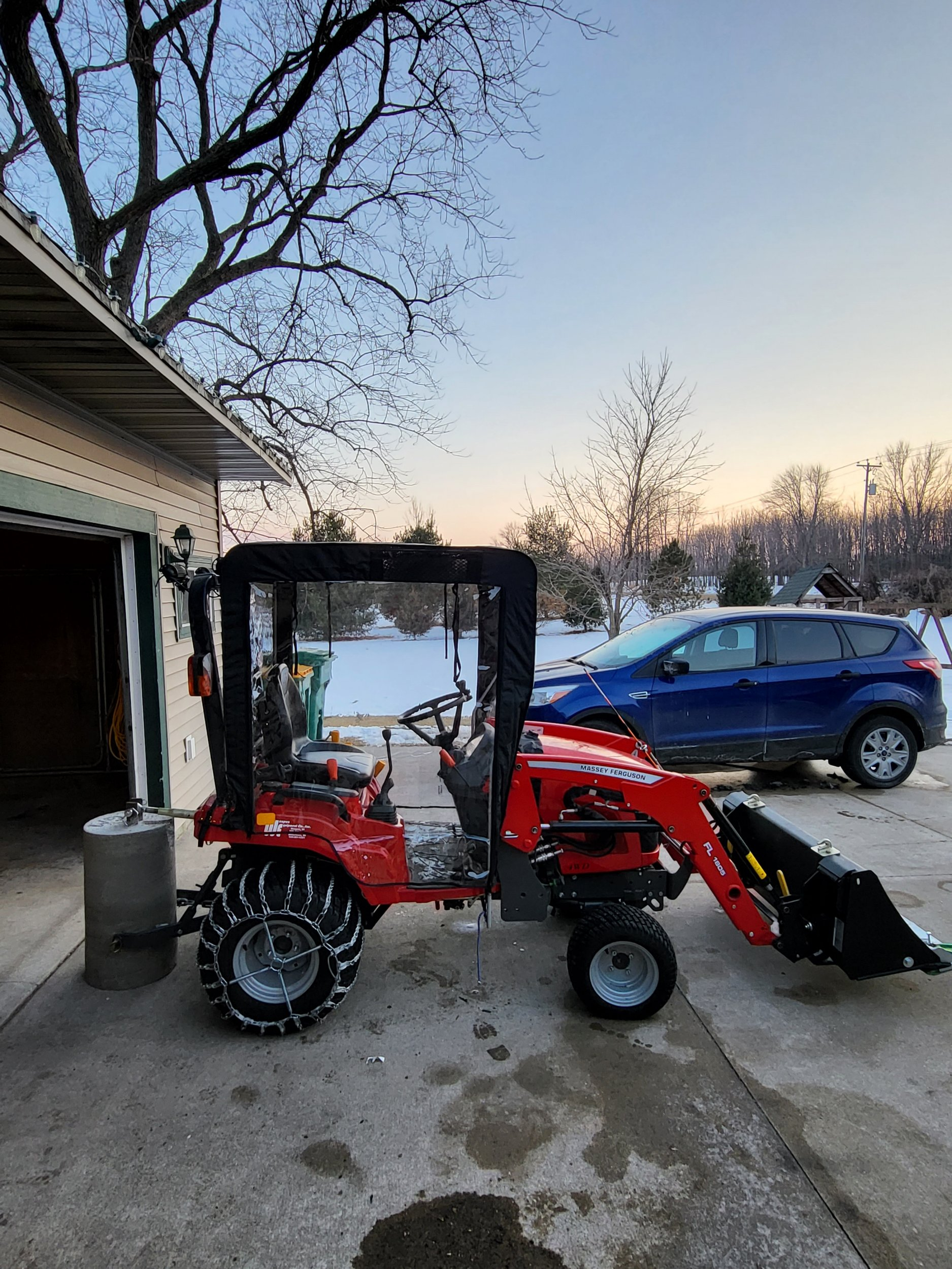

what cab is that?
   / What have you done with/to your GC Series 2300, 2400, 1700 Tractor TODAY #1,257
what cab is that?
Berco 40" 700423-2 I had to modify the mounting brackets quite a bit, but it turned out ok. Made some brackets to move the led's on the rops to the front of the cab, but haven't put them on yet.

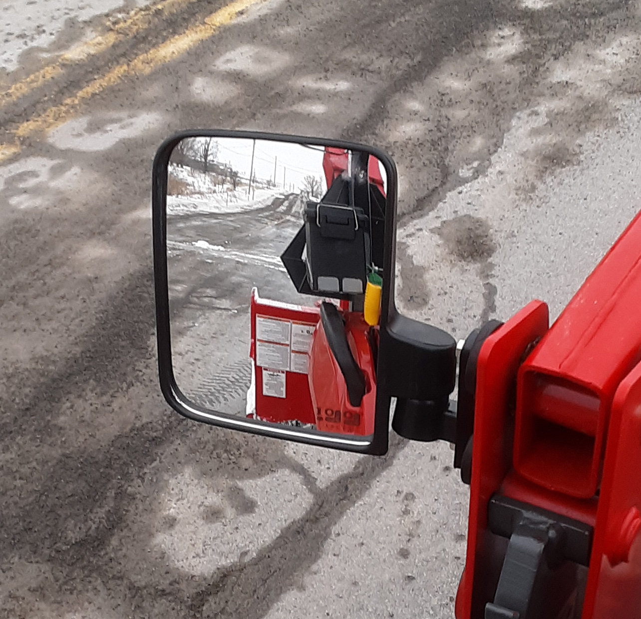

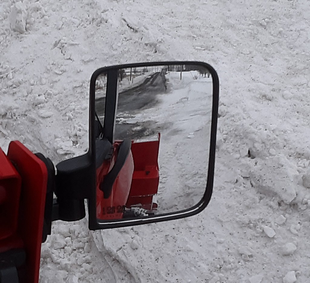

Had to go our yesterday to move snow. Hasn't snowed here in a week or more by the wind decided to dump a 3' drift across my entire 150' driveway so I was able to see how the mirrors work.
I like them. The magnets did not move and the swivel adjustments on the mirrors did not move. They just stayed where I put them. Ran the tractor for 2 hours. Also not much vibration, at least not with the engine at 3K RPM for running the blower, you can see in the images that the view is not blurred from vibration. I did my best to give the mirror view from the seat. I was on the street when I took them.

nice. I am gonna look into seeing if I can make these work with "taller" mirrors for the newer gc stuff I deal with to due using backhoes, tillers,box blades,rear scrapers, bush hogs. in colder weather if they stick I am happy.
the gc2400/dl100 and MF1532/L100 tractor/fel I deal with most often work well with what I did but....the others....not so much LOL
the mirrors I got I can see quite a bit more and where 2 of the people I deal with are in late 60s early 70s if I can give them the extra view that helps. if I can't I'll set this setup for them.
edit: mine are 7 wide x 12 tall (vs 5.5 wide and 7.1 tall) and sometimes that makes huge difference to us disabled people LOL example I can see few inches below my blower (and then tiller) bottom and up to well past my blinkers on ROPS
from pics you had to use 4 magnets correct? just getting ducks in a row on this end.
   / What have you done with/to your GC Series 2300, 2400, 1700 Tractor TODAY #1,260
Yep, the ones I ordered come in a set of 4.

One thing they don't work for. Like I said I was moving 3' of drifted in snow. I could only take half a bite with the blower at a time. Stuff was like blowing cement and would actually cause the tractor to twist into the snow, nasty work, had to pull forward and get realigned at times. I ended up using the diff lock to keep me moving in a straight line. Still had to turn look back from time to time to make sure I was was lining up the snow edge with the middle of the blower.
I'm happy with the size and what I can see, which is a whole lot more than I could see last week without turning my head.
