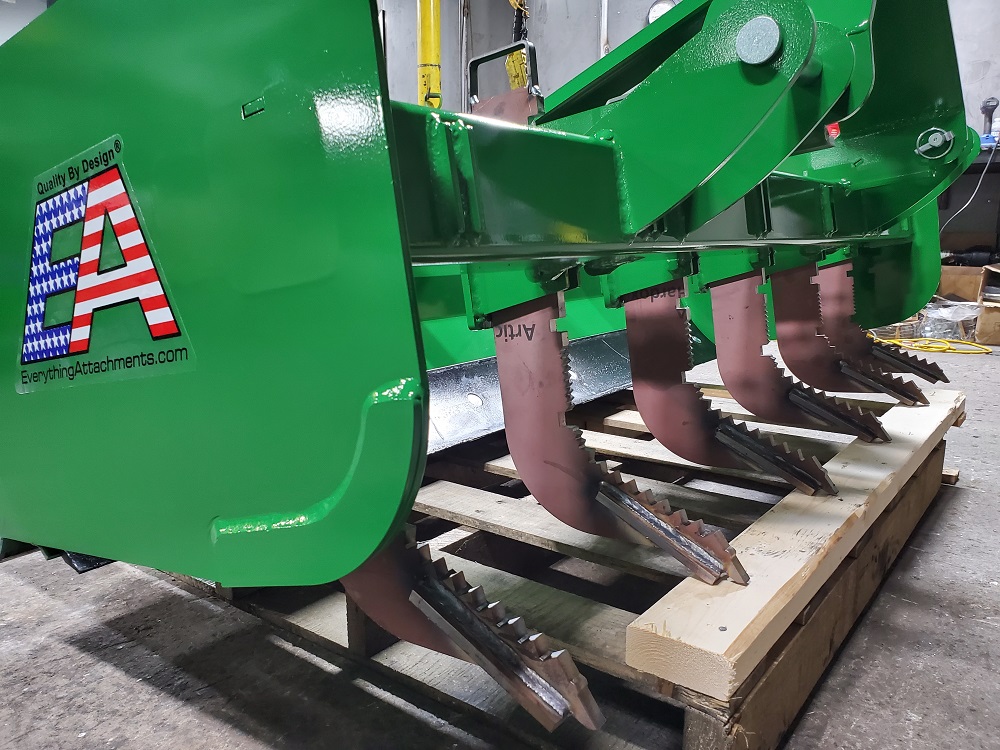

Here's a ripping boxblade unlike any other. It features patent pending 100% AR450 Hardox steel, easy adjust ripper shanks.
Wicked, they say!
