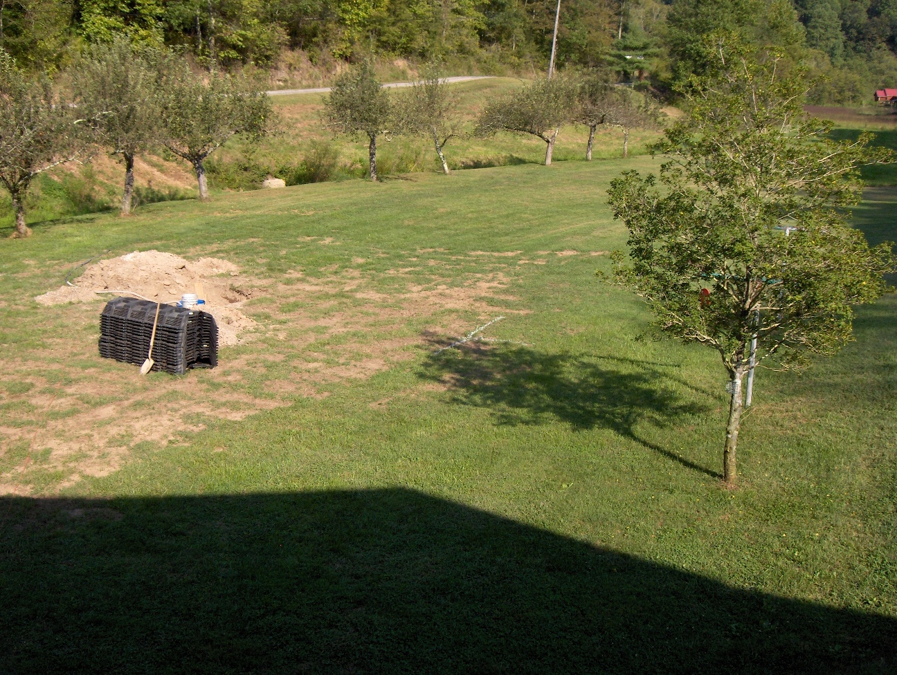

I decided to add on some and give it a try and when I did I made a distribution box to monitor whether the new system was taking the overflow or not. Here is a pic of the add on field before I started.

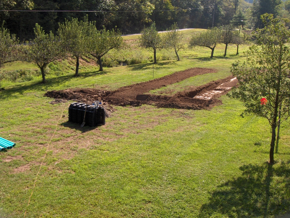

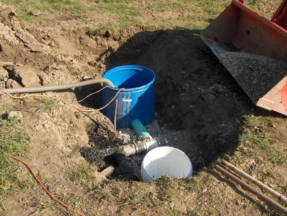

2 years ago I had a problem with the downstairs commode not flushing well. I dug up the access lid and checked the tank (it had never been pumped out and it had been for over 20 years). It wasn't full but I decided to pump it out. come to find out the exit pipe had sheared and dropped down enough to let the slightest thing plug the exit to the tank. When all of this was going on I dug up and inspected the field tile in several places and it was clear. My children are using more water and washing more clothes and I suspect the system can't handle as much as it used to. Here is the first step for me was to put in a distribution box(Blue poly barrel) to have someplace to pump the old system from. I diverted the gray water to a field past where I was working.

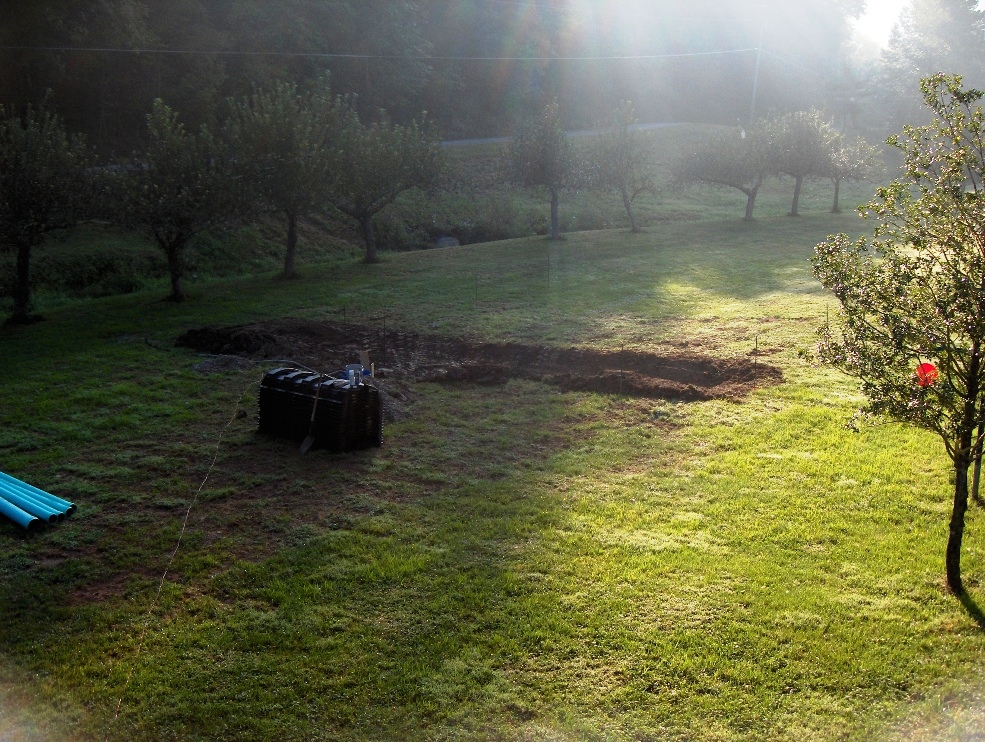

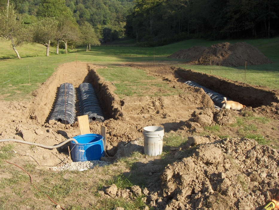

I really have not had a problem with the tank I think the leach bed is a little undersized but was put in according to our county regulations. I do not like having poo problems. Here is the next step in my process of rectifying the leach bed problem it may be overkill but I would rather be safe than sorry. I put the 6 foot tiller on the Kubota and started working on the trenches. Before I started I set up some grade stakes of rebar with a rotary laser.
Then I used the FEL and made a trench in the front of where the ends would start and I didnt want to go to deep as I was afraid that when the soil settled it would settle the pipe with it.

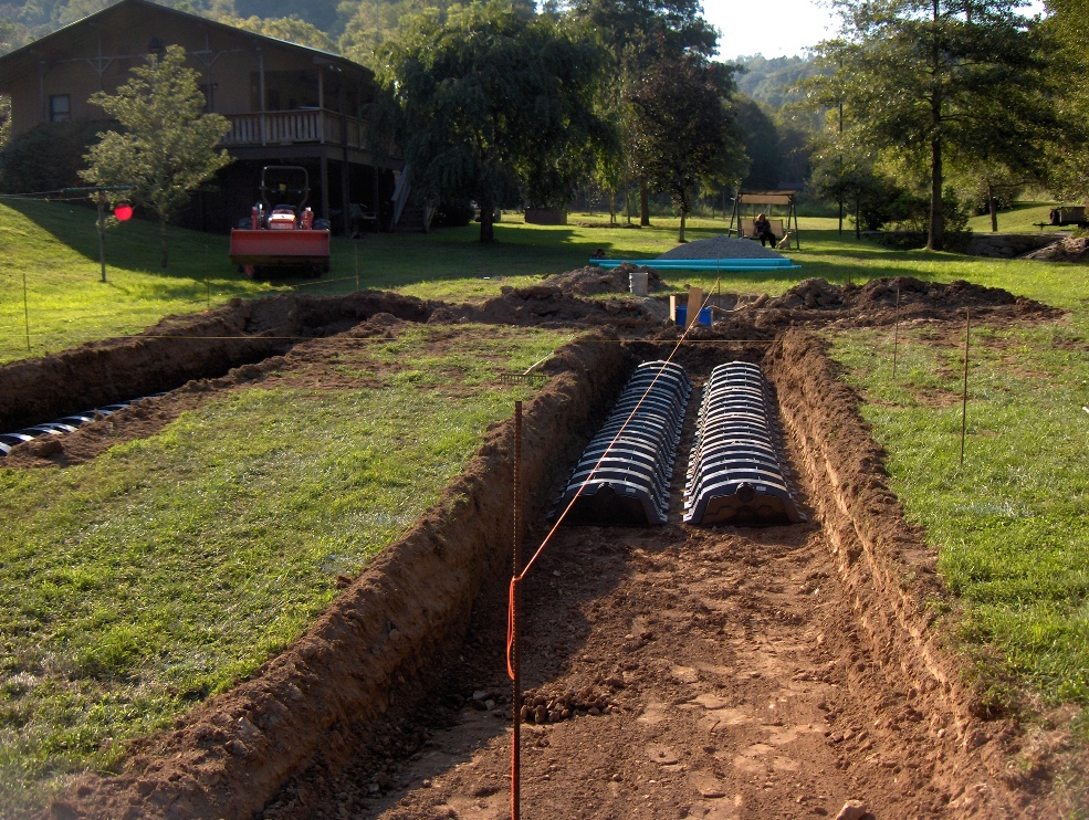

I used the no gravel type of leach field called Bio diffusers and I figured this would be plenty of additional leach field to solve my problem and here are how they lay in the bed.
