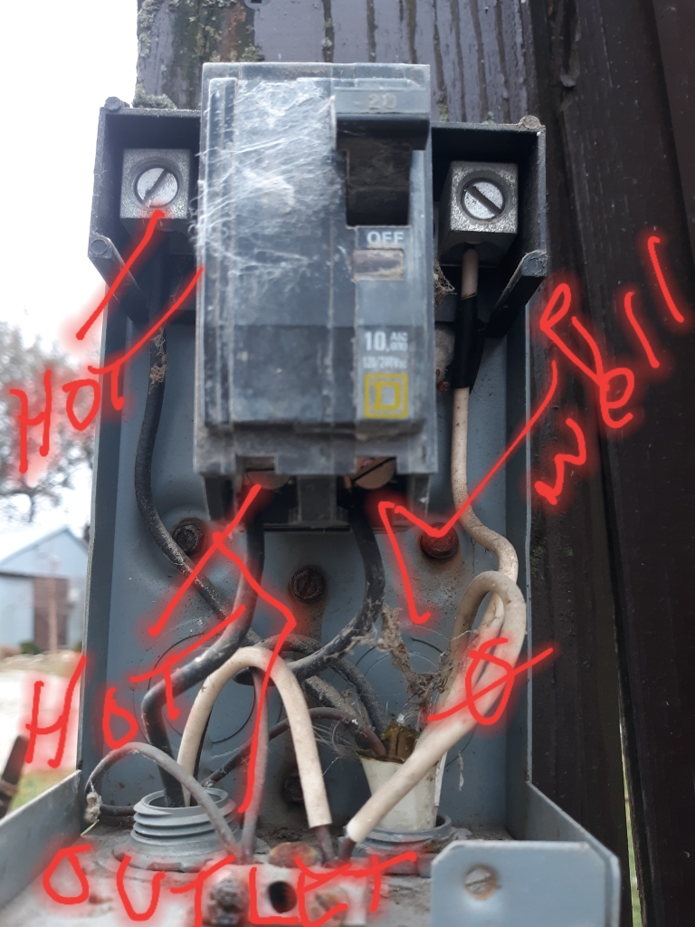

Sorry but I guess I posted somewhat of a trick question. If both wires brought out came from L1, you have just wired a 120v circuit not a 240v one. That逞エ the crux of my post on not worrying about picking 2 out of phase hots for a single phase 240v run.
In other words, you can稚 get your 240v any other way.....
Yes, you'd have (qty =2) 120v circuits, BUT! Don't run a single neutral for the combined current on L1 & L2. In the situation you describe, you'd be best running a separate neutral for each hot wire.

Incorrect, IF you feed 20 amps of 240v from a double breaker into a 12/3 wire it has 240v from red (hot) to black (hot) and 120v from red or black to white (neutral).
As long as all three wires are 12 gauge that is legal and you can get 120v or 240v out of it.
If you have 12 amps from black to white and 6 Amps from red to white, the white will only be carrying 6 Amps back to the panel.

What you say is correct, but you misunderstood my comment. Mine was in reply to using 2 single breakers, (which could be on the same phase - or not). If they are not on the same phase (meaning adjacent slots in the panel) then whether you use 2 single breakers (or an even number of spaces between them) or a double breaker, you'll end up with what you describe. However, it the two single breakers have a space (actually an odd number of spaces) between them you only have 2 - 120 v circuits.
The original comment I was replying to was
... If both wires brought out came from L1 ...
which puts both lines on single breakers with a space between them. Your reply is correct for one wire on L1 and the other wire on L2.
