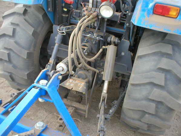

Hydraulic adjustments for the 3 point hitch.
These should be a factory option in my opinion. Yet it is typically taken care of by the dealer or owner. Once you have them, you would never go back to manual adjustment.
You've sure got that right.;) It was handy for a lot of things, but just wonderful when using the box blade.

Thanks for the picture - it shows all. I think it may be an option on some new Kubotas.
Great lloking photo--what brand is yours? What size tractor is it on?
