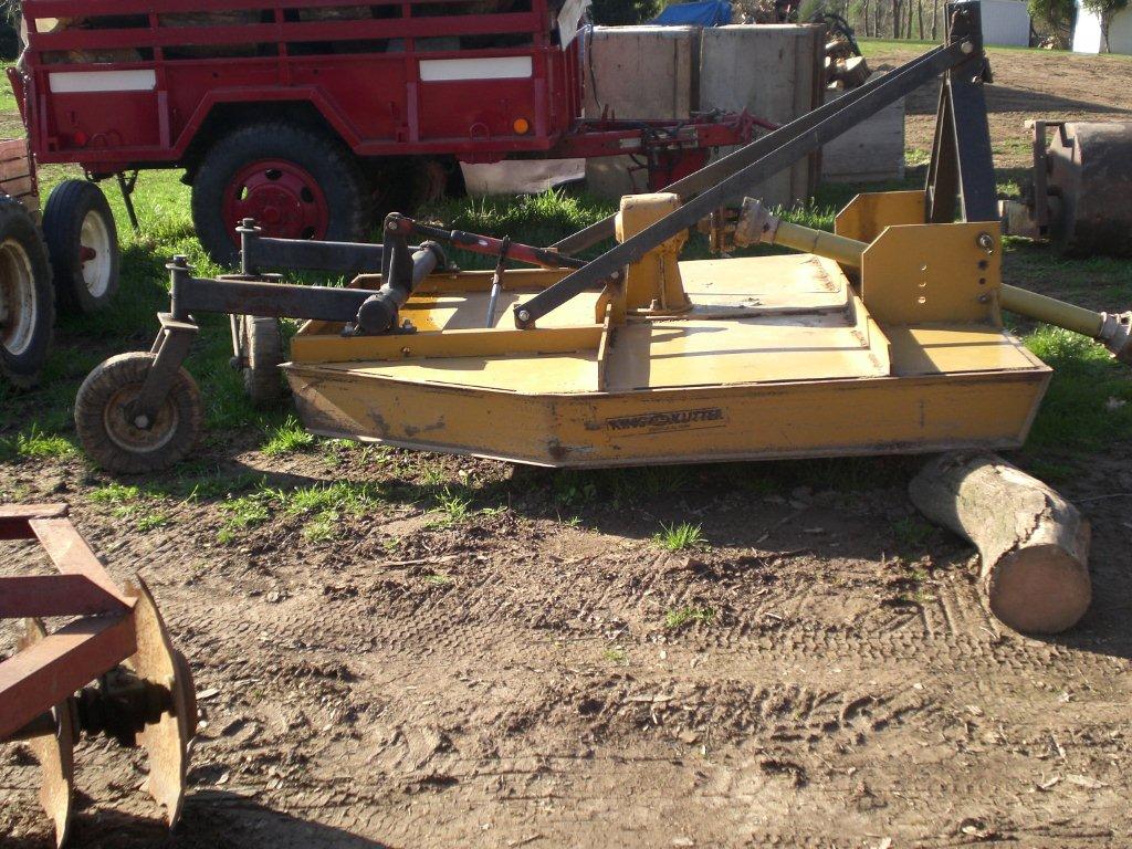

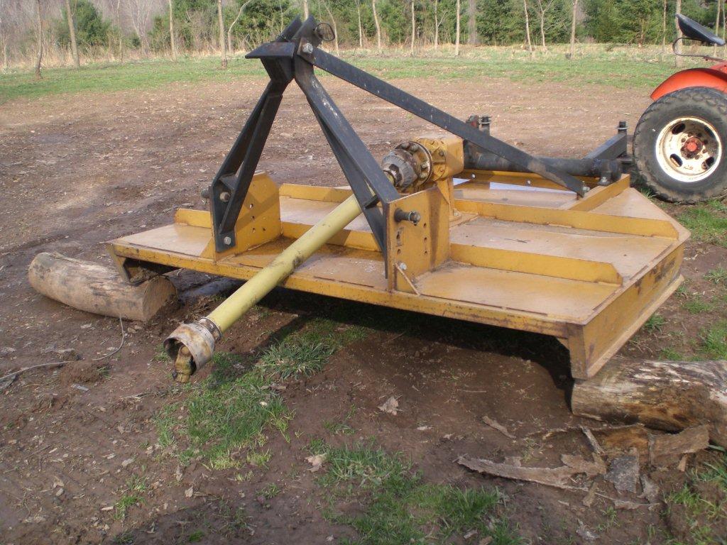

Got pictures of the 7' that the guy is selling for $1700:
Looks pretty nice.

Picture of yellow cutter is medium duty unit, probably sufficient for needs of the OP.
Regarding twins for 7 footer being easier on tractor... maybe so but not for stated reason. The moment is greater for a longer blade and if you abruptly dump the clutch you will cause more wear with heavier longer blades. Twins don't cut blade length in half due to overlap and aren't all that much less of a load.
To cut effectively there is a minimum blade speed (not RPM) but equivalent straight line speed to get good cutting action. To achieve this speed near the hub/stump jumper) you will, of course, exceed the min required at the blade tips. This excess speed translates to imparting more momentum to the cut material. This is an energy sink which siphons off HP to move grass faster than needed after it is cut and isn't a particular benefit. Aerodynamic drag goes up and wastes HP too.
Since drag goes up with the 3rd power of speed (double the speed and it takes 8 times the HP) long single blades take more HP than a pair of shorter blades (usually) assuming not more overlap than needed. ...and then there is mechanical train losses from the gearbox arrangement, another set of rotating bearings, and so on.
Anyway there are trade offs, 4 blades to sharpen and balance vice two, more bearings, more expensive gearbox and mechanical drive components, less reliability...
Pat
