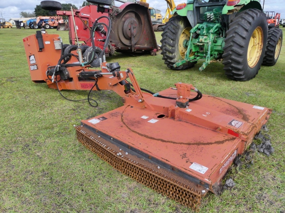

I've got the J Bar Scorpion rotary cutter with four gauge wheels. The link is for their finish mower but the guage wheel setup shows better in this picture. The square stock arm pivots on the rear pin and moving the forward pin adjusts the height. The wheel is held by a tube with an ID just a little more than the OD of the wheel riser. A simple U-shaped piece of steel holds the assembly to the square stock.
