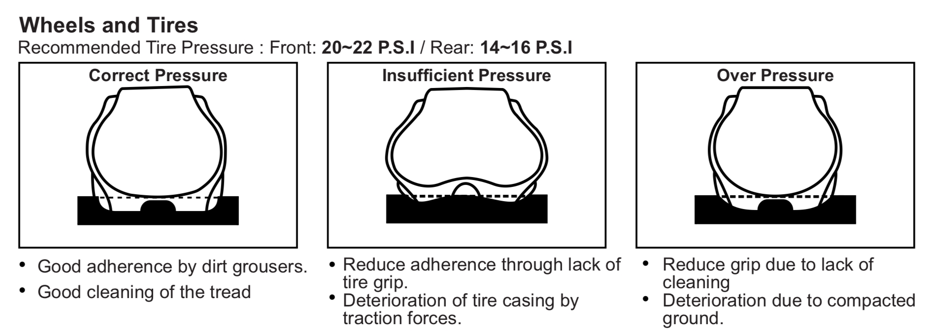

The Summit manual recommends the following tire pressure settings:
FRONT 20-22psi
REAR 14-16psi
My TX25 arrived with ~30psi in the rear. I’ve been running ~25.
What tire pressure are you maintaining?

Wow, I don't have a Summit tractor yet but I will. Somebody really pumped the rears up way too high on your tractor. I have a CC/Yanmar and mine stays about 15-18 psi. More than that and it becomes noticeable when driving across my rough yard. This is just my opinion but I think it does spin the R-4 tires much more easily in an uphill turn or something similar. I keep mine a little on the soft side and if I need to carry something like the tiller or a wood chipper, I'll put a little more air in them.

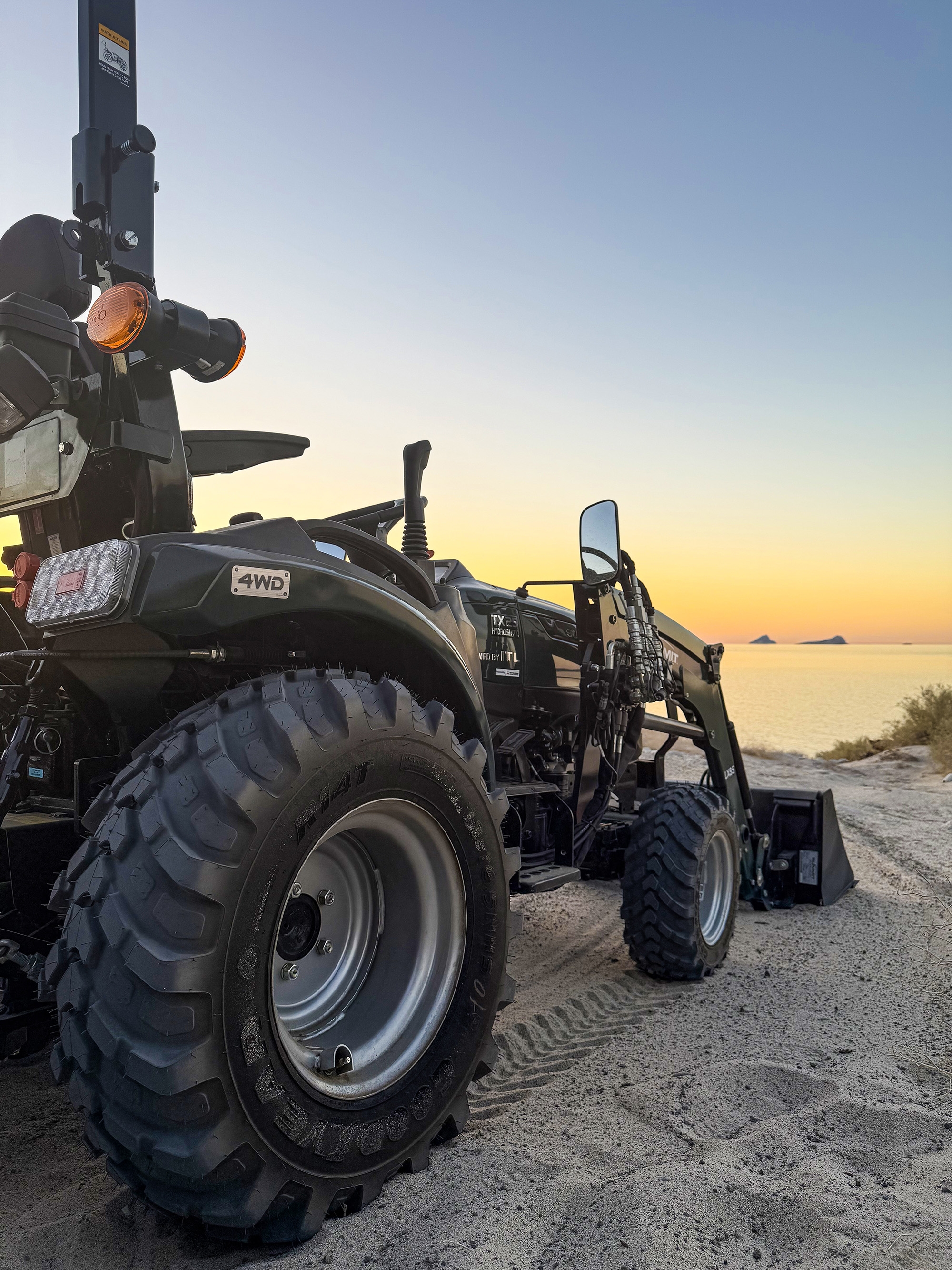

I am operating 90% of the time in soft beach sand.
I have the fronts at 20 psi and the rears a little over 20 psi. They were around 40 psi when the tractor was delivered. The traction is better now, but not great. I am learning the advantages of moving very slowly in deep sand...
I want to get the rears down to 14 psi but there is a lot of Rim Guard. It seems like a little overfill. So much comes out even with the valves exactly at 12 o'clock. I think I will drain about a half gallon from each tire to get it further below the valve to make it less messy and then take them down to 14 psi.
