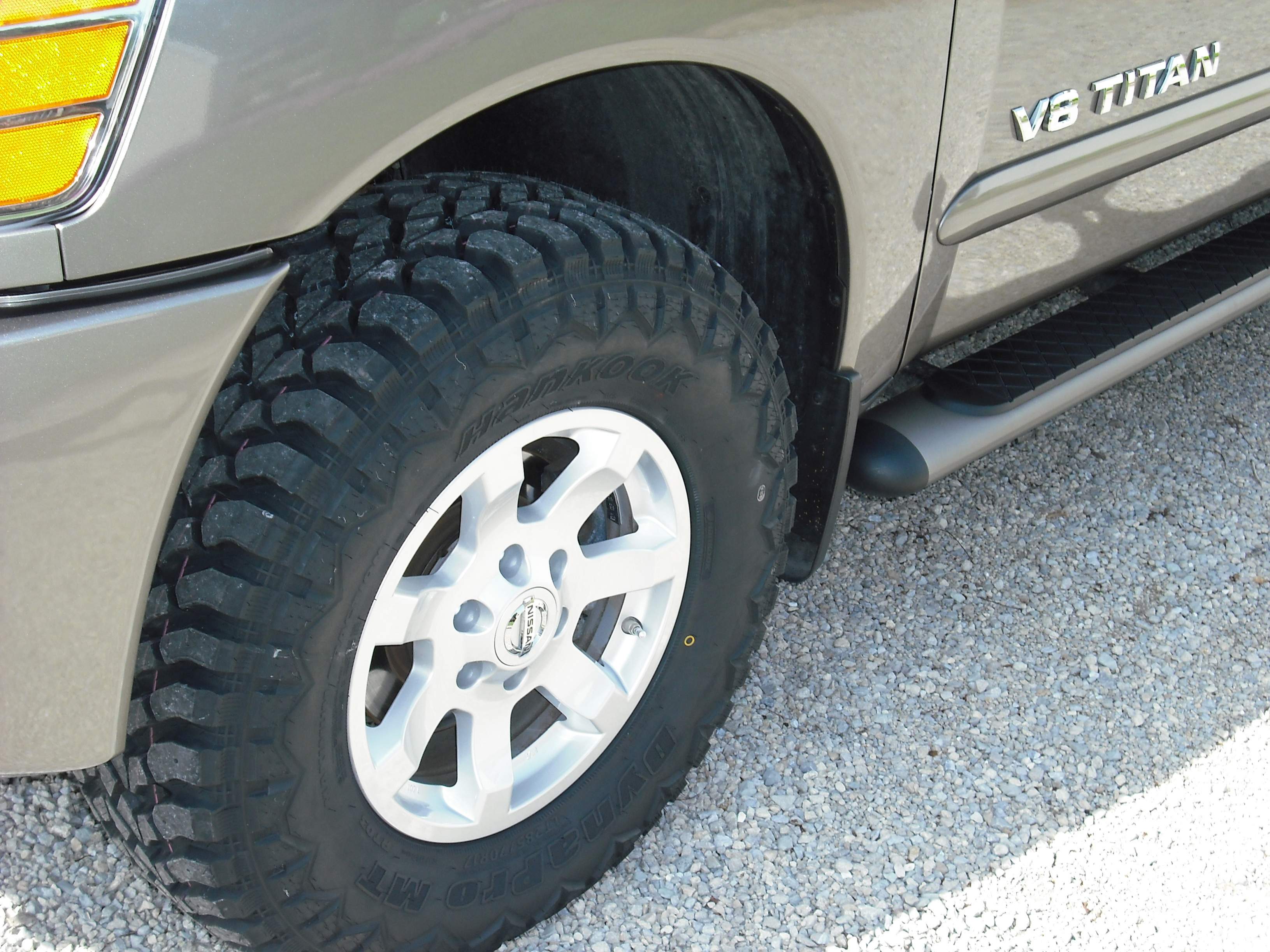

I give my nod to the Nitto and Coopers. Not sure if they make them in your size but I love the Hankook MT's that came on my new Nissan Titan. I run the Nitto on my F-350.

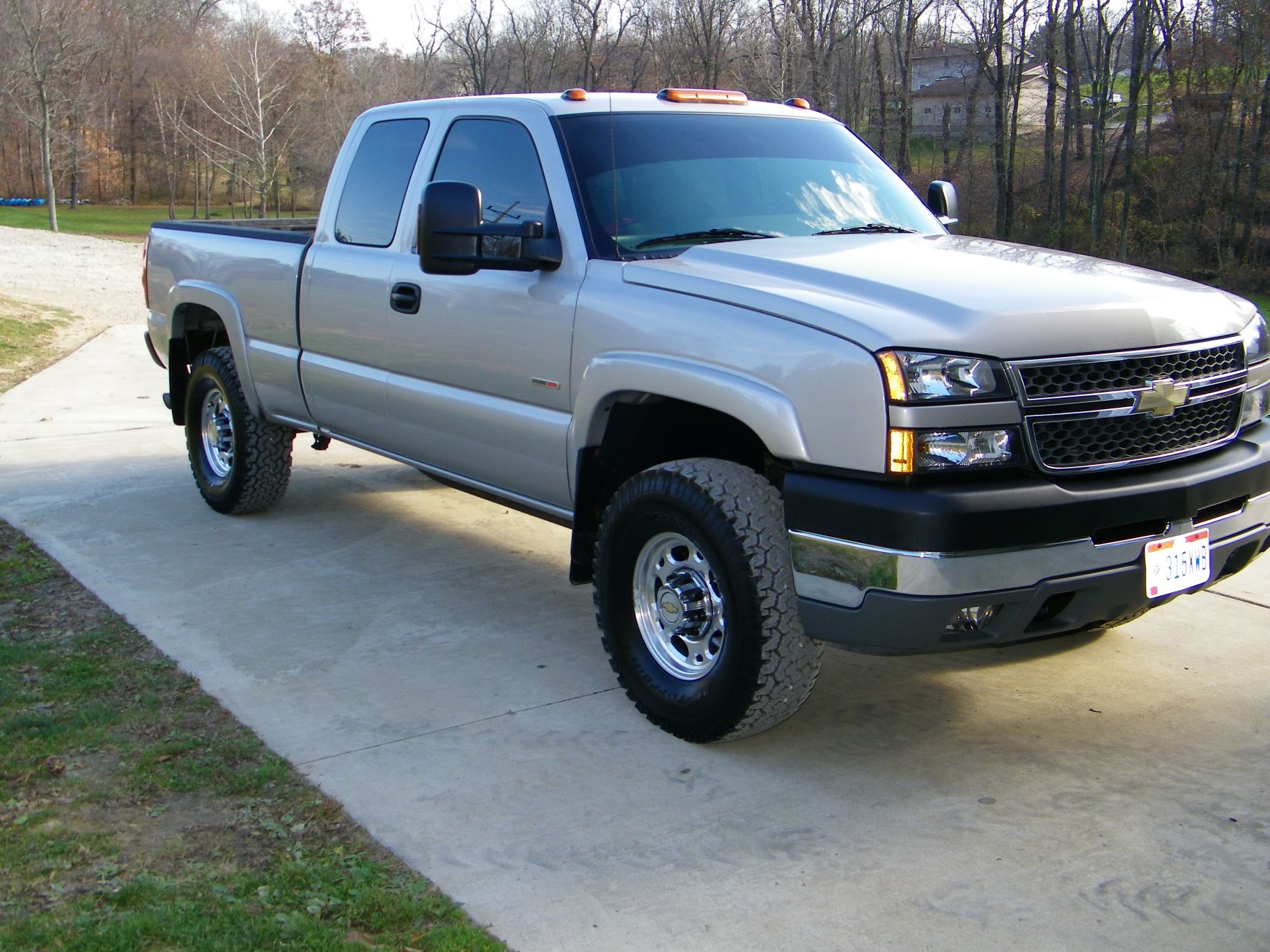

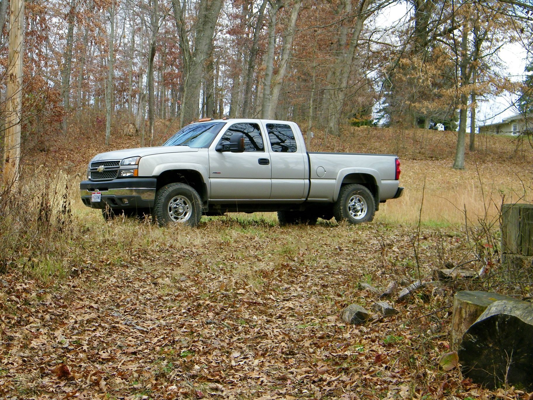

I would upsize and go with the BFGoodrich All Terrain T/A's. This is my second and I'll be honest I'm not easy on tires either! These pics are from a couple of weeks ago when I got the new ones. I went from a 265-75-16 to a 285-75-16. In my opinion, the best truck tire there is.
