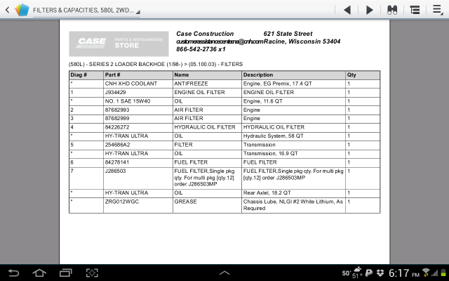

just picke dup one.
got manuals on order.
would like to service and top off some oils ... what's her trans take?
thanks
   / what trans oil for a case 580 L? #2
Pretty much a good grade trans/hydraulic oil. Here is the capacity and filter list:
many thanks.
I can get servicing it now.
