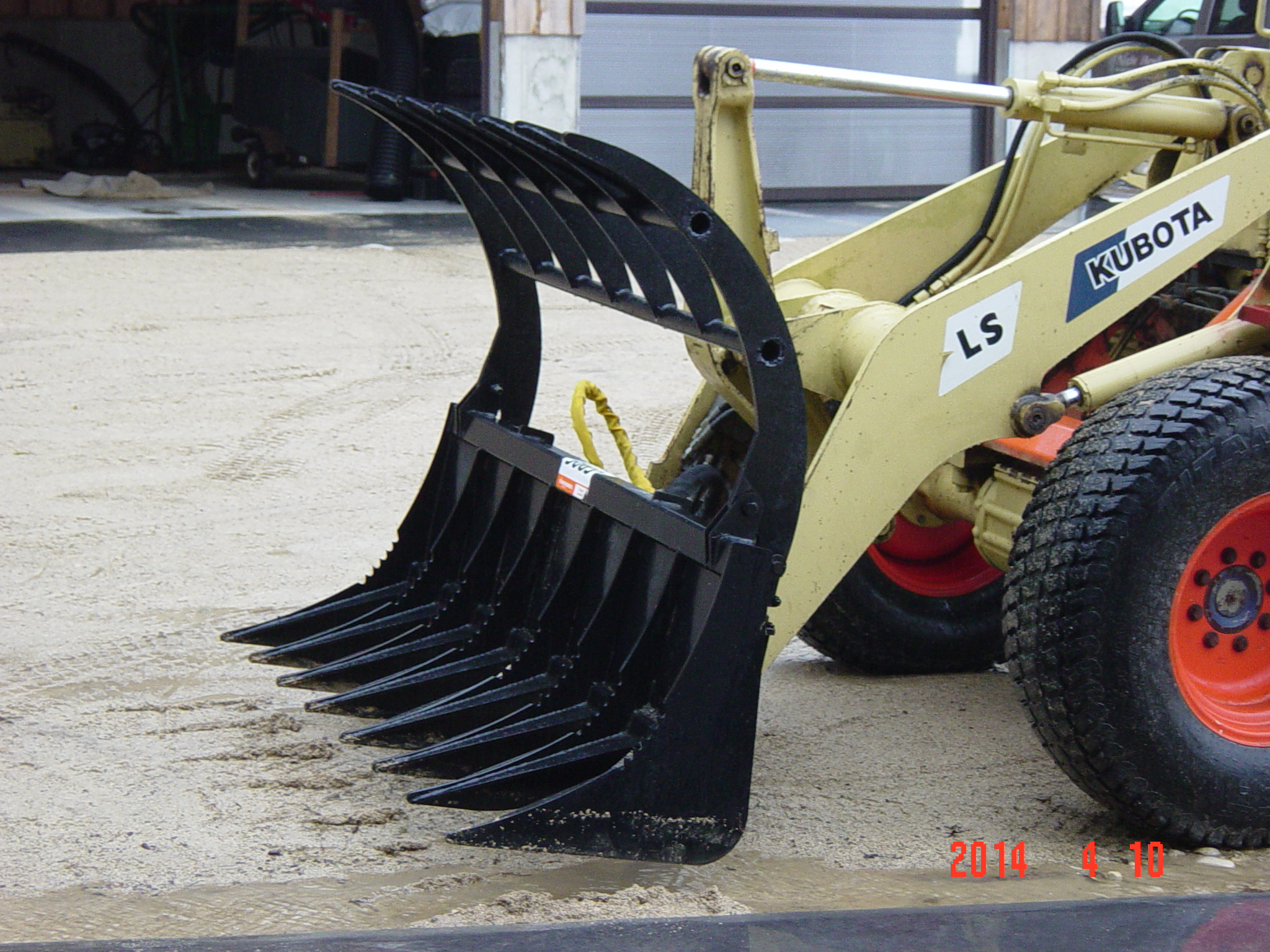

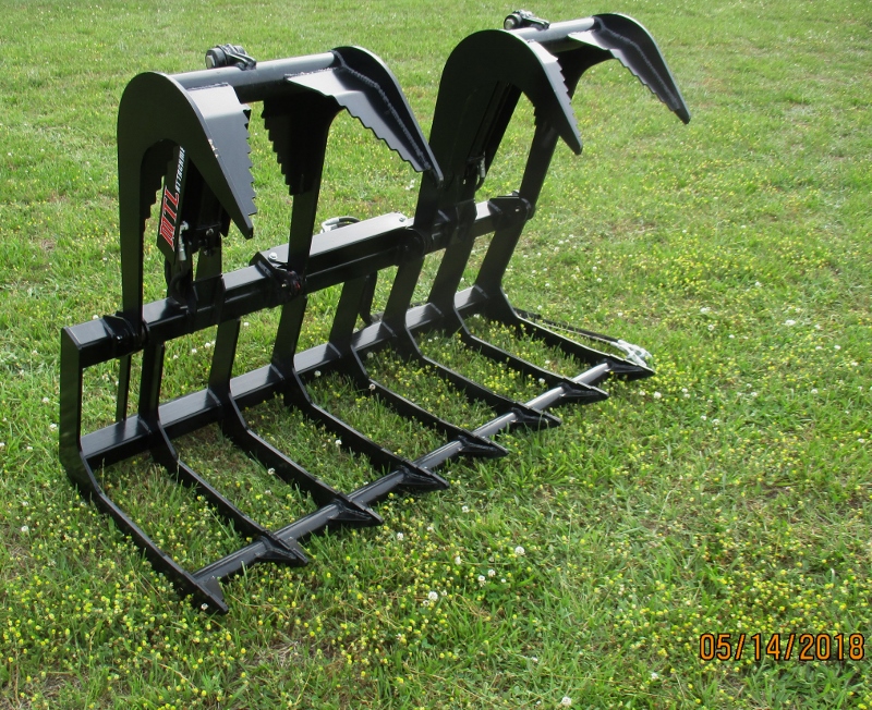

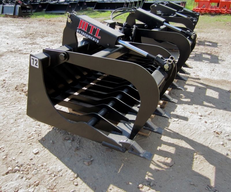

First - solid bottom or tines? - my dealer suggests going with a 'bucket' style bottom on it (not tines) so I could use the bucket also - this one. he says that this is what he has on his loader (for a skidsteer), and they work very well. I see most of the guys on here with tines, not buckets.
Second - short or long bottom? I see some guys that have the 'long' tines on the bottom, making a long "L" that functions a lot like a scoop with a lid. Then I see other guys that have very 'short' tines on the bottom, making it more like a clamshell.
Third - how wide? I was planning on going with a 48-60 inch, but my dealer suggested the 'same size as my normal daily bucket' (i.e. 72 inch) so i would be used to the footprint size of it. I think they 72 inch may be overkill, but figured I'd ask.
Finally - how 'hefty'? I believe I don't need a super heavy grapple for my size tractor and my needs. I don't want something wherein the tines will fold/bend, but I also don't need something over-engineered for a 75-150HP tractor that will weigh my tractor down without providing additional benefit. Lighter is always better, if everything else were equal...but everything else ISN'T equal, so often we trade weight for strength. How should I be thinking about this?

You have a loader with a 800 lb capacity. (assuming the LA351 is the capacity in kg like other Kubotas). That grapple the dealer's recommending looks heavy. Like it might weigh close to that. Not going to leave much for actually picking up stuff.
I got a grapple with long lower tines. I use it for picking up logs and firewood rounds and wanted the ability to stack more in the grapple. I also use it for piling cut brush and the longer tines can grab more. It's not that useful for pulling up my brush (because of the brush not the grapple) but I have been able to pull poison oak out of trees with it. The long lower tines on my 60" require greater turning clearance than the 67" bucket. I could have gone narrower to compensate but wanted the area for rounds.

ps- I have a long tined L style grapple and am very happy with it, If grubbing roots was my #1 use then i would choose the short lower tine style

I bought this no name economy grapple new off Craigs list. I guess the guy bought it down in the US at a Richie Auction.
No grapple does all things.
Junky as it is, I have not managed to break or bend it. That surprised me.
I like the configuration, except it won't handle very large piles or single small logs well.
WITHOUT A DOUBT, I would go with a double lid if getting another. IT would just clamp irregular logs and material better.
I see little advantage in going too wide with a grapple. Narrow might actually be better.

My opinions only:
1) A grapple on a bucket is useless. Nothing I have ever wanted to grapple fits in a bucket, and dirt doesn't need a grapple lid.
2) For brush or digging up roots, get a root rake. For firewood and trees get a L bottom grapple for the capacity.
3) Wider is not better. No way you want the same width as your bucket.
4) Get a grapple with greasable bushings.
5) $800 for the 3rd function installed is very good. At your level of skill and likely usage "true 3rd function" vs "diverter" doesn't matter. I only do one function at a time anyway.
