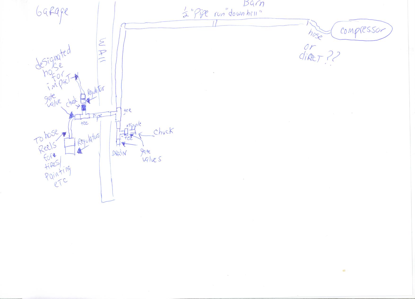

Ifinally got time off from work,and ive been to hd and bought some 1/2 pipe and fittings,and im gonna attempt a system.Id like to post photos along the way and get your input.
First question ,I noticed in KEVEN JS photos a short jumper hose between the compressor and first pipe.Im assuming that direct hookup of the iron isnt reccomended because of vibration? OR NOT?
Gonna try to draw a pic of my proposed system,scan it and show it stand by
ALAN

see if my scan pic works ,if so input please
ALAN

Pic came through, although it would have scanned better in black rather than blue, it is a bit tough to read. Yes, you want a flex between compressor and pipe due to vibration.
Did you ever try to hook up Impact Wrench directly to compressor rather than through all that tubing?

no i never tryed direct ,i think id need at least75 feet to have enough operating length.im trying to hard pipe everything ,having valves to close branches that im not using ,having drains,and a designated branch off the main just for the impact,with just a short operating hose.Ihad no tubing,it was all hose

Another way to improve wrench performance at the end of a long run of pipe/hose is to have a storage tank, say 20 gallons right at the beginning of your "impact only hose". Any stored volume of air is a plus, and the closer to the gun the better.
Sean
