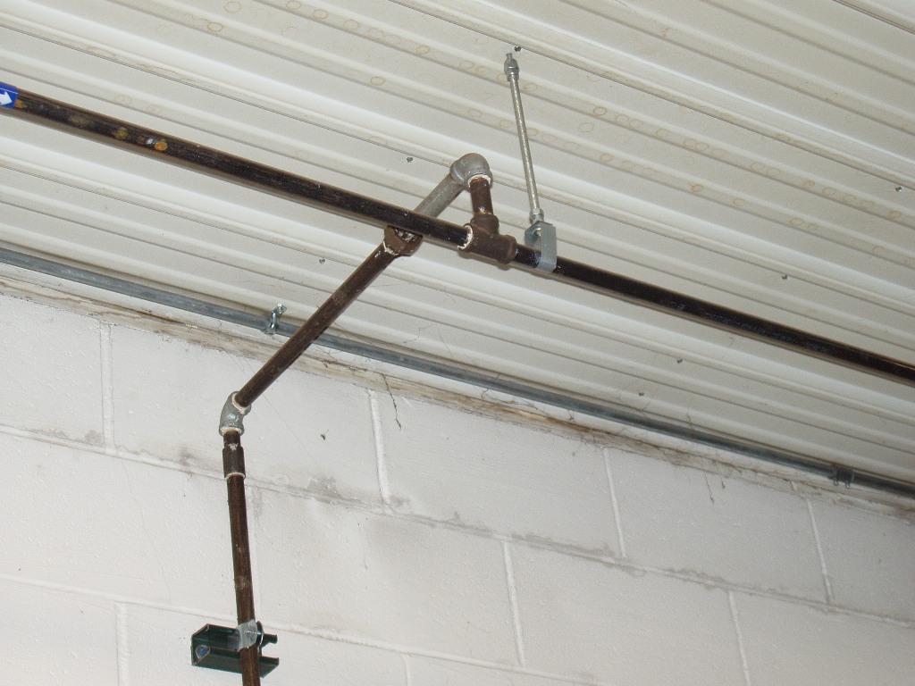

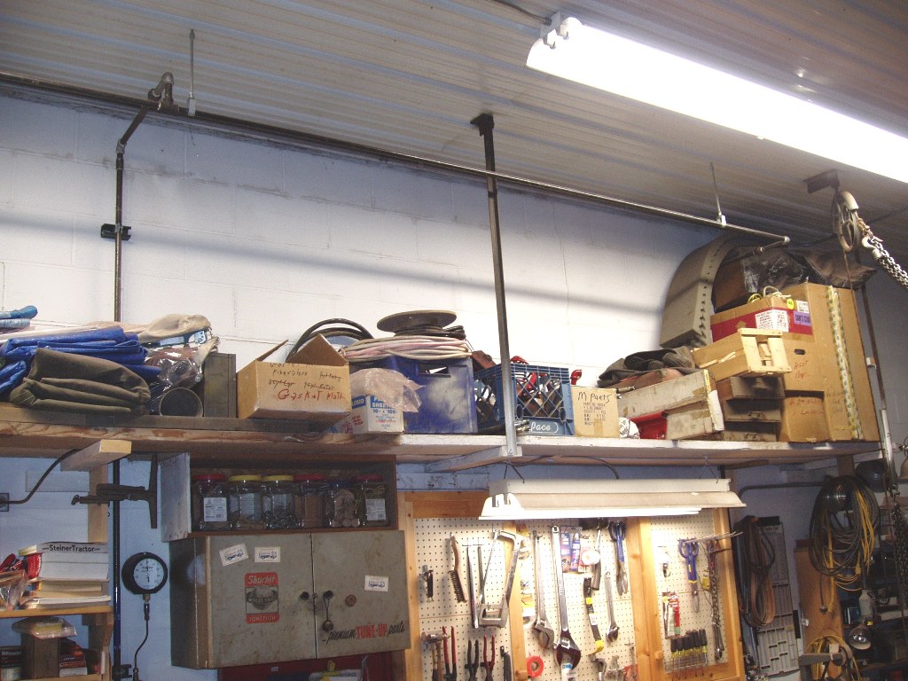

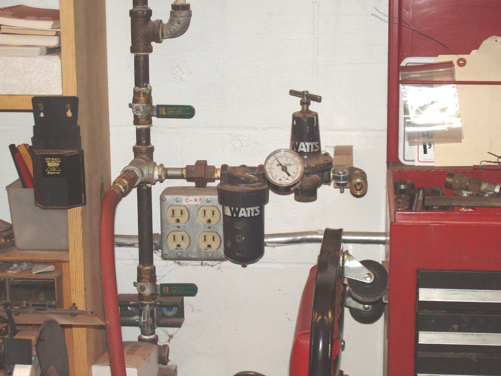

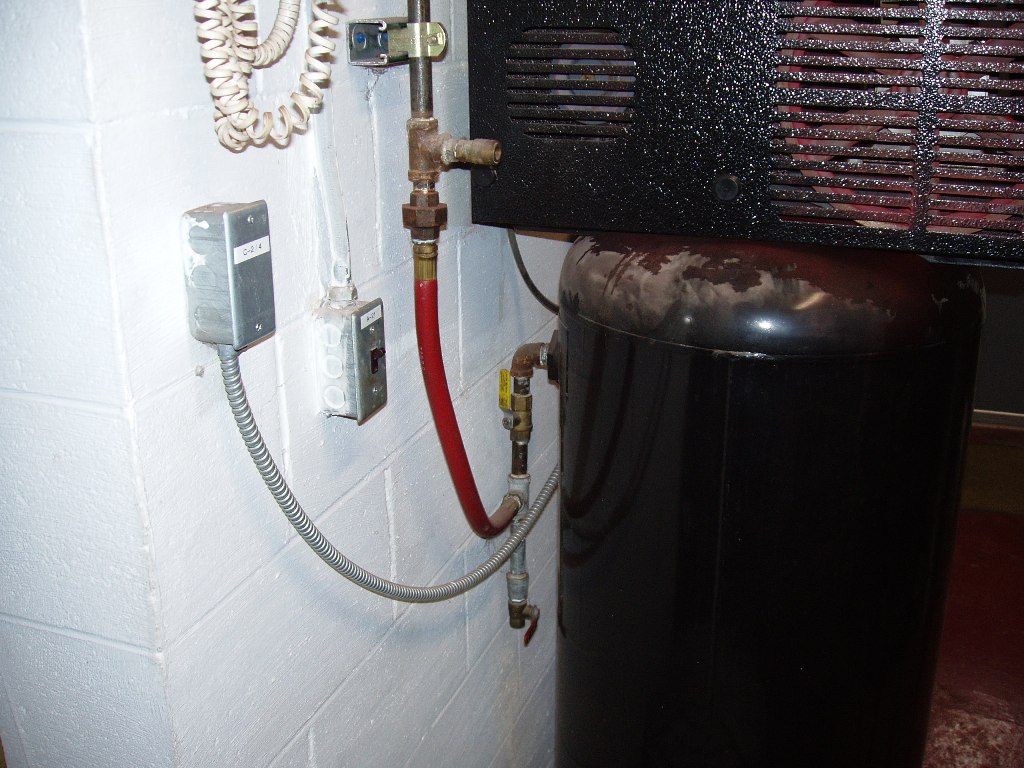

I have good pressure at the chuck id have to look but i think its 120-130 or so.Ihave no other problems with my other air tools [framing nailer,grinders drills etc.Yes i know i have different settings on the guns.More than glad to take pics of my setup if you really think i might have issues.I m heading out to putter in the garage in a bit ill take the camera

The length of air hose shouldn't hurt you, 3/8" diameter is the smallest I would use though. If you read your (if you still have it) manual for your compressor they tell you it's much better to run long lengths of air line over electrical lines and having the compressor close to your work. A simple check would be to put an air gauge on your impact wrench and see how much the pressure drops as you try to remove a stubborn bolt.
A bad regulator will cause you issues as it will let full pressure down the line until you go to use air. Then it will not open up to allow the flow needed to supply the air needed for tools. I would suggest a regulator that has 1/2" threads for fittings. They are larger and will allow more air to flow through them.
