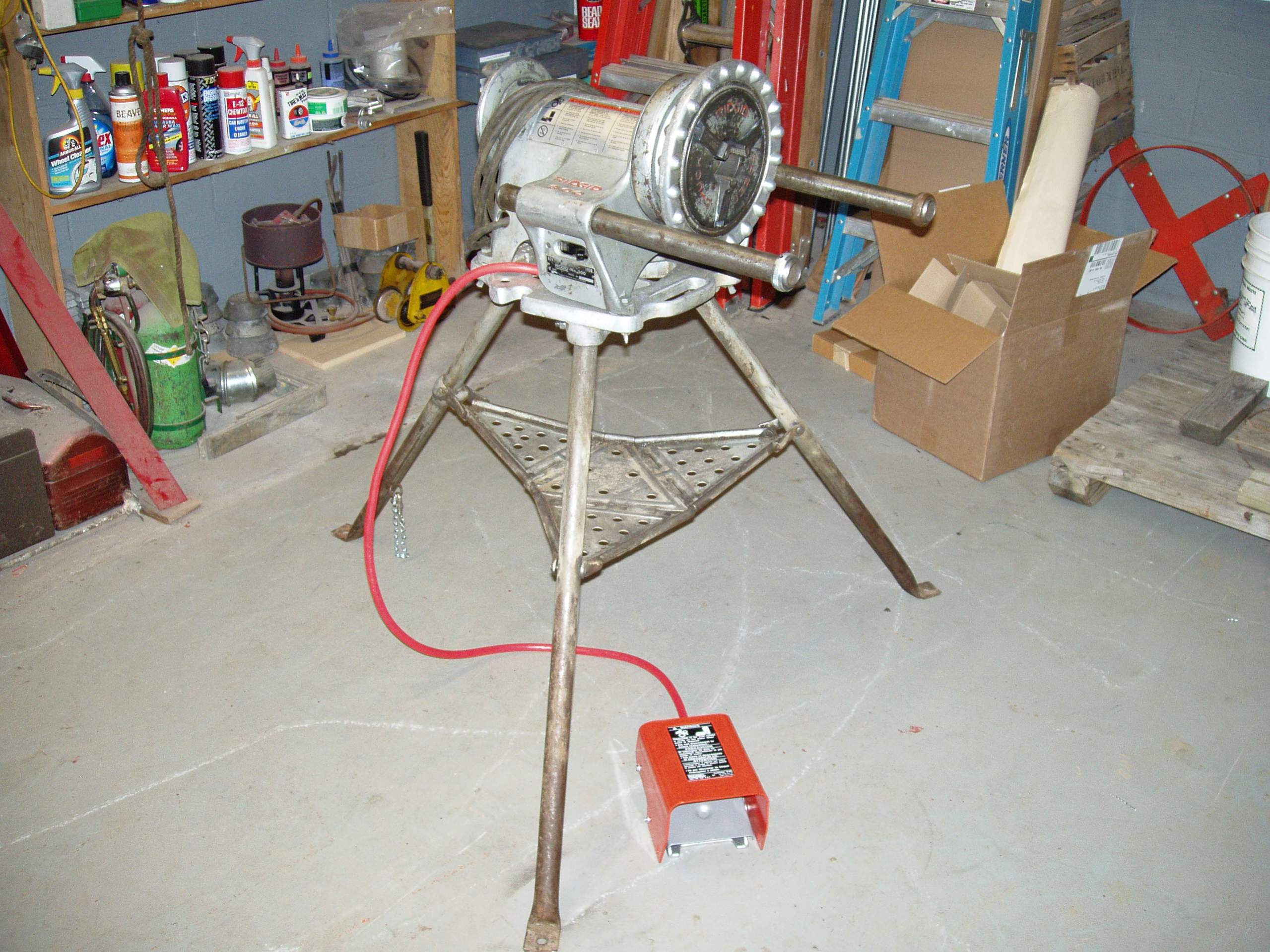

Let me ask you guys this ,ill put this togeather with fittings when possible,but when i need a short peice WHY CANT I WELD IT TOGEATHER WITH MY MIG to save fitting and or threading costs? If i need an elbow ,why cant i heat it up with my rosebud and bend it?Less chance for leaks ,better flow etc im thinking.
One thing i noticed at HD looking at hose,the biggest they had was 3/8,THEY DIDNT EVEN HAVE A SPOT FOR 1/2
alan
They make short pieces up to 12" called nipples. No need to weld.
Also find a plumbing supply house and get 20' lengths for you long runs, saves fittings.
Also check a rental store for a pipe vise and power threader rental.
You can pipe a small shop in a day.
That is what I did with my gas piping project. besides the 20 foot sections are cheaper per foot than the box store 10 foot sections.
I didn't think about the rental, good idea.

I have all the threading gear for everything from 1/4" up to 2". Don't use it much any more though.
