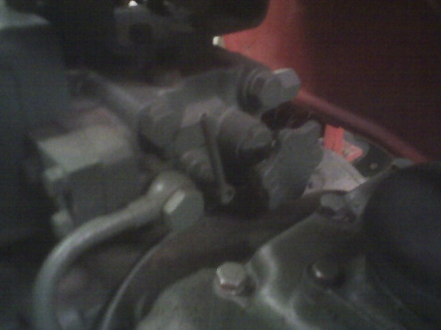

What\'s the Knob For?
I have a YM2000 and there is a round knob directly under the seat. It seems to have something to do with the hydraulics. I have no idea what it does. It is pretty obvious that the previos owner never used this knob for anything because it is impossible to turn.
Any ideas what this knob does??? Thanks
   / What's the Knob For? #2
Re: What\'s the Knob For?
Hi scesnick, does it look something like the attached picture? I think the knob is to lock the 3PH in th up position. Turn CCW to unlock. My 2210 (picture attached) has one, but I have never needed to use it. The other lever is to adjust the fall rate of the 3PH.

   / What's the Knob For? #3
Another picture ...
Nevermind, now i see it. YES... that is the knob I'm talking about. What the heck is it for????
   / What's the Knob For? #6
I've never messed with mine but I have read other posts that indicate that turning it clockwise will lock the 3PH. Not sure why (or when) that would come in handy /forums/images/graemlins/confused.gif but now you know what it does /forums/images/graemlins/smile.gif
   / What's the Knob For? #7
</font><font color="blue" class="small">( I've never messed with mine but I have read other posts that indicate that turning it clockwise will lock the 3PH. Not sure why (or when) that would come in handy /forums/images/graemlins/confused.gif but now you know what it does /forums/images/graemlins/smile.gif )</font>
Very handy when operating your tractor and implement while driving on roads. Implement will stay in place even if you accidently bump your draft control. It is also an excellent deterent for a theif who may attempt to steal your tractor or implement...If it's locked down NOTHING will move - even hot wired tractors pretty much stay put.

My manual says to use that knob wheneve you work on your implement. Though I wouldnt trust it completely by getting under an implement anyhow, its a good saftey feature(in theory).

The knob may be turned a little to slow down movement of the the three point if you want to do fine adjustment without it hoping around. It may also be tightened to keep the implement fixed in position.
Some leak down is normal. I would expect leakdown over night.
