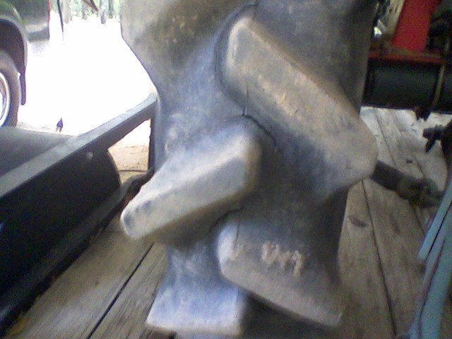

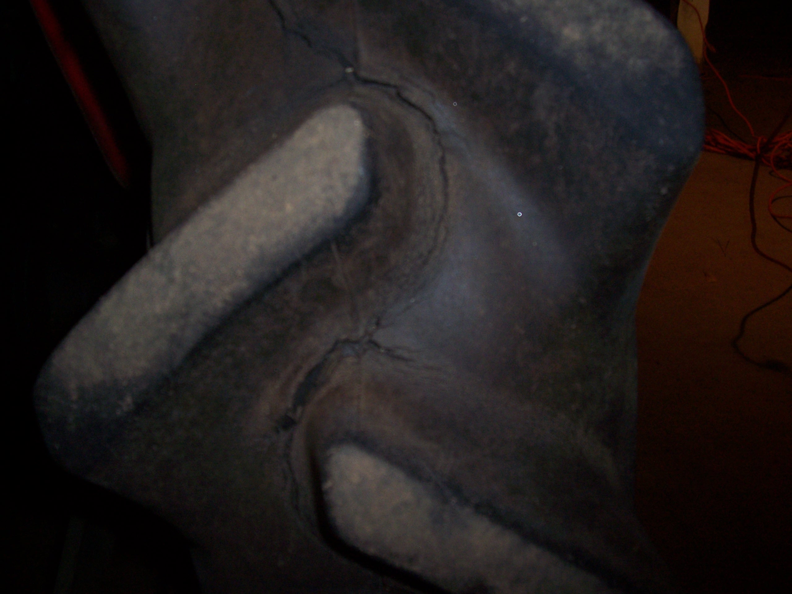

Curious to what is all wrong with the ones you have now. Dry Rotted no tread etc. The reason I asked is I used a tire reliner. Works like champ and Cheap. I had splitting at the lugs from dry rot. You could see the Inner Tube!! Easy to install and now my Org. rears with are good to go for Yrs....
I think he wants turfs for better ground contact for plowing snow in the winter.
   / Wheels for YM155D #9
If that is the case then reline them and fill them with foam. The extra weight would make a big difference and again Cheap. Depending on the tire condition. Just putting out there all his options until he can find something..
