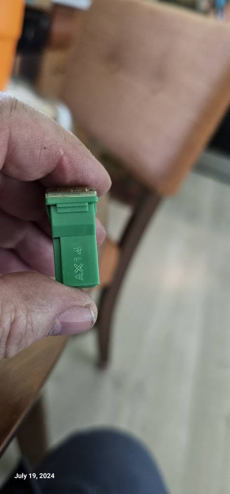

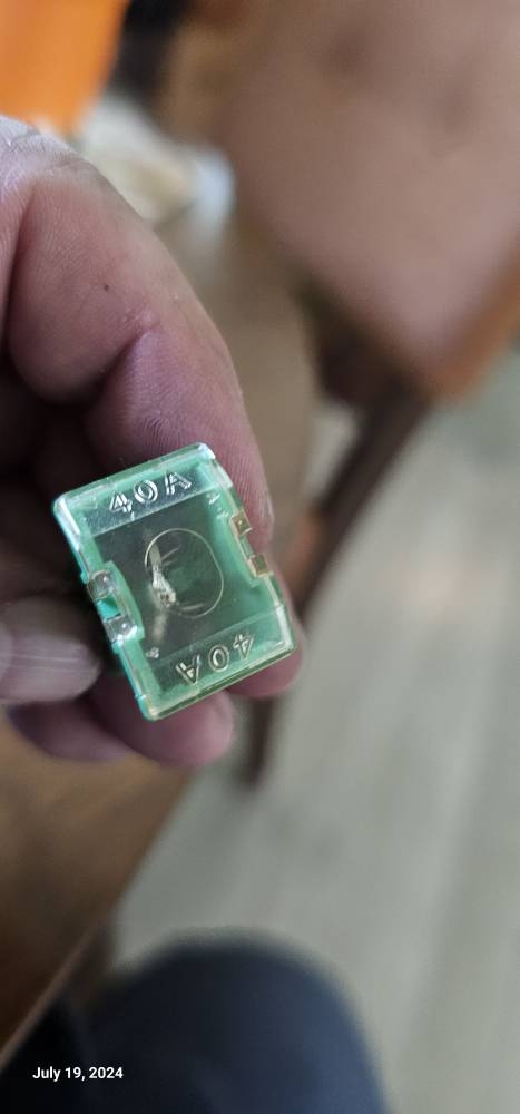

Where can I get these 40 amp fuses?
   / Where can I get these 40 amp fuses? #2
   / Where can I get these 40 amp fuses? #4

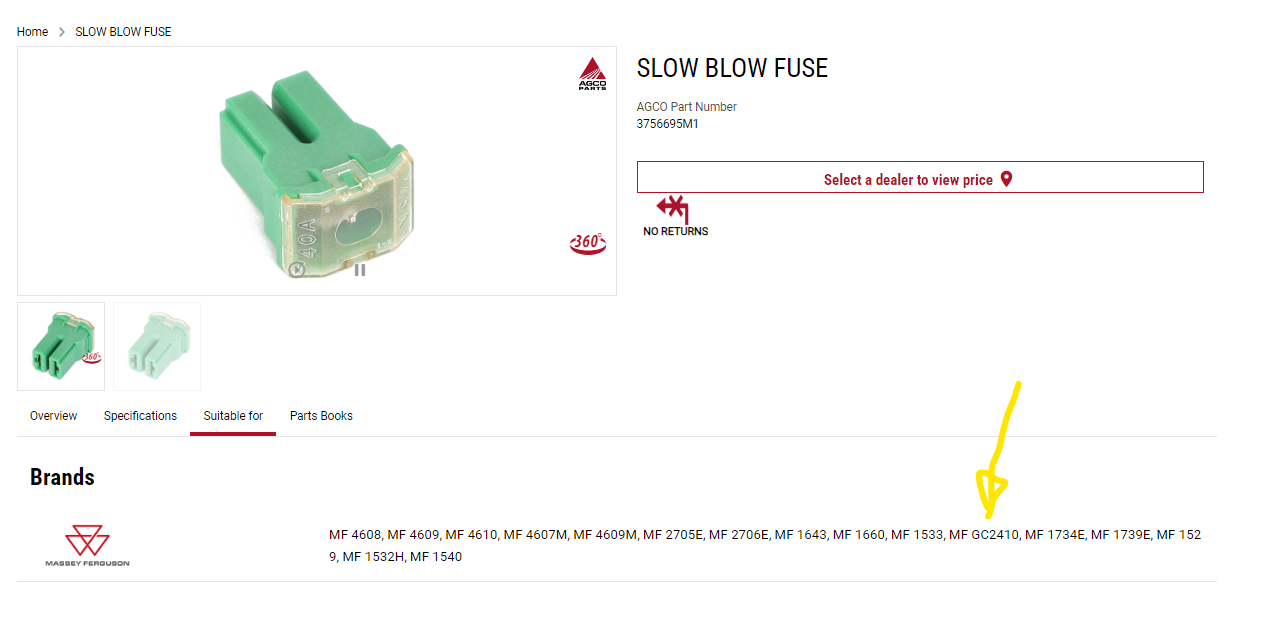

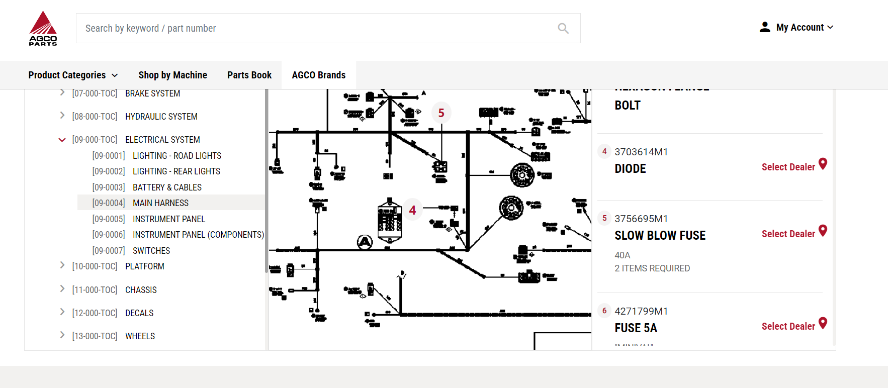

Using your model and going to the AGCO website I'd say #5 are the 40A fuses you are looking for but please do the search yourself to be sure.
https://parts.agcocorp.com/us/en/ap...0+/+GC2410+/+GC2600+/+GC2610+COMPACT+TRACTOR#
I'm guessing you can only get them from a dealer??

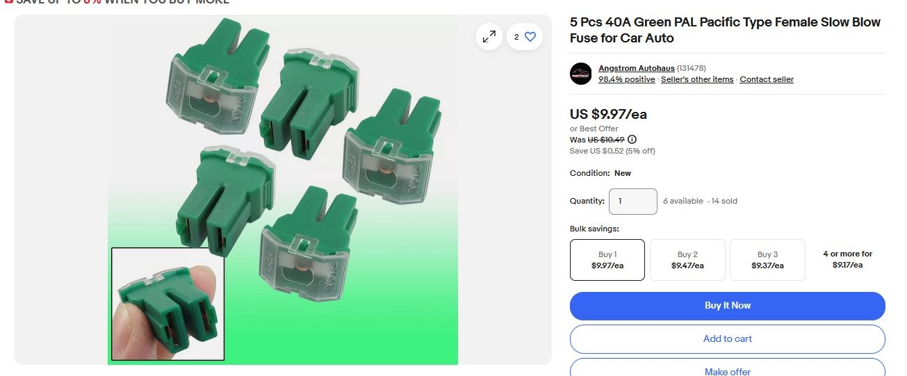

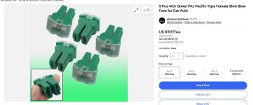

It looks like a standard automotive PAL fuse. Ebay has a listing but any good local auto parts store should either have them or be able to source it in the slow-blow configuration.
