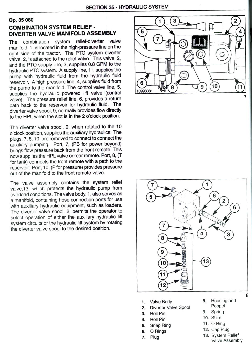

Power beyond is whatever pipe from the loader valve that hooks to the port marked #7 on the diverter as shown below. This would be be the best place to insert your 3rd function valve. Read the text for a full understanding of the diverter and its operation.
   / Where is the Power beyond port on a TC loader valve?
Jim,
Thanks for that diagram.
I actually installed the valve this weekend and I did use that port. I don't have anything to hook to it yet to test it. Still trying to decide which attachment to buy. Either a Danuser EP6 auger or a root grapple?

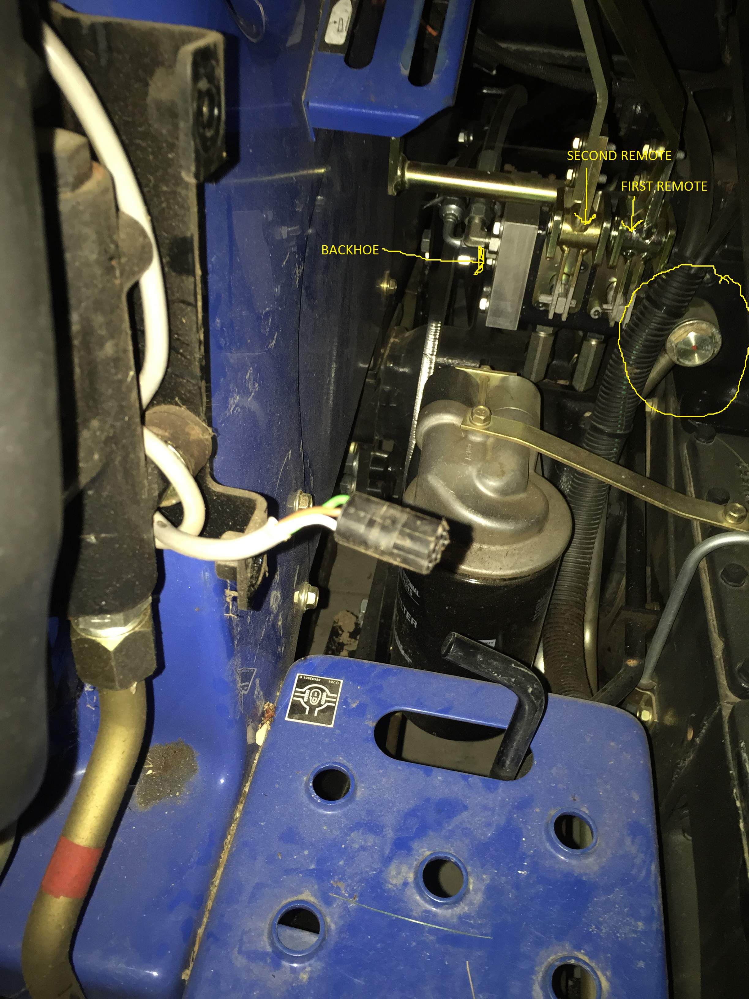

In the picture is this the hardline that you removed to hook up your 3rd function valve?
Mine was under the brake pedals and there was already a rubber hose with a quick connect in place. The previous owner had a backhoe. So they did most of the hard work.
