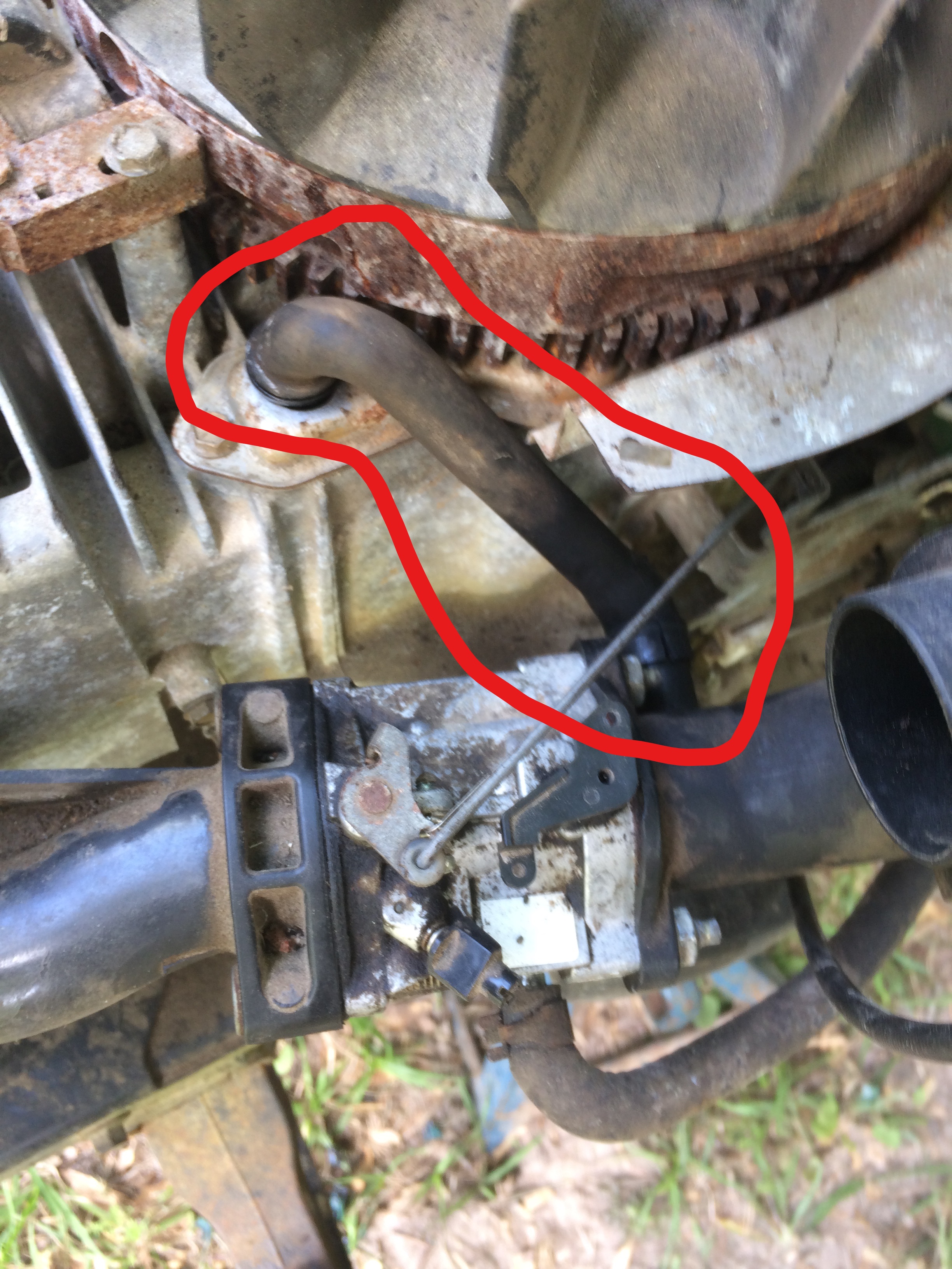

Having trouble finding the John Deere LA125 part in the attached photo. Anyone have a link to a source to purchase? I'm unsure of the part name.

it's a PCV hose, (positive crankcase ventilation) the carburetor sucks in the gases from the crankcase, and re-burns them.(you always have some blow-by). what is your Country??..

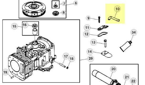

You can order John Deere parts online as well as look at all the parts diagrams. That would be my starting point. The parts diagram will give you the part number and then you can purchase it online.

Vent Tube (Breather). I found one online with some help from the guys over at ar15.com.

I found it in JD Parts.
Part Number: MIU11682
Part Price: 5.45 USD
