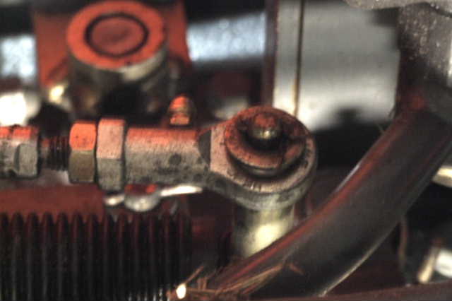

Any CK25/30HST owners recognize the location of the grease fitting pictured?
(This is a test, only a test.) /forums/images/graemlins/smirk.gif

I don't own, nor have I ever even sat on one, but I'll guess anyway just for fun. Is it part of the steering linkage?

Now....part of a test is following directions....you're not a CK25/30 owner. ....don't take me serious, I am just kidding with you!
However, your guess is incorrect.

I know the exact location of that fitting.
It is on the linkage that tells the HST drive to go forward or aft. Just below the HST treddle under the floorboard above and to center of the FEL hydraulic block.
