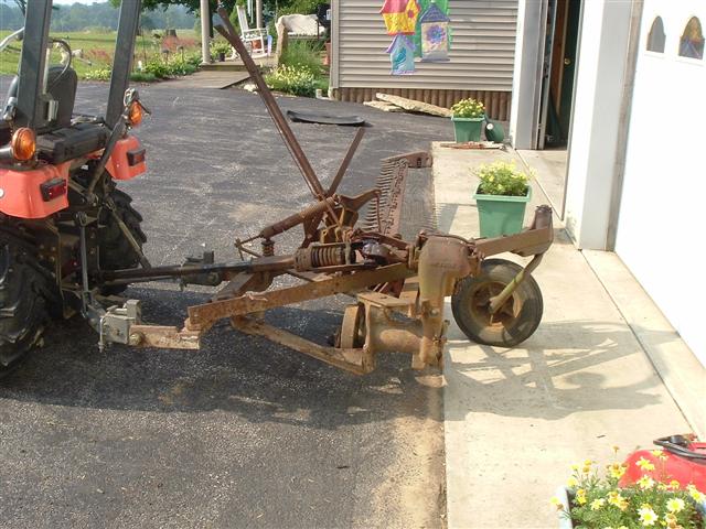

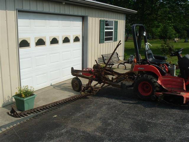

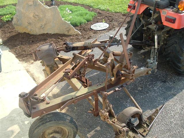

   / Which sickle for a BX2230? #19
I have an old JD #5 that I have adapted to the BX2200, had to lengthen the PTO, but that was easy since it is just a square shaft. I haven't used it on any steep hills, just along the right of way and around some fences. With the wheel on the back, it's not a problem to back up and all my mowing is at a slow pace. If I were to use it around the pond bank, I think I would want the sickle on the uphill side.
