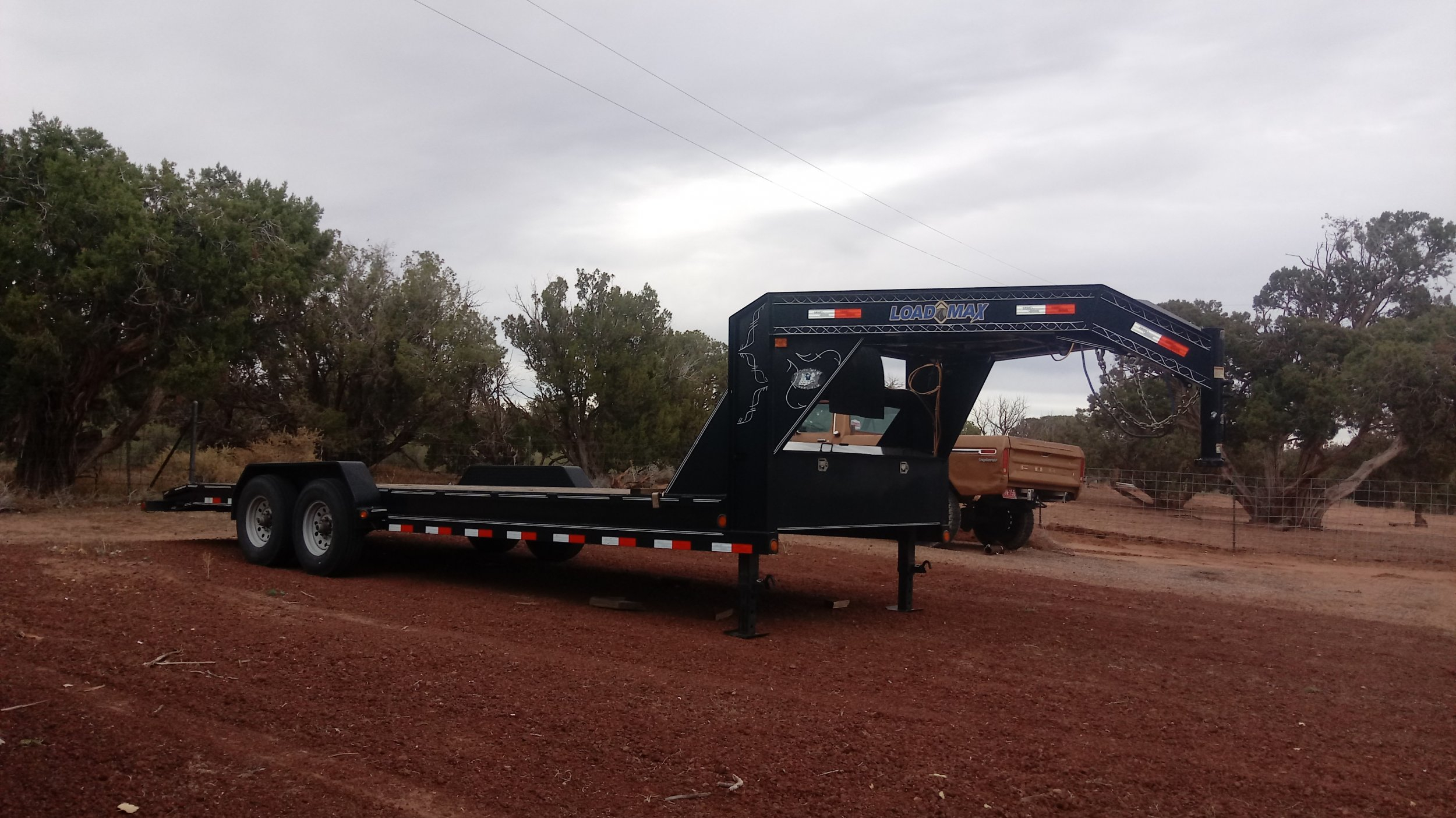

Lamar is a quality trailer. 16" centered crossmembers are standard with 12" as an option. Some of the economy trailers go as wide as 24". Just so you can see some paint as it ages some, here are some pictures. The Lamar was built in 2-18, the Load Max (same as Load Trail) 5-16. Both powder coat.
