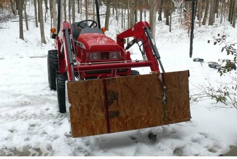

The pic below belongs to AlpoCat
Highjacked from Snow Weapons Page 62.
