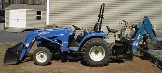

Here is a pic of the tractor with FEL and hoe attached. TC33D, 7308, BH 762H, R4 tires.

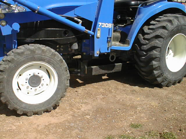

This is a pic of the "drivers side". The black bar under the tiedown loop is part of the sub-frame.

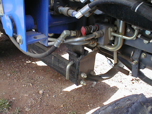

This is a close-up picture of the "passenger side" front sub-frame attachment and is near the FEL bracket and hydraulic dist block.
Those bent plates and front cross-member are about 3/8" thick. The front down brackets are about 1/2" thick.

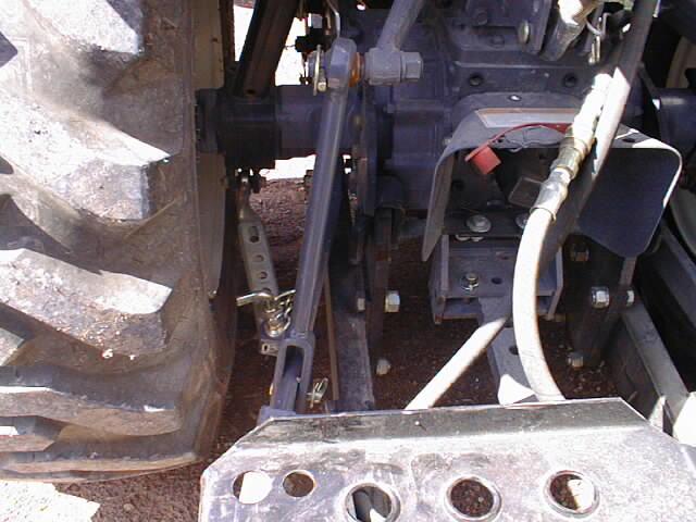

This pic is looking between the hoe and 3PH. The shiny bolts next to the drawbar are on the brackets holding the sub-frame to the axle. As I said previously, those thick brackets have hooks on them to engage the other brackets that are bolted to the axle. Make for easy on/off. Note that NO 3PH parts are used. Indeed on mine, the hydraulic power to the 3PH is deactivate to prevent using the 3PH while the hoe is attached.

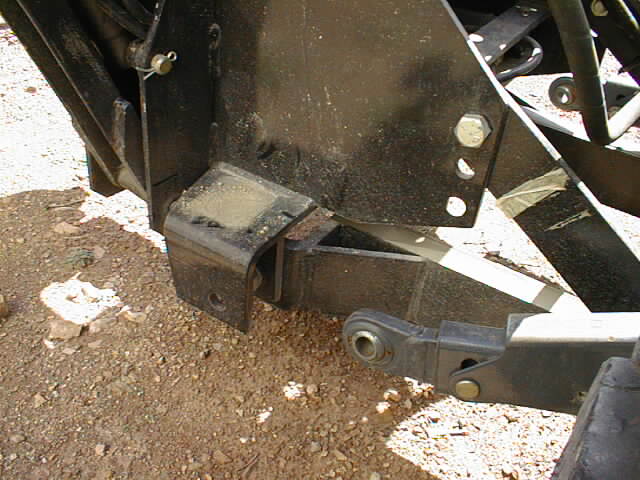

This is a pic of the sub-frame attachment to the hoe. Note the end of the 3PH arm. If there were no sub-frame, the hoe would be about 6-8 inched closer to the back of the tractor. Again all pretty beefy steel 3/8" inch plus gusseting and bracing. I think you would agree, you probably couldn't make it easily or quickly. Much easier to buy one and get to work using the tractor!
